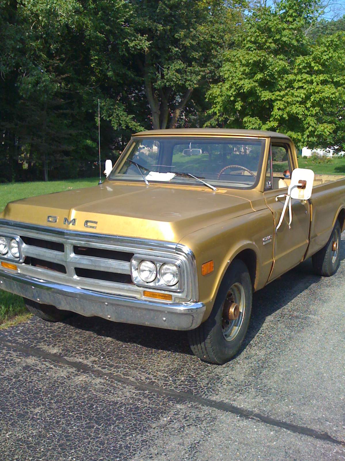

If any manufacturer offered a pickup truck that was:
good heavy truck
an engine with some grunt
no carpet
no power locks or windows
sheet metal thick enough that it doesn't bend when you lean on it
a manual transmission with a granny gear
a rear end made for pulling not for gas mileage
*that cost less than I paid for my first house* (and I'm not that old)
I would be at the dealership first thing in the morning to buy one
and I would gladly pay extra for the heater and am/fm radio:D
I bought this one last year, runs great. You'll need a time machine to buy new though.:laughing:
