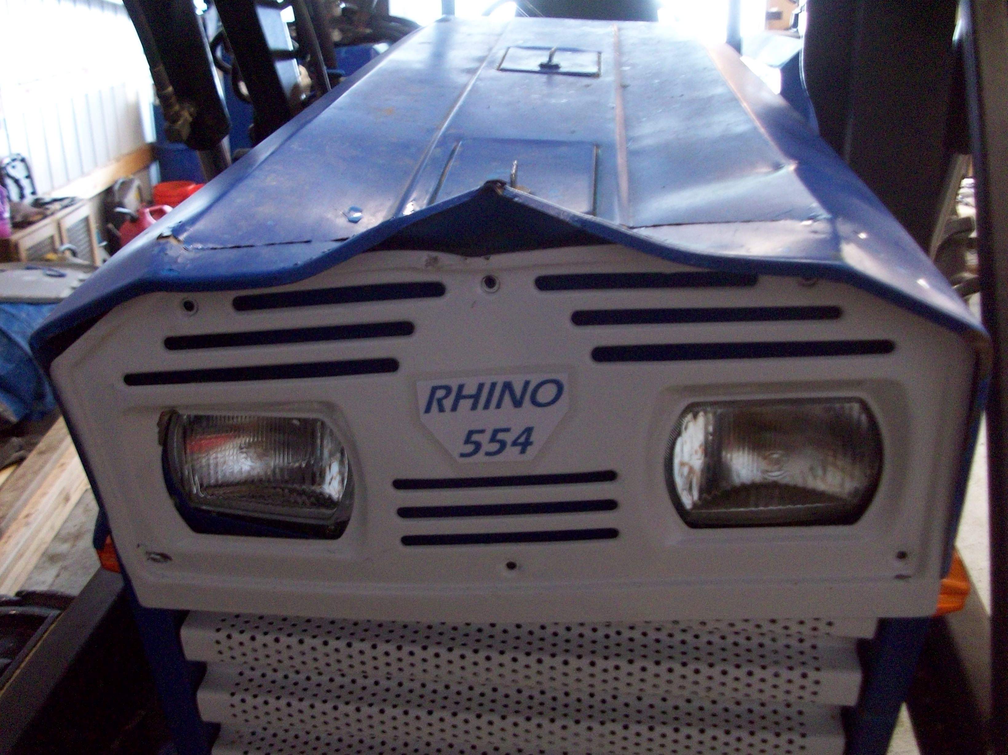

Here's an update on the body work progress-this a different view after the damage, the home made View attachment 305875Rhino label jinxed me I think

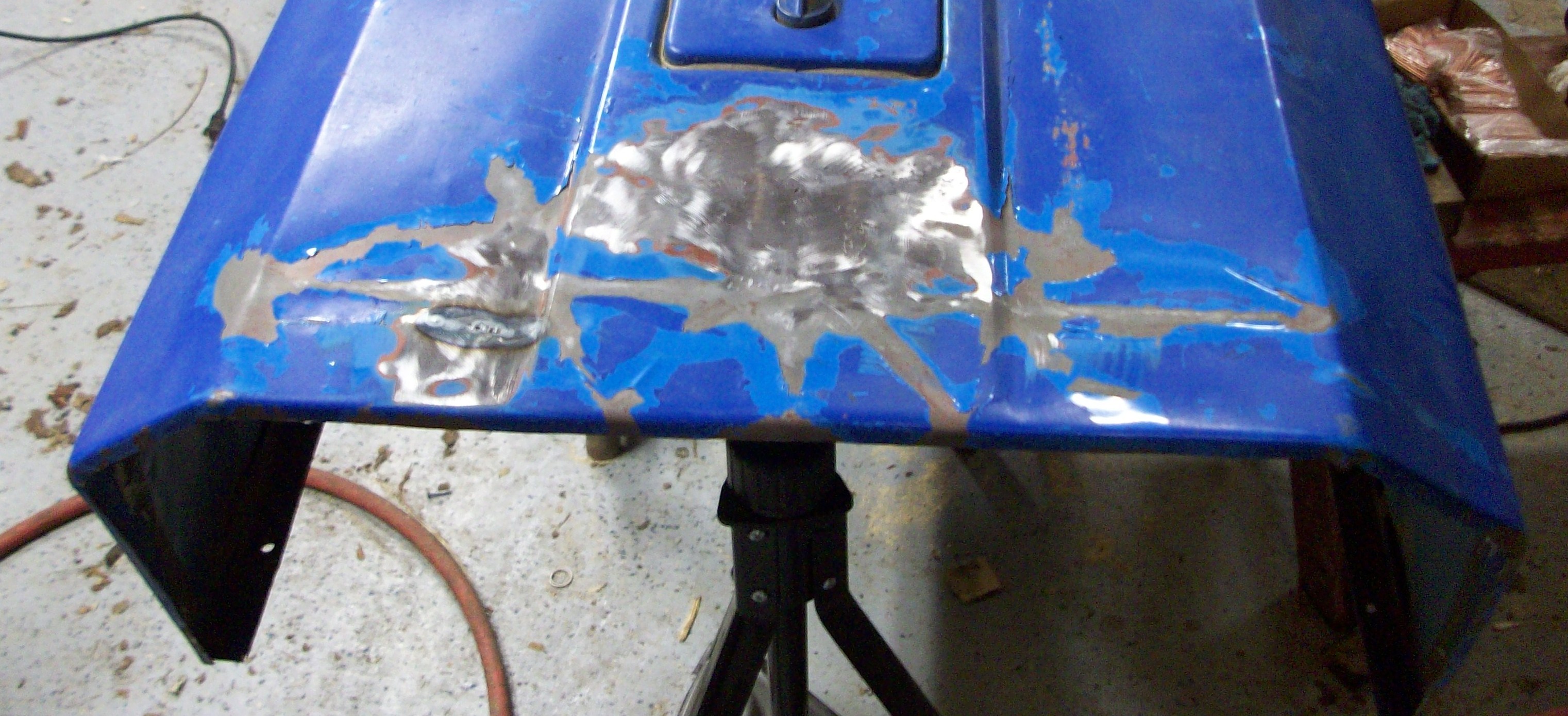

the hood so far-the metal was stretched so bad that hammer dolly/torch- wet towel wasn't enough. Finally used a 3" cut off tool then pressed it on the log splitter then mig welded and ground it down. anyway here's how it looks so far , Thanks for the input, and you guys are right on the mark there's definitely bondo or Short strand fiberglass in its futureView attachment 305878
That looks like its going along great

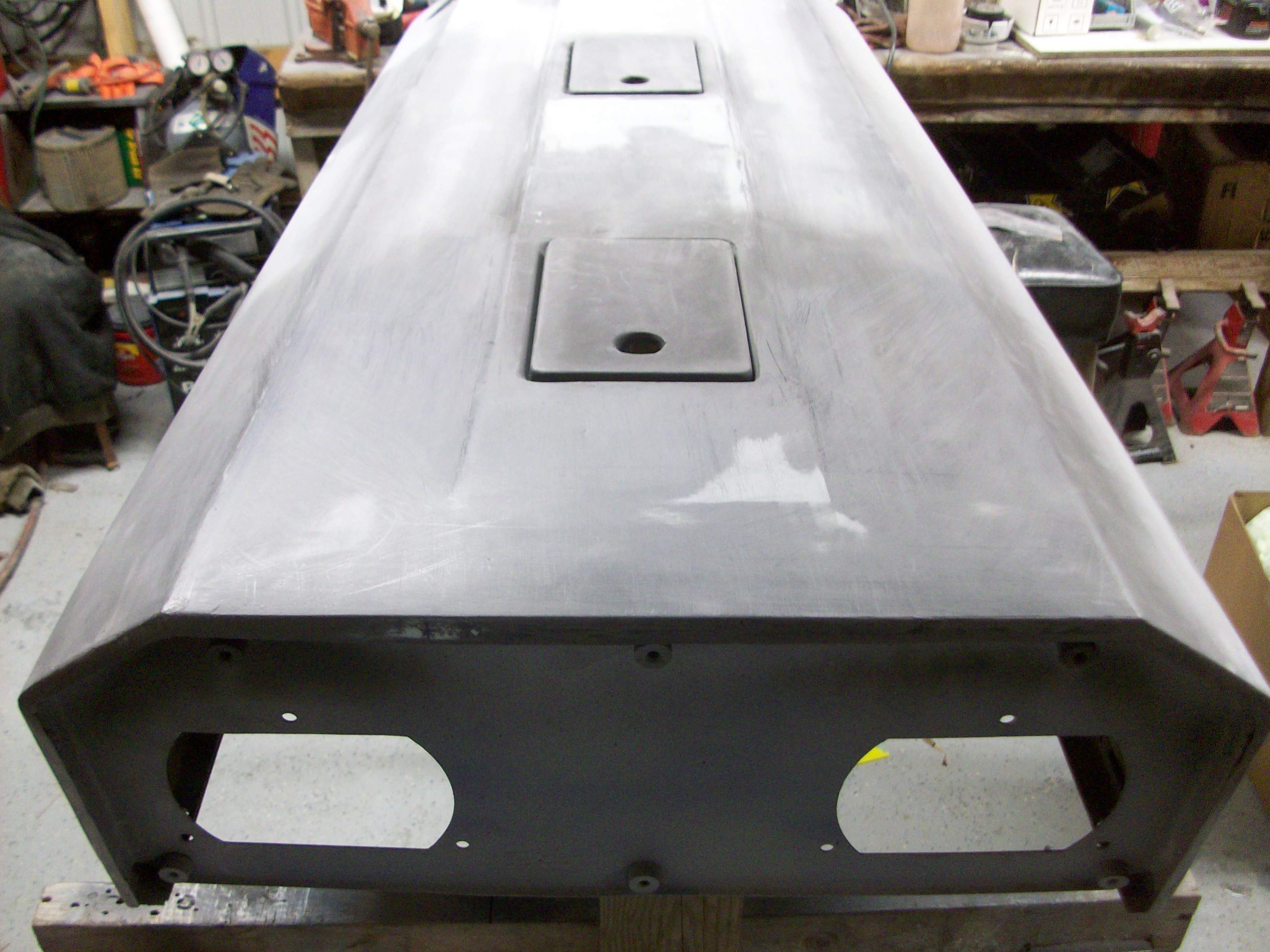

Thanks- still working on it when I can, here's the hood now Rhino hood body work 013.jpg getting closer...
   / Tractor related bonehead move of the month-I'll start #55
Wow, that looks great. Get the correct decals now to seal the deal.
I had considered that- but the decals are not available for these older Rhino International tractors, Farm Boys stocks and sells most every part to keep these (Shanghai) 554 tractors running, and I'm happy with that, So the decals have been taped off and hopefully everything will work out..

For acute dents, would adding a bit of hit from a torch help to bring the metal back into line while beating it back with body tools?
Heat on sheet metal is just going to warp it up. Best to cold straighten sheet metal. Structural members can be heated and beat if they are too strong to bend cold
