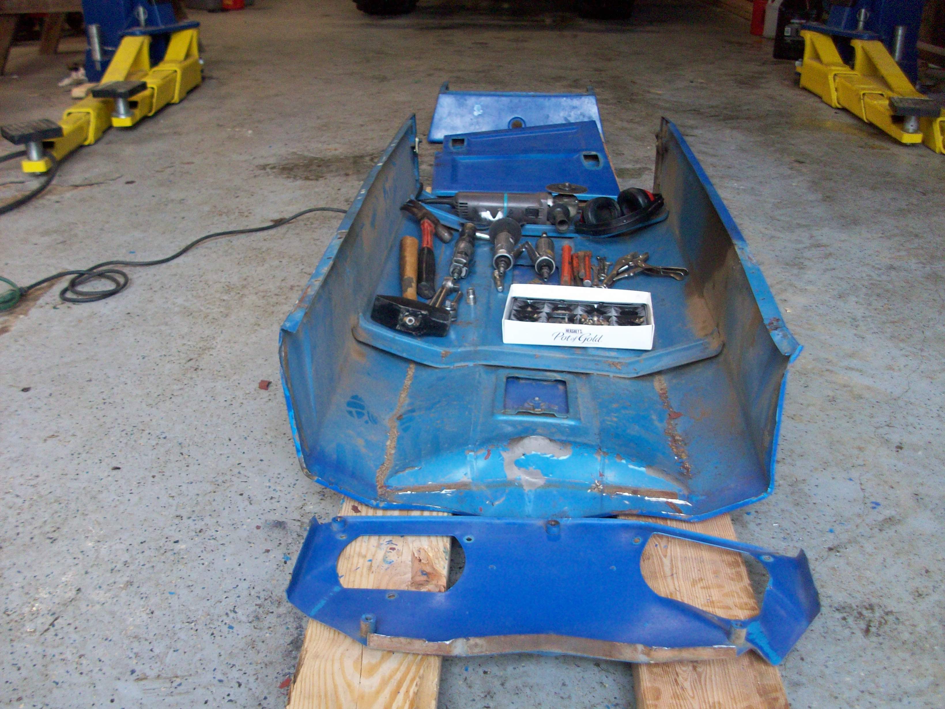

Harbor Freight sells a body/fender repair kit for cheap. Worked beautifully on my tractor hood, fenders, roof.
Search results for: 'body fender'
I have used these tools to repair a surprisingly similar dent. Take your time, do the bondo skim coat, repaint and re-decal and you'll feel better.
You can also watch online videos on how to use the body tools as well.

Well I feel a little better Knowing that I'm not the only one....Have removed the sheet metal and getting ready to look at trying to straighten the hood View attachment 305636 Here's the sheet metal ,couldn't stand to leave it on the tractor looking like that.
If you have an Harbour Freight close by they have a body tool kit pretty cheap. or... Use a ballpin hammer and a anvil vise ought to do it. I've actually used my box scraper to bang against straightening boo boo's out. Now your tractor has character. :D

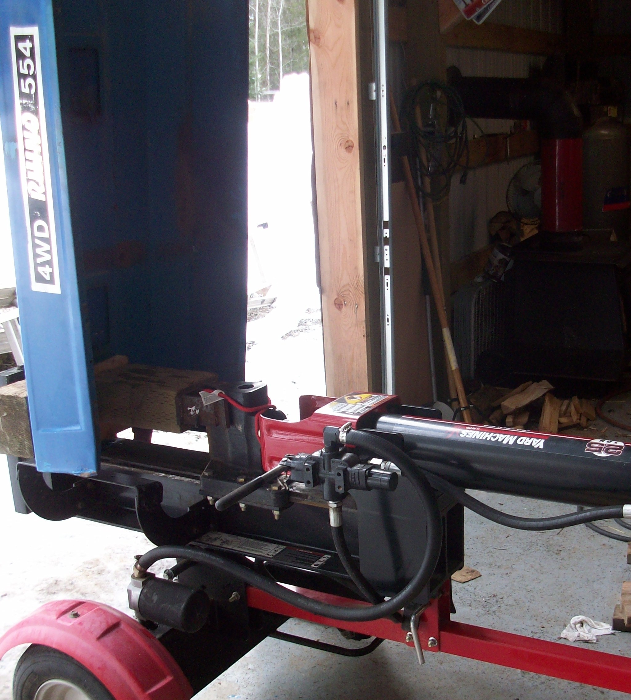

I see I'm not alone, sometimes its just a momentary thing, like looking for a dripping hydraulic line instead of watching the loaders movement-and of course after crushing the hood there wasn't a drop of oil from the reconnected line.!!! Thanks for the body work suggestions , I've already painted a few cars, but this chinese tractors sheet metal is like .060 thick, its much harder to work than most cars sheet metal, sooo something special is in order and since the tractor was involved in the first place why not make it do part of the work Rhino-body work 003.jpg hey that worked pretty good, That gives me another idea..Rhino-body work 004.JPG

I have that exact same wood splitter. Check that the return hose going to the filter doesn't chafe on the work table bracket just above it.
l Thanks, I'll check - looks like about 3/8" clearance, ok so far, although 2 years ago I did see a recall for this model at another store that sells them. It was for a sticking hydraulic valve problem, the serial#s were from a different run than the one we purchased.. Has been trouble free.
We have the same model but it might have different stickers. On ours, 5 or 6 of the bolts that hold the "table" on each side have snapped. Debating if we want to just fix it, or make up a log lifter...
