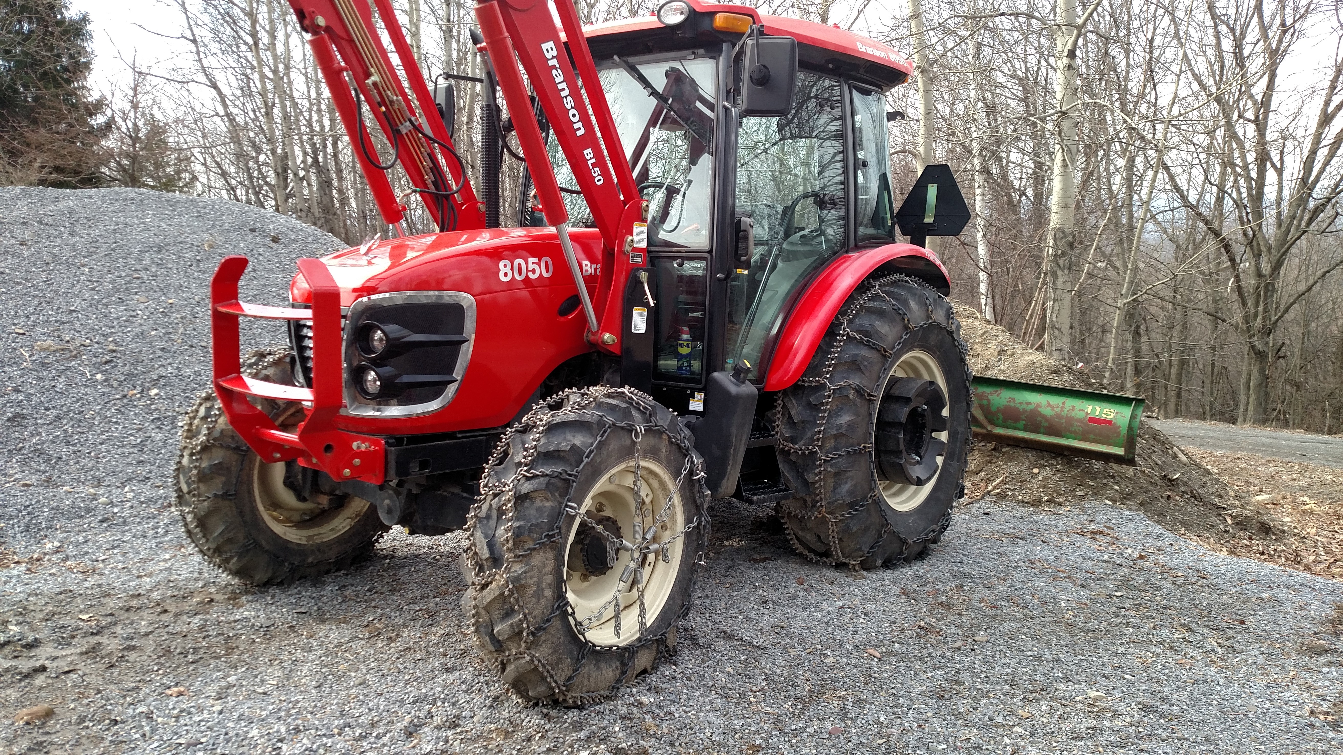

I have read thru most of these posts, with the numbers you are quoting on your driveway,
and having to use 4wd in the summer on your pu yes a tractor will work.
One concern would be the oiling system and hydraulic pickup, it is difficult to find slope
values from the manufactures on their equipment, my driveway is between 20-25 % slope
on most of it. I use a larger tractor for my driveway maintenance plowing then most do.
If your atv with chains can be dicey so can and will be any tractor.
You will most certainly need chains on a tractor, any tractor.
The studded Euro are without a doubt in my mind the most gripping chain you can
have on a tractor untill you get into the multiple diamond skidder type chains.
With extreme slopes up or downhill can result in oil starvation to your engine
and hydraulics. I run mine a bit over full, over filling will not hurt unless you start
getting aeration of the oils from the crankshaft or other rotating components.
You could get more seepage from gear boxes and such, to me that is usually going to be a minor concern.
I seldom use my front chains unless an ice storm is forecast.
