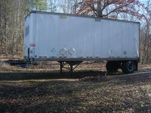

Guys, I am buying two "retired" 38 foot semi trailers. They have 2 axles and are fiberglass bodies with the usual wood floor and landing gear at the front. I want to hide them down behind the barn and I have a perfect spot for it.
However, I can get them delivered to just beside the barn and then I have to somehow move them into place without the truck. I want them to be nose first towards the forest so the back doors are easily accessable.
I have a Kioti CK30 TLB. The FEL that can lift (ideal measurement) about 1100 or 1200 lbs and I also have forks.
Any suggestions on how I can move the trailers with my tractor? Am I going to have to make an axle for the landing gear and push them or can I somehow lift and pull?
Any comments would be appreciated.

Looks like you got your answer...but I'll add my 2 cents in anyway :p
Wife just bought one of these 1/2 sized trailers. The ones they use when they pull double trailers.
I have a full sized JCB backhoe/loader...figured I'd just hoist the front end up and push it... THEN I discovered the stupid brakes automatically lock!!
I had to buy what I think is called a "Glad hand"?? and made an attachment for it to go onto my air hose. I put the compressor tank in the bucket of backhoe, got a long length of hose, went to trailer and attached it... opened pressure and it released the brakes!!
I had the wife stand WAY to the side and hold/pull the hose so as I turned the corner I'd not run over it.
Lifted the front of the trailer, moved it to where I wanted it and put it down.
Good ideas about putting something under the front landing gear, I hadn't thought of that, thank you!!

No, it really wasn't. I was in a situation where I was trying to make a 90 degree turn to put it next to a tree (probably a mistake :rolleyes:) and that let the front lip of the trailer want to slip out of my bucket (8' bucket)
I just picked it up again and carried on.
I was also in goopy mud which didn't help anything. If it was dry at the time, had I been able to lash the ... what ever they call the hitch pin (?) of the trailer to the backhoe, it would have made it easier but it was no real challange as it was...and this is something I've never done before.
