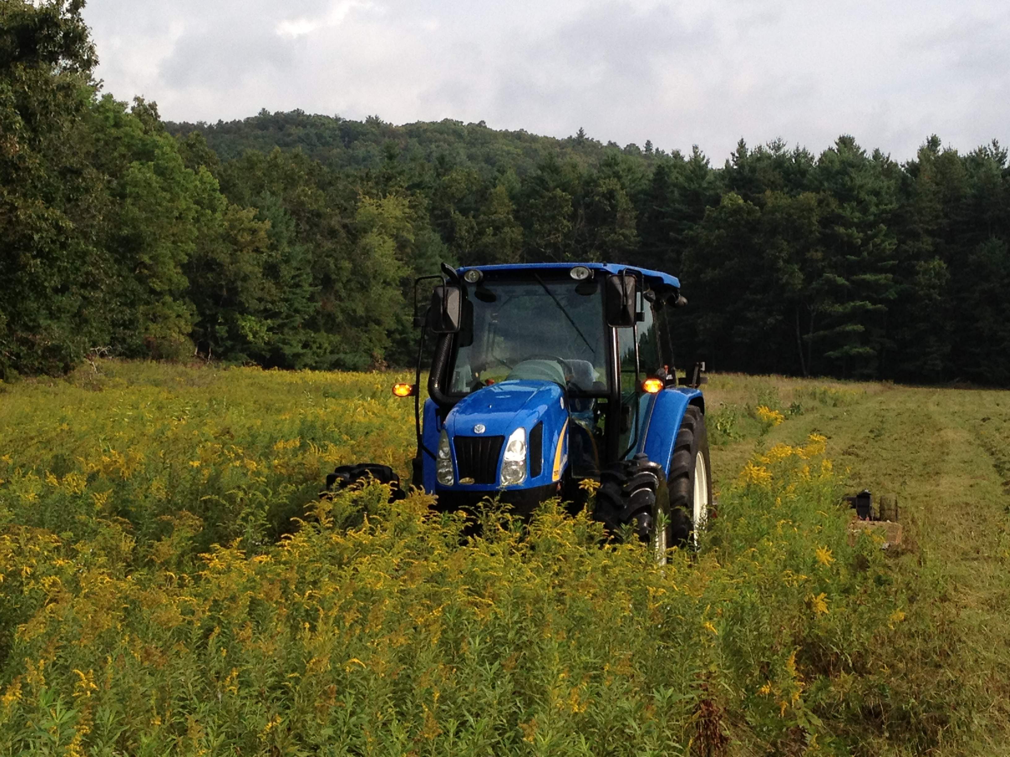

Could just be that he was sick and now the cab has a virus or bacteria in it and that you catch it when you go in. I would dsinfect all surfaces you touch and air it out. Leaving it in the sun may help too (uv kills some viruses bacteria and mold).
/ Tractor making me sick? #22
I would wear a dust mask and gloves while cleaning and inspecting. Use rubber gloves and wash your clothes after the work is done.
Guys are right that molds are dangerous and the entire cab needs to be cleaned.
You could get a battery powered carbon monoxide detector and set it in the cab and let it idle closed up for awhile. Run the a/c or fan to circulate air in the cabin while running to see if the exhaust is seeping into the cab.
Tom

Sounds like carbon monoxide poisoning. Joint aches, flu symptoms. You get enough of it and it takes your body a while to get rid of it. Go to lowes and get a co2 detector. Put it in your cab and run it a while and see what happens. You have exhaust getting in somewhere. If you are worried about germs spray inside of cab with lysol and leave on surface for 10 mins wet. Will kill about anything.

just wondering if you got into some sort of chemical spill during bush hogging, and nothing was ever reported, or was reported, and you just do not know about. and chemical is all caught up in the cab and HVAC ducts.
hyd oil leaks, antrifreeze leaks, other fluid leaks into the cab, been there done that, i just do not remember side effects, before i realized what happened, and fixed situation.
mice and other varmints are a pain in rump that you never able to solve. they get into wide range of areas, and chew stuff up. and some birds do the same thing.
double check exhaust pipe, see if you can "turn" the pipe. so when driving into the wind and with the wind, the exhaust does not come back into air intakes. easier said than done. have had my fair share of exhaust *ughs* i have had to adjust the exhast pipes a few times over the years, bolt/nut came loose, or vibration helped turn it some, to just hitting something.
get some bungie cords, and strap the doors open, and open up the windows if you can, and see what happens. for a quick move of tractor.
the one things i do hat about tractor cabs, it is not always easy to clean them out, its not like a truck or car, were you can stand on ground and crawl down to the floor boards and around seats. and everything tends to be "molded" so you need to deal with clips and screws and other fasteners, to get into the niddy griddy of things.
with above said, just bleaching or using some sort of mist or cleaner down ducts may only be a temporary solution. and if mice droppings or molds are the problem, till you remove the physical source of mice droppings or like from system, you will be back at a science experiment, trying other solutions as molds and things grow back.

Weird, out of all the a/c systems i've seen that have had mold I've never seen one make someone sick, although im definatly sure it could happen. I'd be getting a CO tester and running the tractor around simulating some work, in that small of cab it wouldnt take a lot of CO to really screw with you. Seems like the easiest test.

Also make sure you are not recirculating cabin air. Most have this feature and warn about not doing it for very long.
