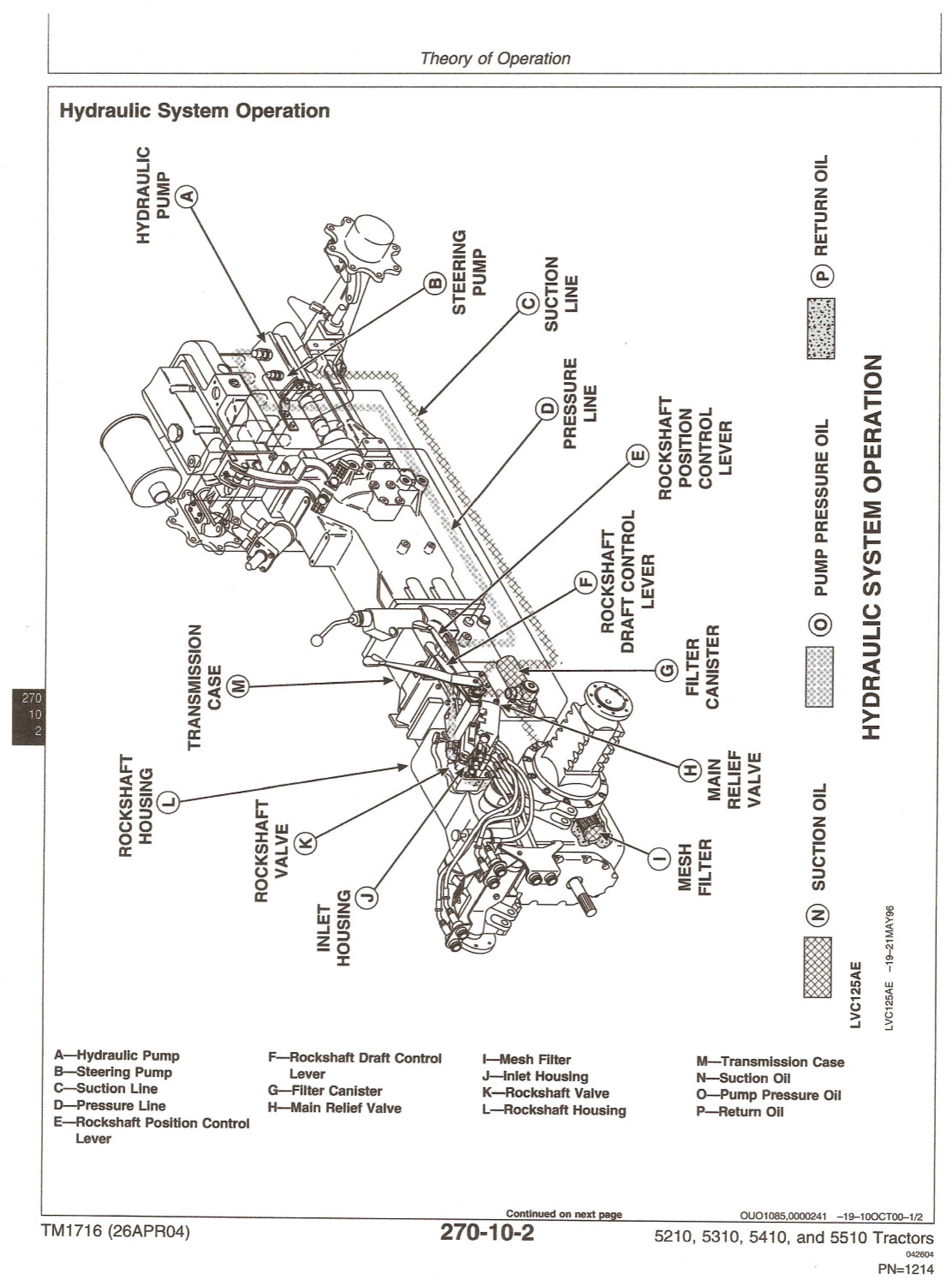

Try putting the 3PT level in the middle position, incase the 3PT is the issue. The hydraulics for the loader and 3PT for lack of a better term use the same hydraulic circuit. I have attached a picture of the hydraulic system that might help.

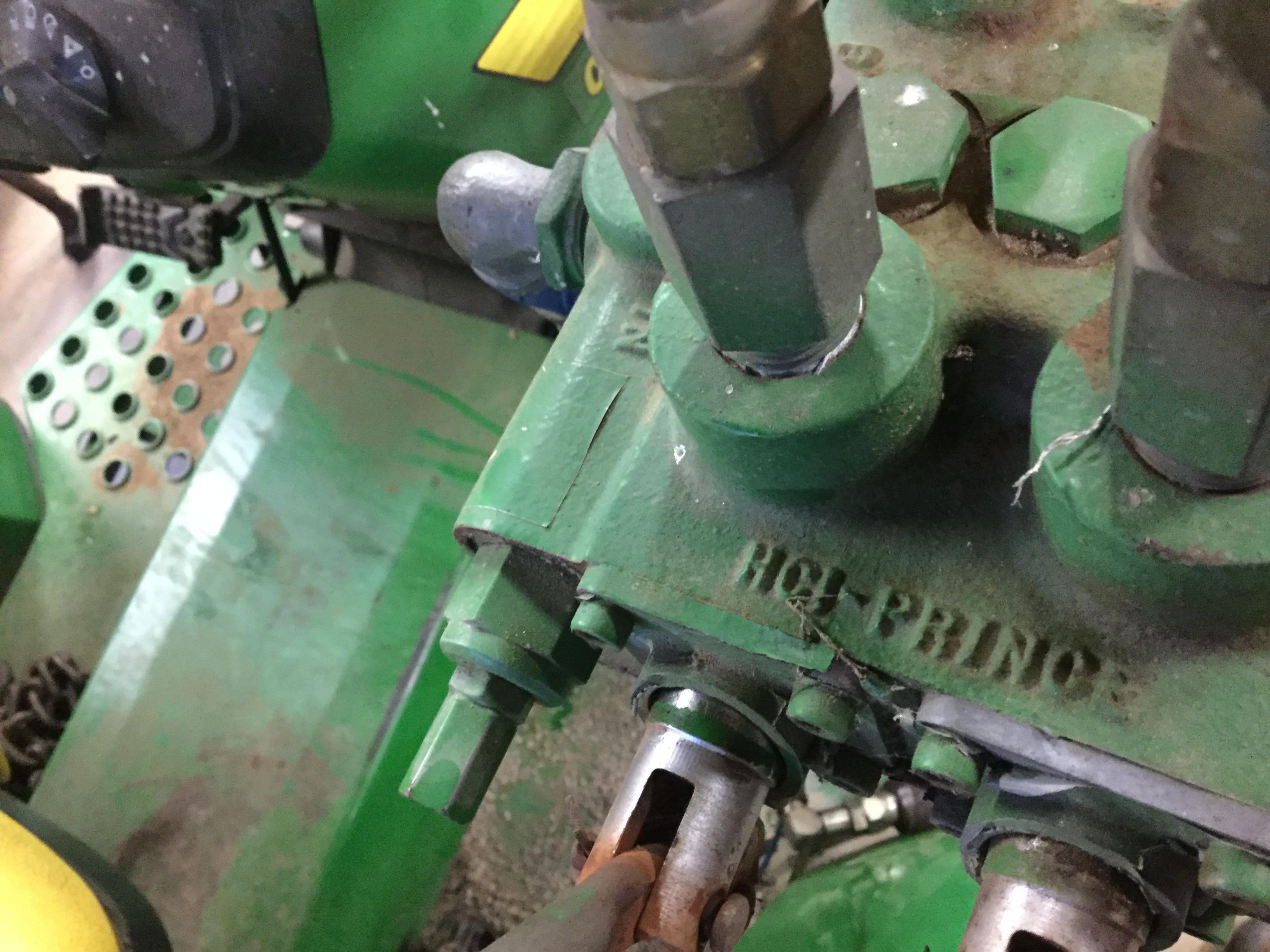

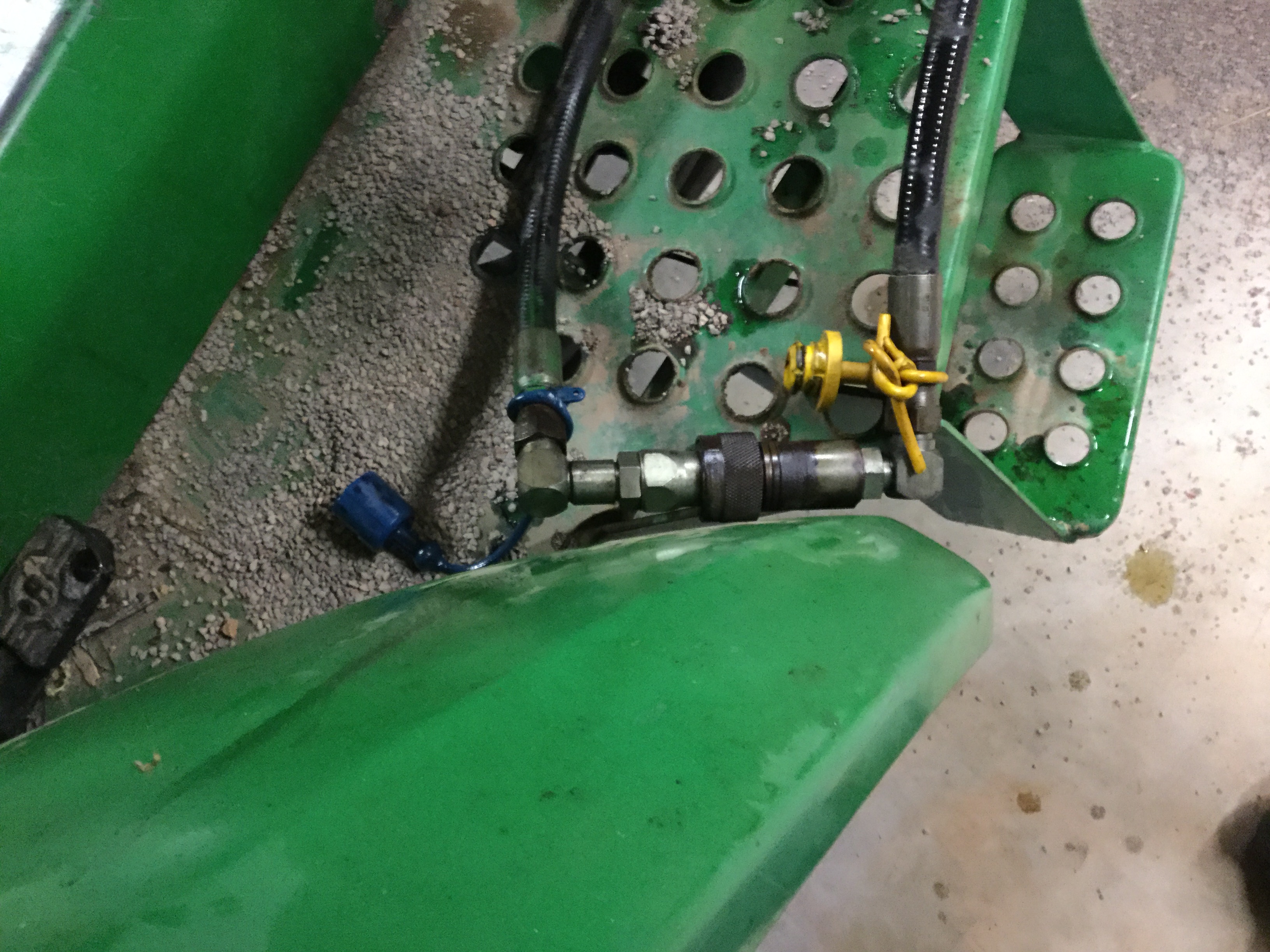

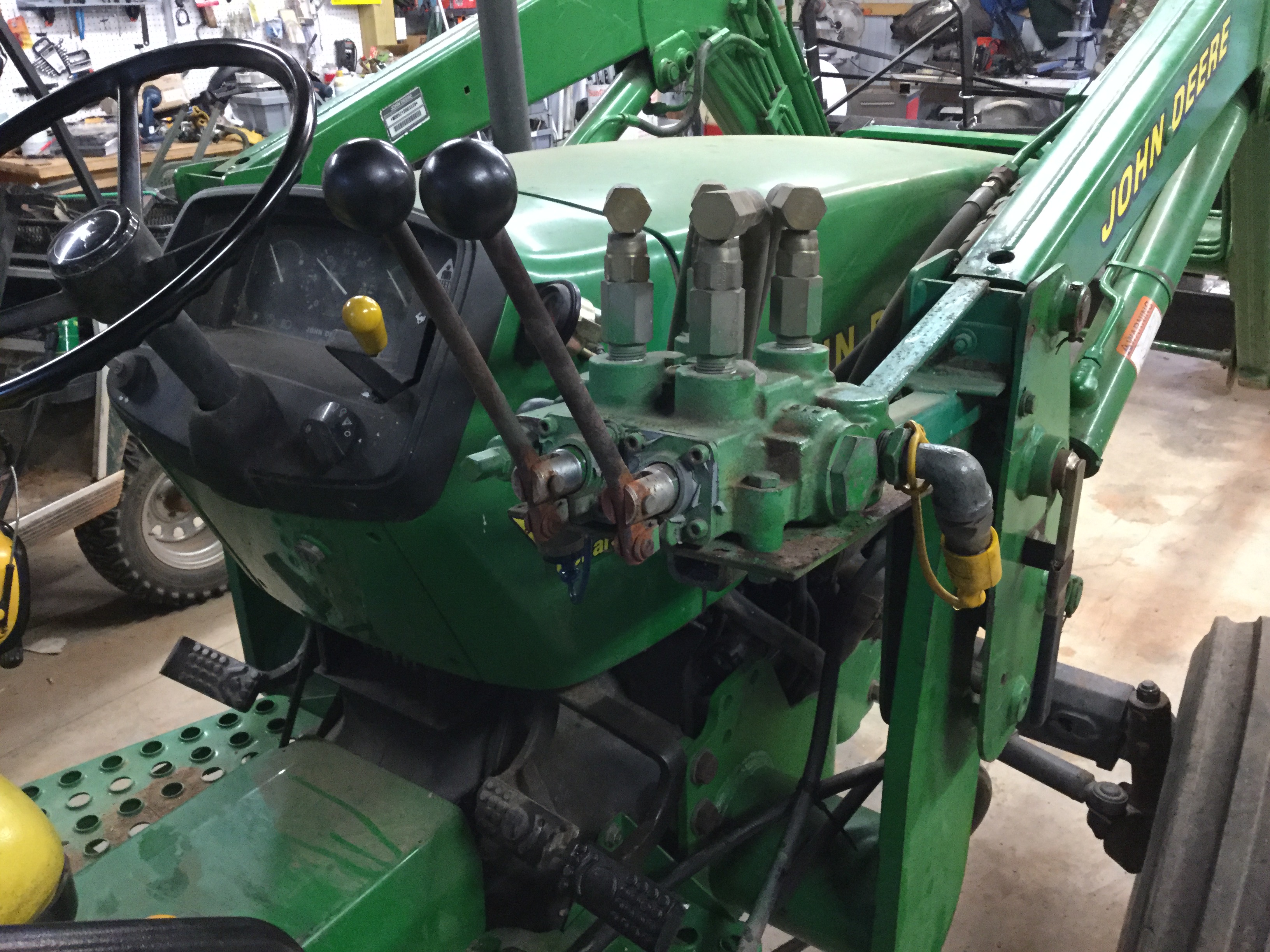

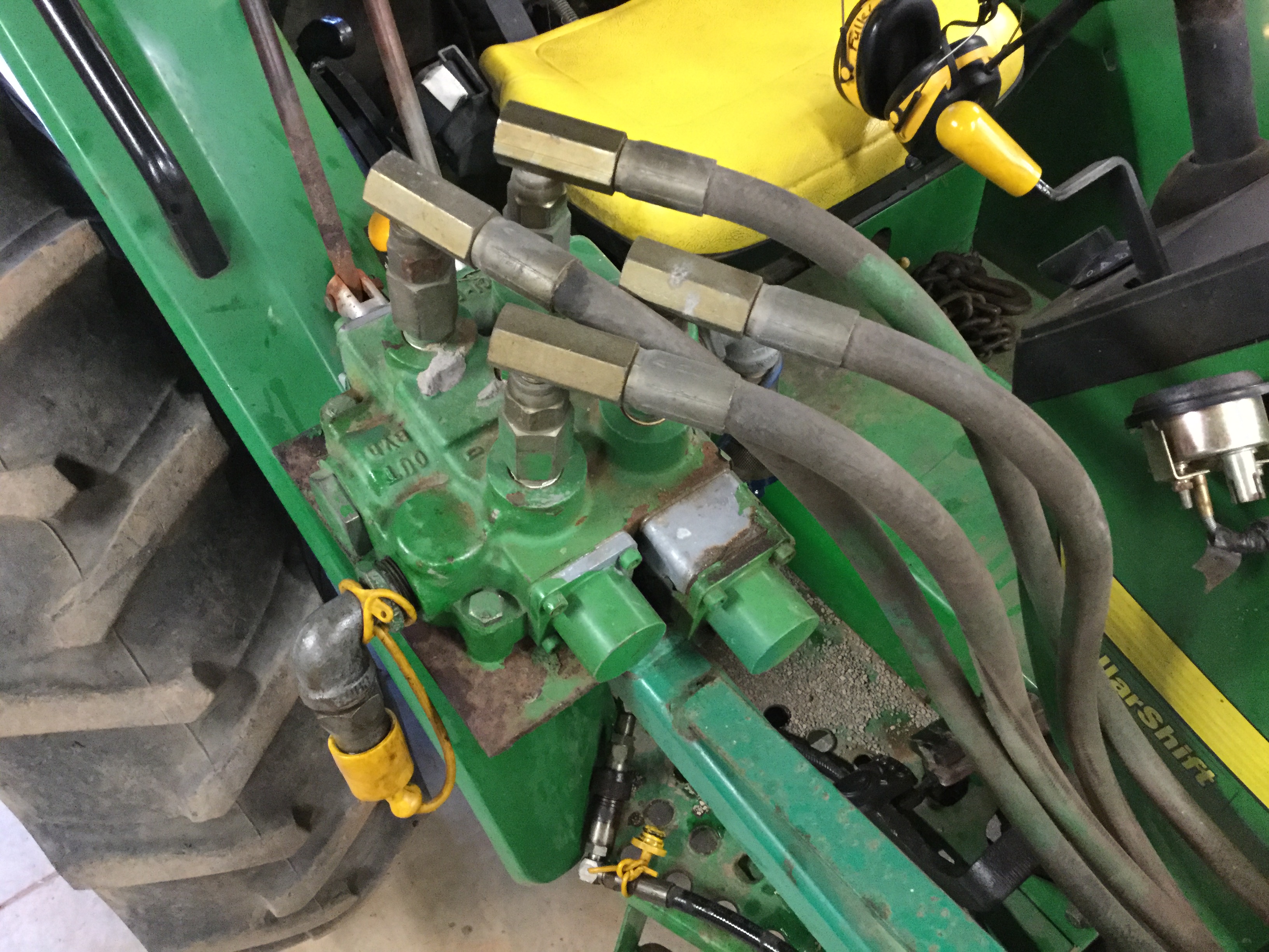

The machine has the 521 loader.
I ran the tractor yesterday and started up fine but again started losing power and unable to maintain rpms.
Disconnected the loader hydraulics and tractor ran fine.
Did note heat buildup at quick connects where hydraulic lines come into loader valves.
If it matters, the loader works fine and seems to be less load on engine when loader being moved up or down or curl without a load on it.
In these pictures the hydraulic lines to the loader valves were disconnected.
Again, I am very grateful for all the help.
I have never worked on hydraulics but it seems like a relief type valve in the loader controls are my problem but I may be way off base. Do I need to just take this in to repair shop or is there something I could clean out and get it functioning.

View attachment 480608View attachment 480609View attachment 480610View attachment 480611
The out port on the valve block appears to be plugged. The fluid has to flow back to the sump when not being used to control the loader - and the out port, if connected to the return line, would do this. You need to find the return line and tee the valve out into it. Do not continue running the tractor while this remains unresolved.
,,,,,Have you asked your dad about it?
/ Tractor losing power after loader attached
#9
When I disconnected the hydraulic lines to the loader, I connected the IN line to the OUT line and put the rubber caps over the exposed quick connects on the loader valve. In the second picture you can the IN and OUT lines connected to each other. I assumed that was the thing to do because when I disconnected the loader I lost 3 pt lift. Once I connected the IN line to the OUT line, 3 pt lift arms started working again. I think that is what you meant when you said the out was plugged.
Again I don't know much about hydros. I'm trying to learn and solve a problem.
I apologize if I'm not making sense.
Also, what does "open center" mean?
/ Tractor losing power after loader attached #10
Open center lets fluid flow through the valve unimpeded when the valve levers are centered. ... From your explanation above Ill then assume the loader valve is not hooked up to pressure in the pics. -- When the loader is hooked up (blue IN, yellow OUT I assume) does the 3ph work?

/ Tractor losing power after loader attached #12
Yes, should be a special case of open center, properly termed "tandem center". ... That other port on the valve next to the yellow is plugged. It is probably a Power Beyond port. In normal hookups both ports are used. The out is hooked to an unvalved [open] line straight back to the sump. The PB is hooked to a line leading to whatever loads are downstream. -- That said, I am confused at what is happening with the loader valve in and out of the circuit. I have heard JD uses a closed center setup, at least on some of its tractors. Im surprised no one familiar with JD hydraulics has responded.
