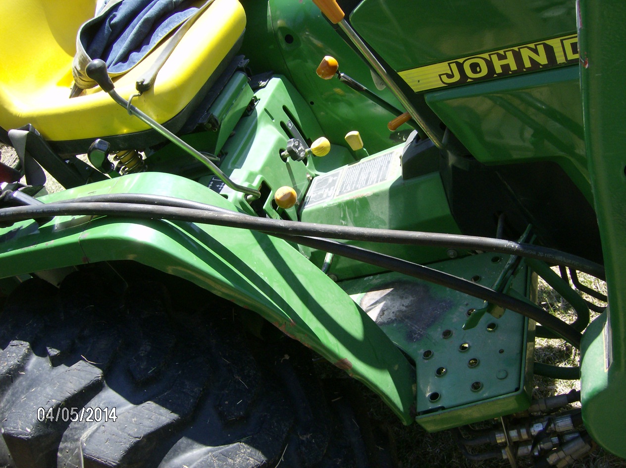

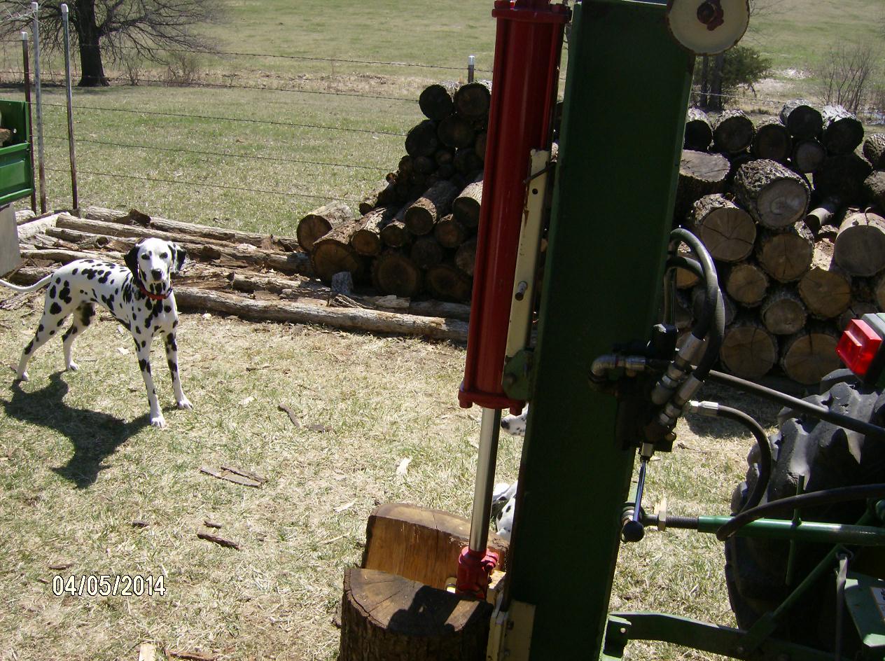

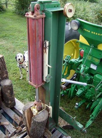

I prefer vertical tractor mounted to save having the extra engine to keep up. I originally made mine for a 1958 JD 520 using the tractor hydraulics: Picture 264 (Small).jpg
When I sold the 520 & bought an '04 790, I had to add a control valve to the splitter & long hoses to the loader bucket connections: HPIM3027.JPG HPIM3028.JPG
I tie the joystick off to the opposite fender with a tarp strap & go to work. This isn't fast, but neither am I & I work alone. By the time I get the splits stacked, it's up & ready for the next one. As for hours on the tractor, I put around 100 hours/year on it, the few hours spent on the splitter aren't going to add up very fast! ~~ Lowell
I read an earlier post about this approach being problematic -- the bungee cord one. Is it okay to do this? I think JJ authored that post. If it works, and doesn't damage anything, I'm in!
   / Tractor Log Splitter #7
I checked with the local dealer's shop foreman, as long as the splitter valve is an "open center" valve, no problems! ~~ Lowell

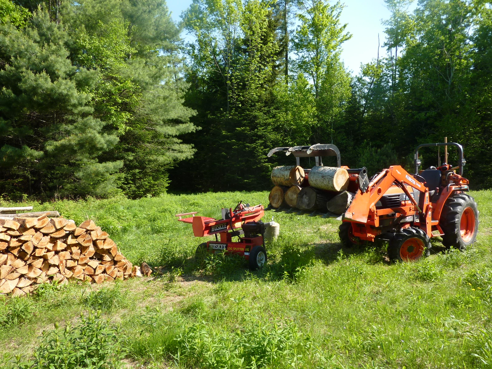

I prefer a stand alone splitter so I can use the tractor/grapple/carry-all when I'm processing logs into firewood...
