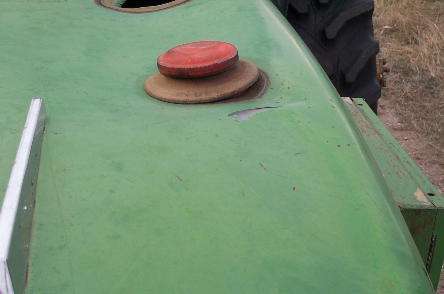

   / Tractor hit by falling tree top #28
I had a 50 foot auger blow off the Bin and hit my tractor missing the cab by inches took off the muffler hood and even too the neck off the fuel tank and air intake,
as stated I took it off turned it up side down and basically walked the hood back straight, a little with a rubber mallet and block of wood for back up, there were no small dents in it from pounding, and turn out well, I would suggest trying not to use bondo if possible

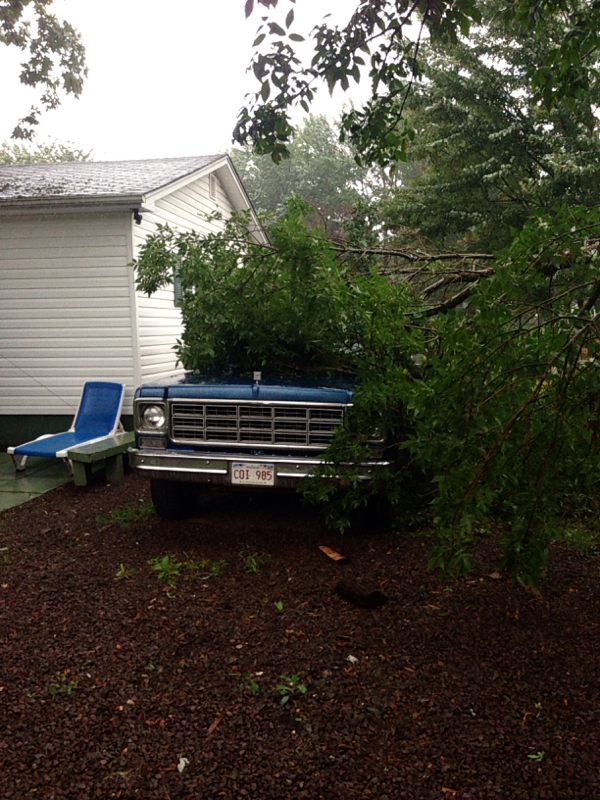

   / Tractor hit by falling tree top #30
Sorry about your tractor. I just missed that happening to me. My tractor was where my truck was the day before. My truck is a 1978 1 ton and the tree mostly landed in the dump insert. A couple of scratches and a broken plastic window moulding. Figured I did ok.
