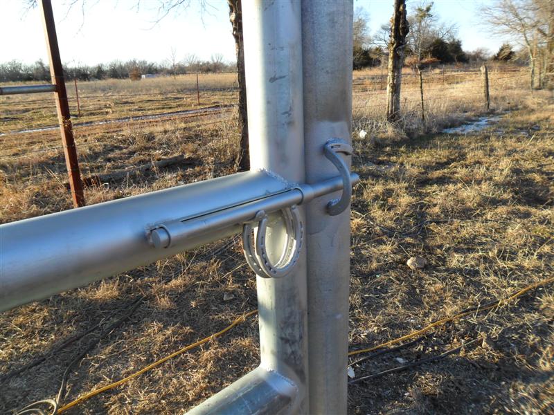

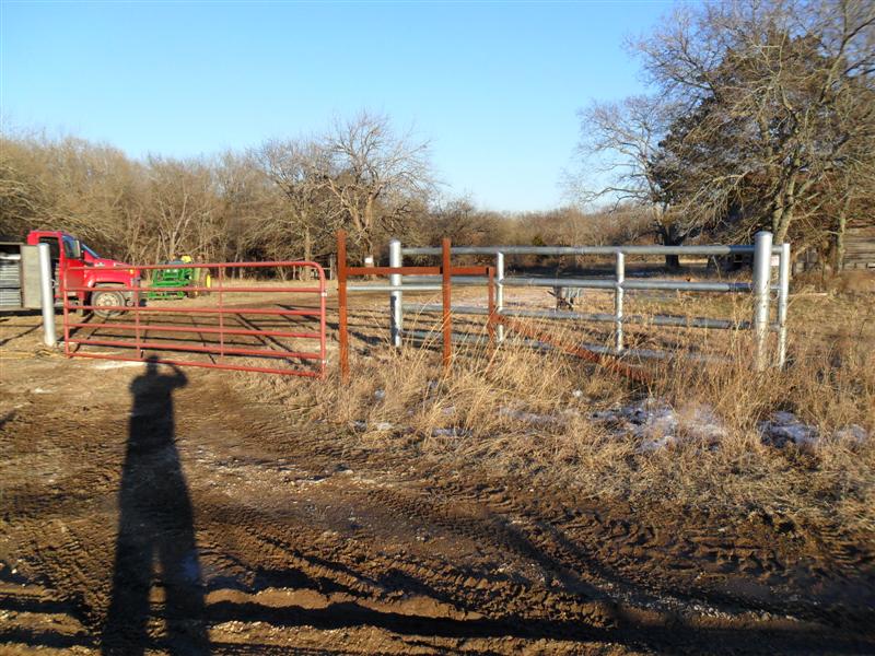

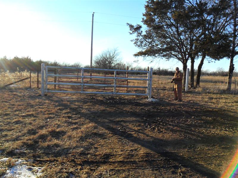

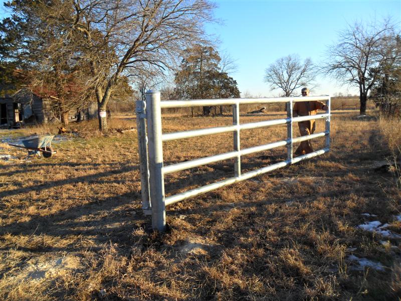

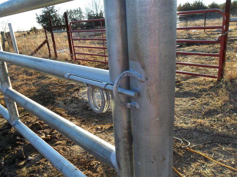

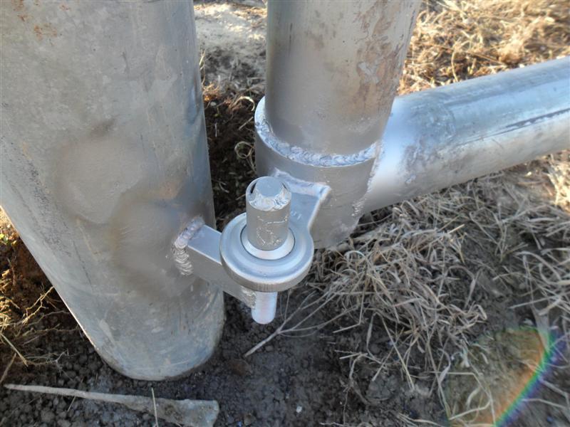

The gate is hung, finished.

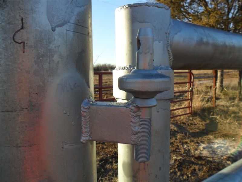

We set the hinges offset so that he could open it 180 degrees. It ended up we could open it over 210 degrees. It was a bear digging the holes and the latch post hole moved in a little bit so we made the best of a bad situation.

Nice job Harvey! :thumbsup: I like how you offset it to allow for the swing. Oh, and not to mention those hinges and good old horseshoes for latches!:thumbsup:
/ Tractor hinge for farm gate #45

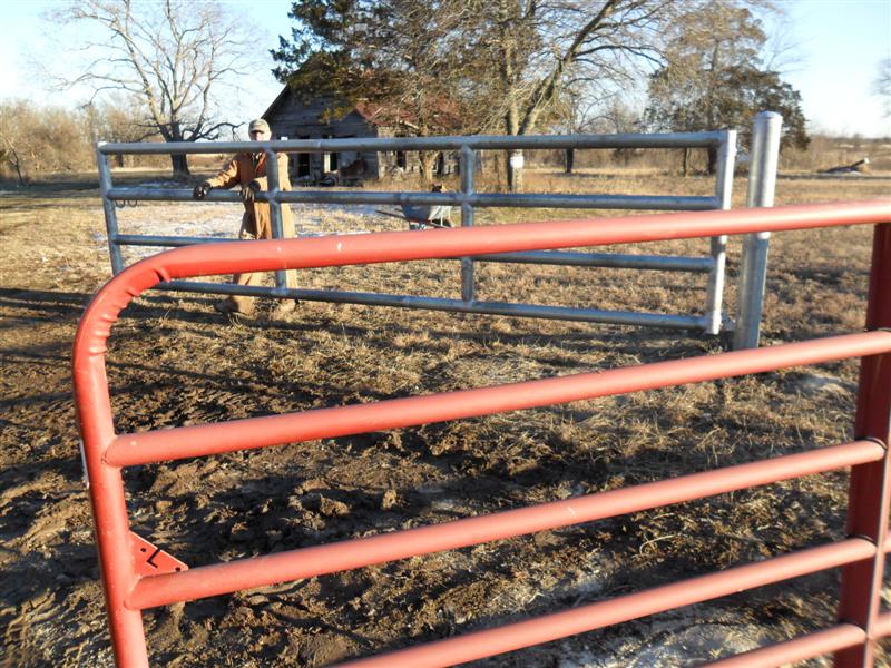

I like the side by side comparison of the two gates. Makes the standard TSC 2" tube model look mighty puny. Nice project Harv, by the way, did you ever start making those no-weld building brackets for sale to the public?
