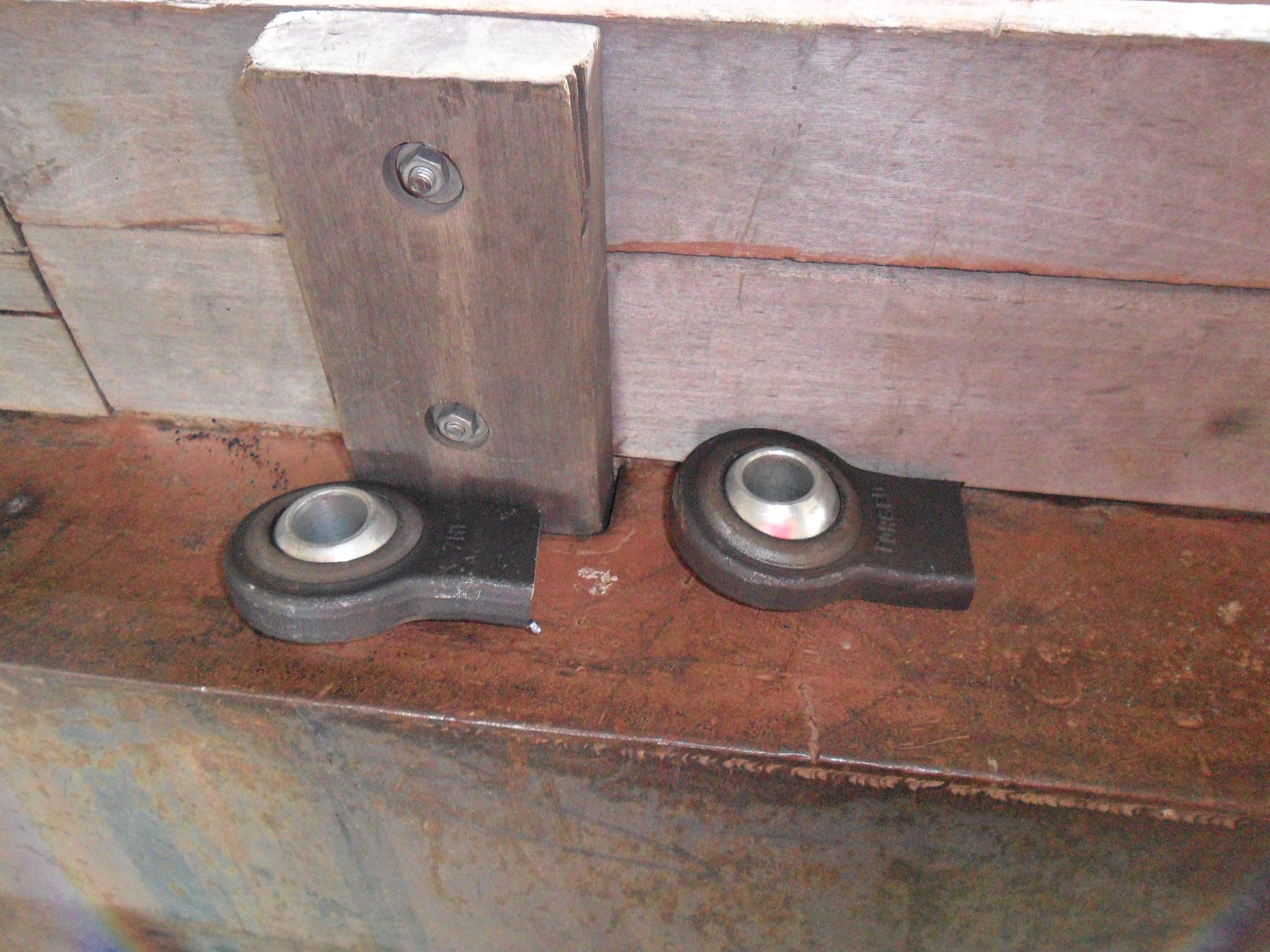

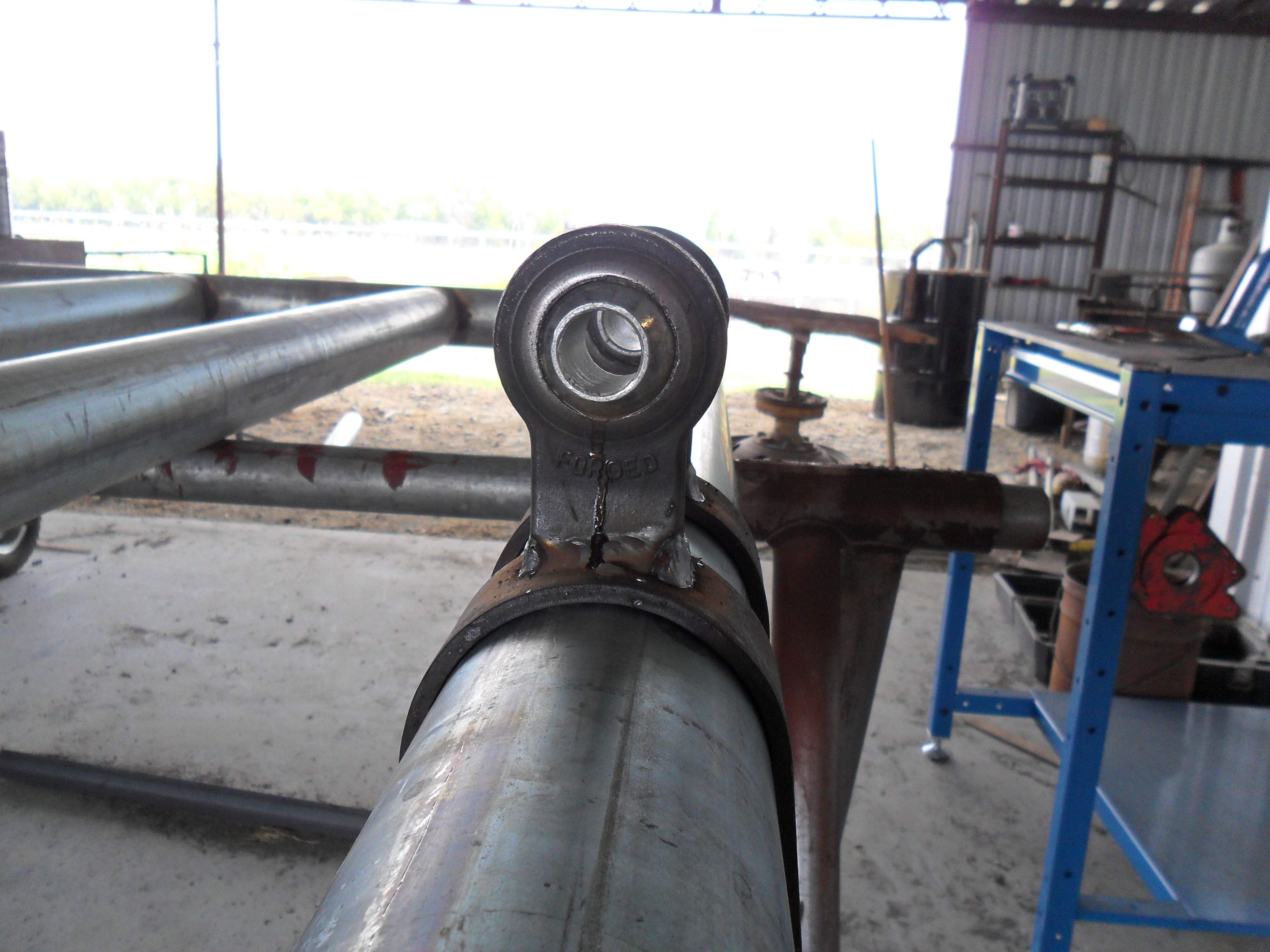

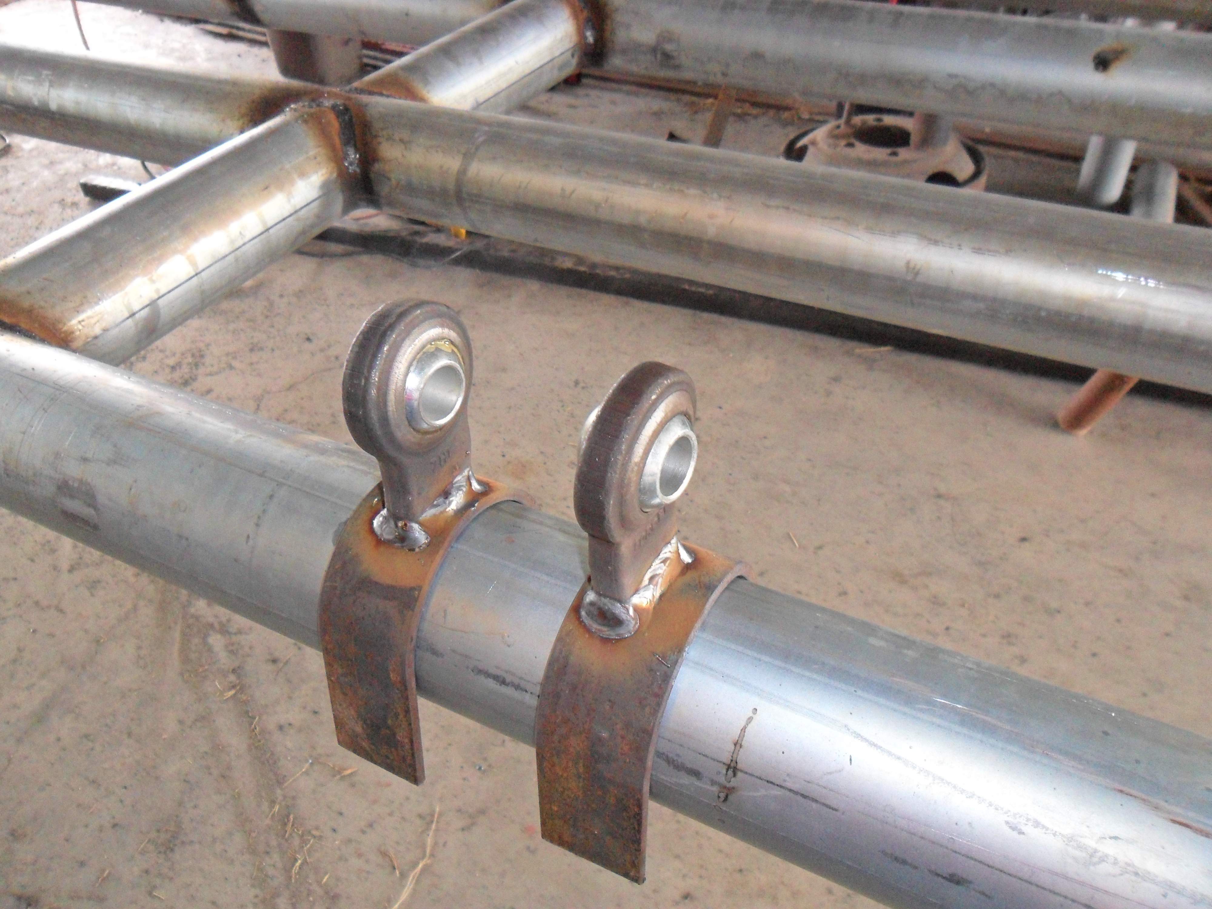

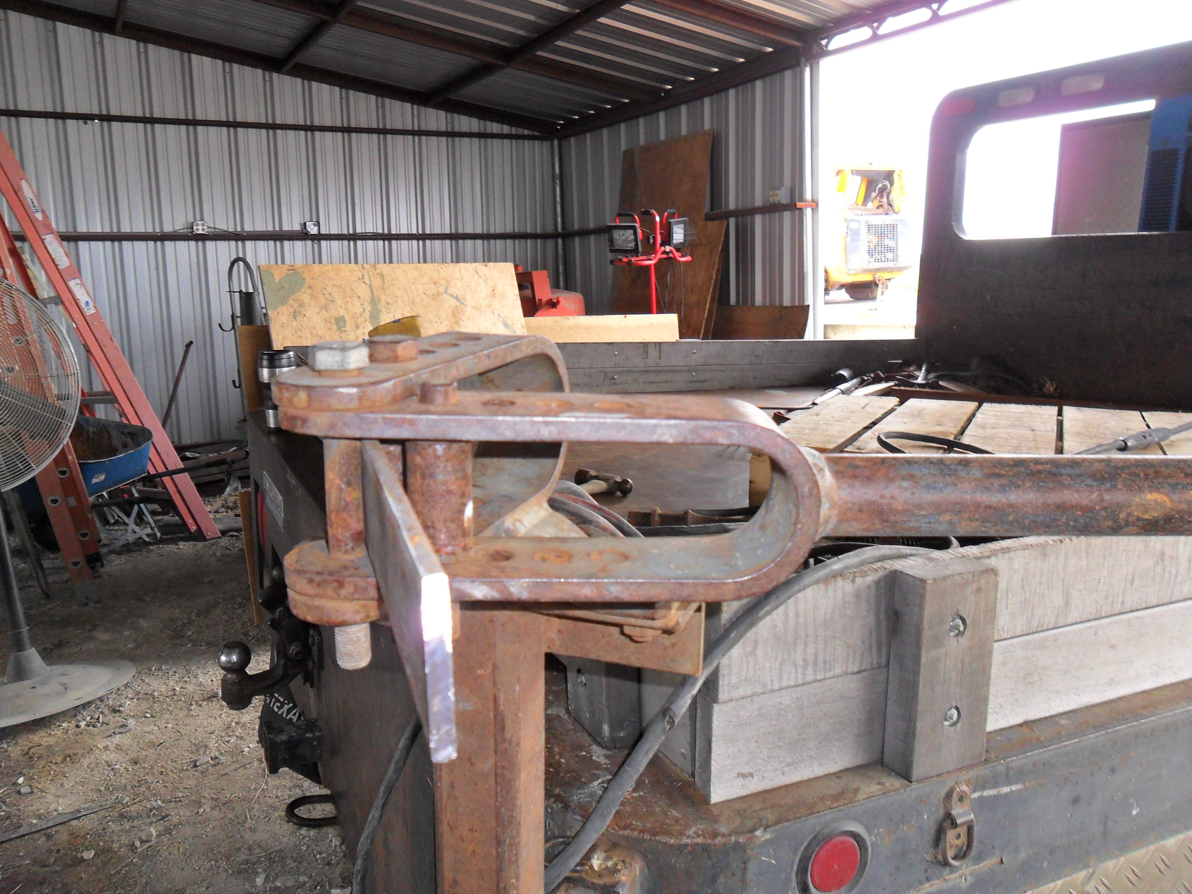

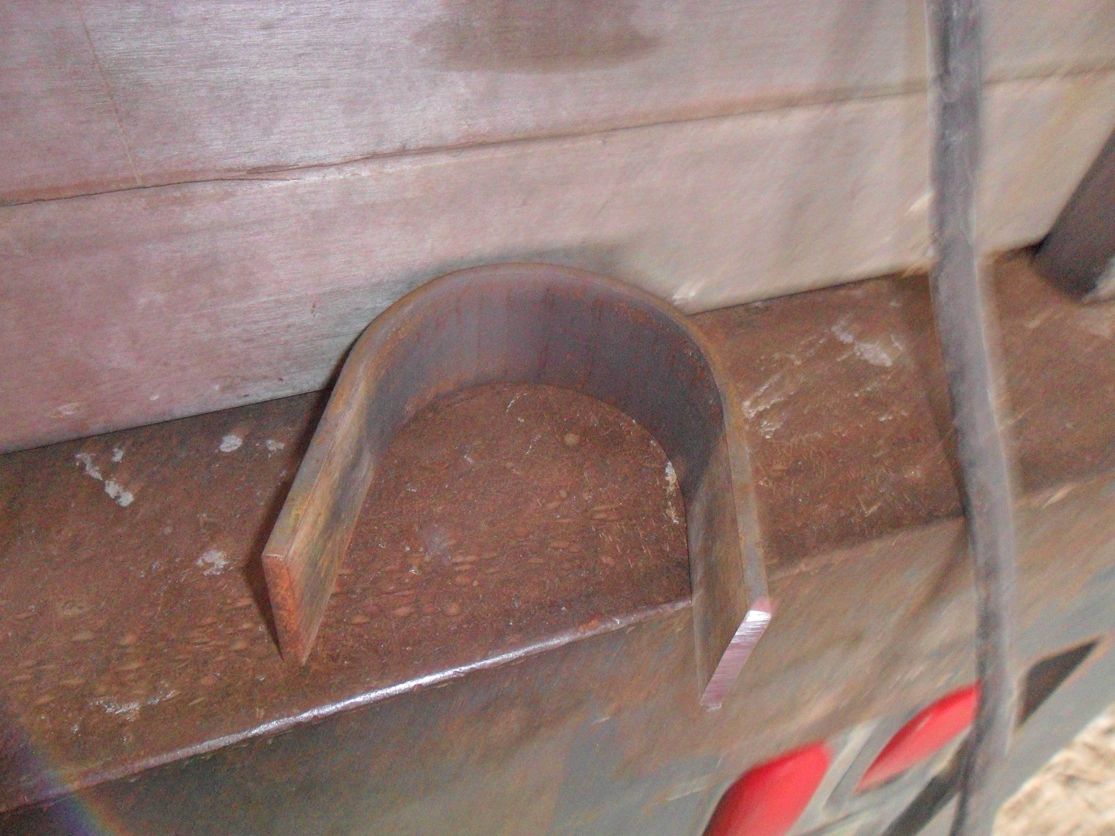

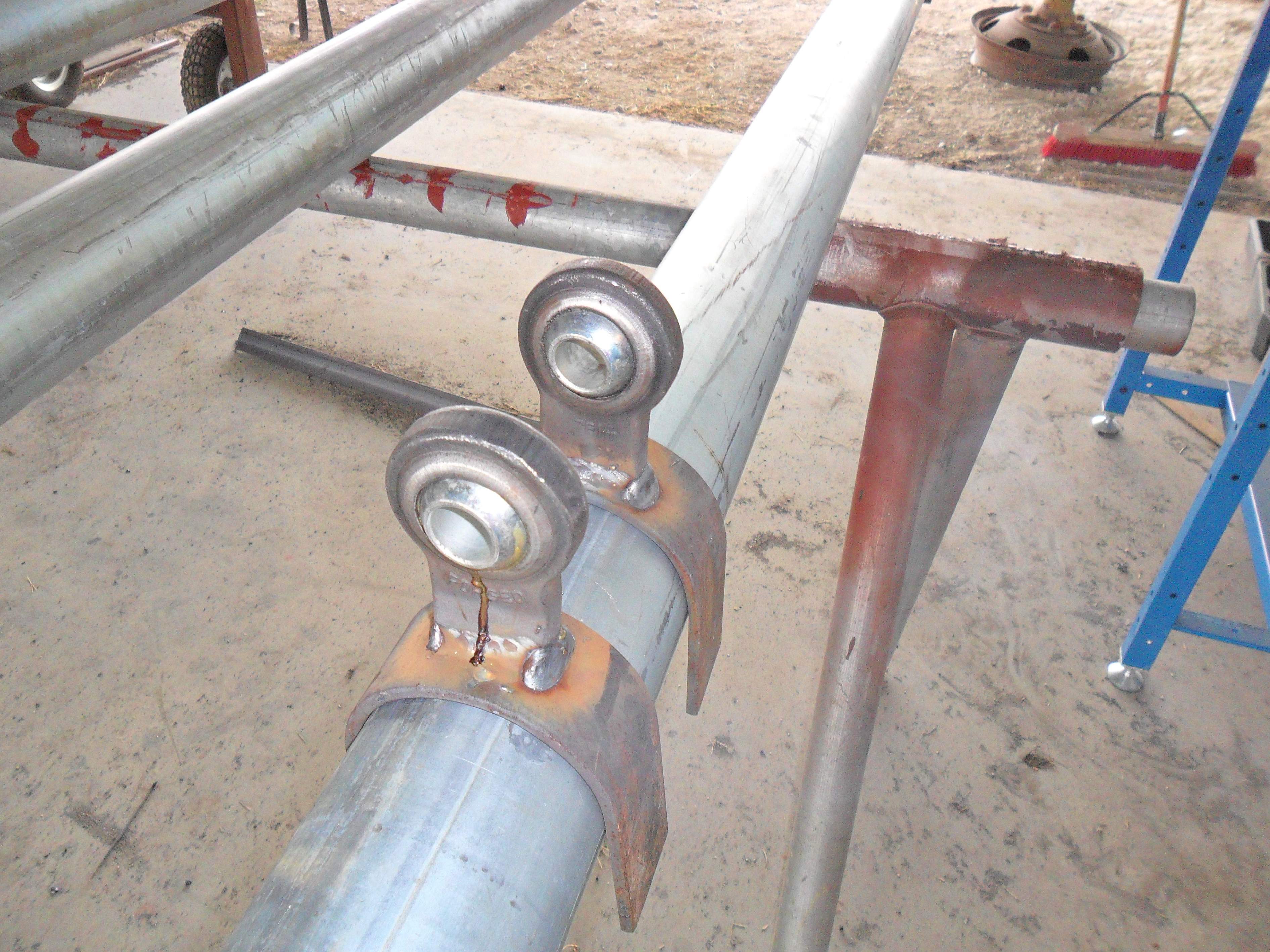

The four inch EMT gate is done but I don't know whether I'll go up to Oklahoma to install it or if my bud will have a local install it. So I made some tractor hinges for it just in case.
1/4 X 2" bar stack cut one foot long. Using my Riley McMillen handy dandy Hossfield imitation bender that fits in the hitch receivers in the back corners of the truck bed I bent two four inch U's.
I welded two three point hitch pieces to the two four inch 1/4 by two U's.
This way the gate can be blocked up in place. The U's can be welded to the gate and the pins can be welded to the posts.
I love these hinges. No grease needed, just a little oil on occasions keeps them alive for a long time. Another thing that's neat is if the weldor is off a little bit in the fit up of the hinge and pin this system self aligns, bind is something for others to enjoy. I also like to use them on gravity hinges, again for the self and or variable alignment reasons.
Besides the beauty of the heim or rod end bearing there is the ease of installation with this system. One of the problems with light weight material like the fourteen gauge used in the gate frame is it offers little strength for a welded on hinge. The 1/4 by two inch bar stock takes care of that.
The hinges are located and welded up along the arc of the pipe. At that point the two pound adjusting tool is used to continue the arc of the bar stock around the pipe. So slick it can make WD 40 look like glue.
