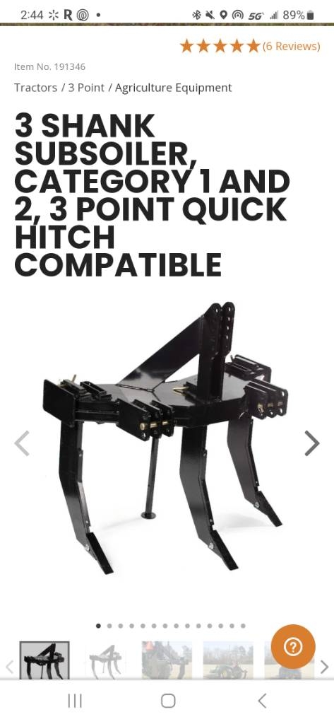

I would not buy a tractor to do initial clearing work. It is possible but slow and even a big stump jumper is not able to do everything, and I have done about 8000 sq. feet of heavy clearing in N. Georgia hardwood forest so I know 1st hand. I used a chainsaw and a bushhog with 40 PTO HP and it's hard on the implement IMO and slow going. Better would be to RENT this
and do the clearing, then come back with a tractor with the bucket or subsoiler blade and do your grading at your leisure. Bobcats do this work so fast, doing in two days what took me weeks. These can be rented or just pay to have it done and the money you save in implements, wear and tear, and time can be invested into a tractor that will help you with the post-clearing work (large tree dragging, gravel drive maintenance, bucket work, garden tilling, cutting) Good luck and be safe.

This disc-chisel might be an interesting approach to you root problems. Once you got things under control, I think you could remove the discs, and then you got a medium tillage tool, if your going for less open tillage field. Should also work well to not overly dry the soil, but also allow drainage.
Don't know if your area has a welding/fab shop/guy; but I would guess chisels and discs could be shipped pretty easily, for the ware components; and the frame made locally.
With 85hp, you could, I'm guessing here, probably manage a 9 ft chisel?
