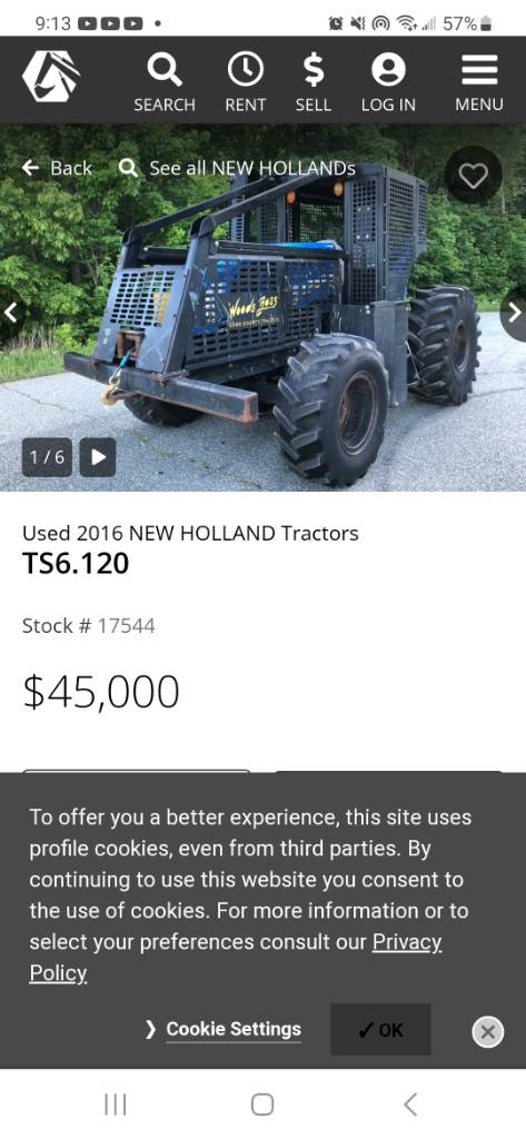

Good day everybody,
I'm looking to buy a tractor which will be mainly used for land clearing and preparation in the beginning. Land is full of small 1-2 inch thick trees which need to be cleared.
Short story, I bought recently 300 acres of virgin land which needs to be cleared, leveled, prepared from scratch.
Initially I was thinking to start with an 80 hp tractor with a front and loader , grapple and leveler but afterwards I had second thoughts that it might be cheaper fuel wise to start with an 50-60 hp tractor which might reduce my costs for clearing the land but I will have to buy a bigger tractor afterwards for land preparation, tilling, planting.
Short version; no matter what you end up doing; start with the larger tractor. Buying small to save fuel and up sizing later; 1st: you won't save fuel; 25% more trips at 15% fuel savings=more fuel; 2nd: your going to put a lot of wear and tear trying to push the smaller machine; probably decreasing the resale value; that 50-60hp might be in rough shape after 300 acres of this; and you already know your going to need bigger for your end use. Might even be worth it to start out with a larger tractor/machine that is more primitive and old; say a 1980s 150hp; knowing that you will later step into a 100hp-125hp more modern machine.
Something like the New Holland Woods Boss; its a 120hp tractor model designed for Right of Way clearing/mowing; used by foresty departments and powerline companies; sounds like exactly what your needing. Now, it's not going to be a row crop package; but that's not to say the cage can't be removed after; change to a typical ag style tire; ect.
I did read into this crop tillage and planting; but if your talking grass pasture you could bush hog/chop; then disc; then hydroseed. If your long term goal is cattle pasture; it doesn't have to be picturesque hay field.
