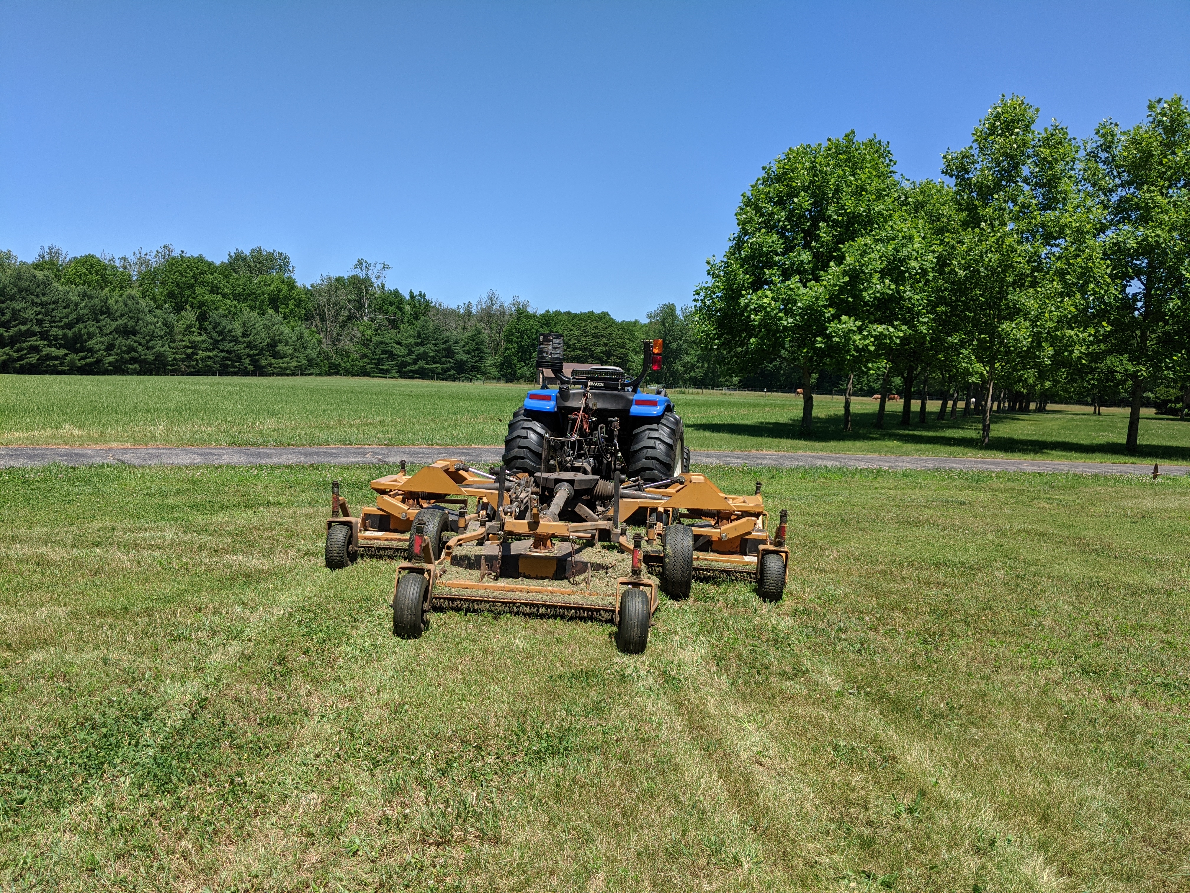

I have a 37hp 4x4 tractor and it's able to pull and run my 84 inch finish mower just fine. It leaves a much nicer cut them my 6ft rotary cutter and it's easier to pull. I don' t have a front loader on it, so when I lift the mower, my front end gets really light. If I'm on flat ground, I'm OK, but if I'm going up hill and I lift the finish mower off of the ground, my tires will become so light that I cannot steer it.
If I was going to buy another tractor just to pull a finish mower that big, I would want something in the 45 hp range. 40 hp should work, but if it's a used tractor, you probably don't have 40 hp any more. For a bigger mower, it would have to be quite a bit bigger tractor.
Since buying my 5ft zero turn, I have not used my rear finish mower behind my tractor. For my nice walking trails, I'll hit them with the rotary cutter if they get out of control, and then go over them with the zero turn. The tires have rotted off of the finish mower, and I'm guessing the belt is probably bad too. It's been quite a few years since I used it. I might sell it, or I might get a bigger tractor and a batwing, and then put the 7ft finish mower on the 37hp tractor permanently for mowing the dam and around my pond.
