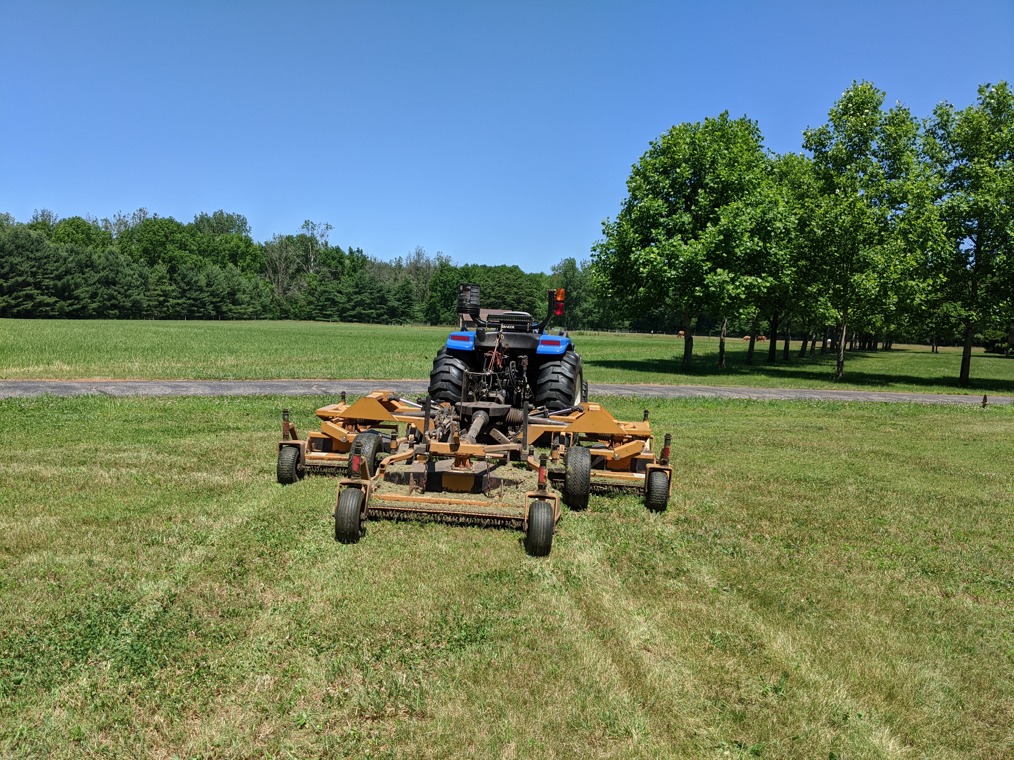

I use a 40 horsepower New Holland to pull a 12 foot Woods batwing mower. This batwing is better for unlevel terrain than a 8 foot flat mower would be.
WOW, that is impressive.
