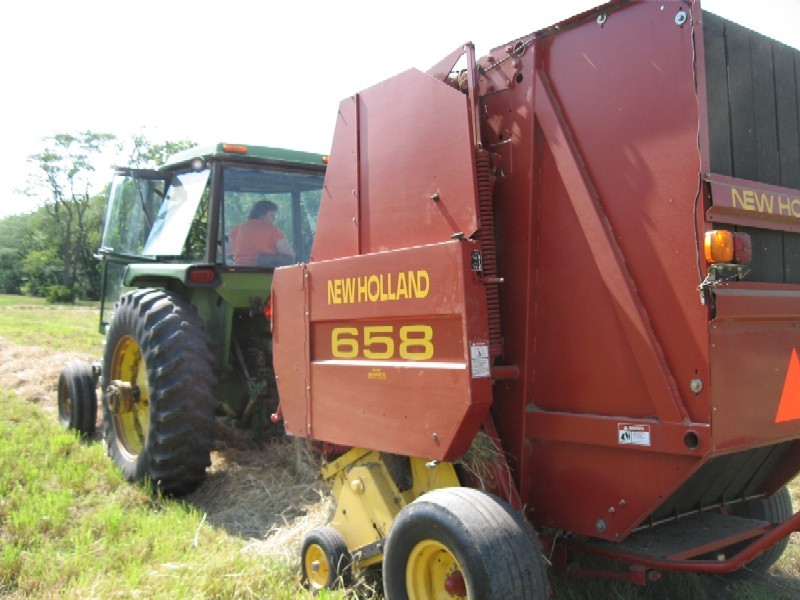

I think you are on the right track here. Heavier is better when moving bales. While many of the smaller tractors will do it as evidenced by the photo of the the kubota above, a larger tractor will do it better and will hold up better over time. You are going to want a fairly powerful tractor for haying as well. I do believe that your dealers are correct on saying that 75 hp is the minimum. Sure you can run a round baler with less hp. I ran a 5x5 baler in a pinch with a 3020 jd and it did ok. Seventy hp or so worked, 85 made it work pretty good and the hundred and five hp of the white that I owned at the time made it talk real sweet.

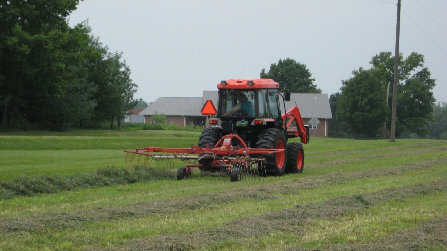

Any of the first three will pull a 12ft mower and the last three will be good for 15ft.

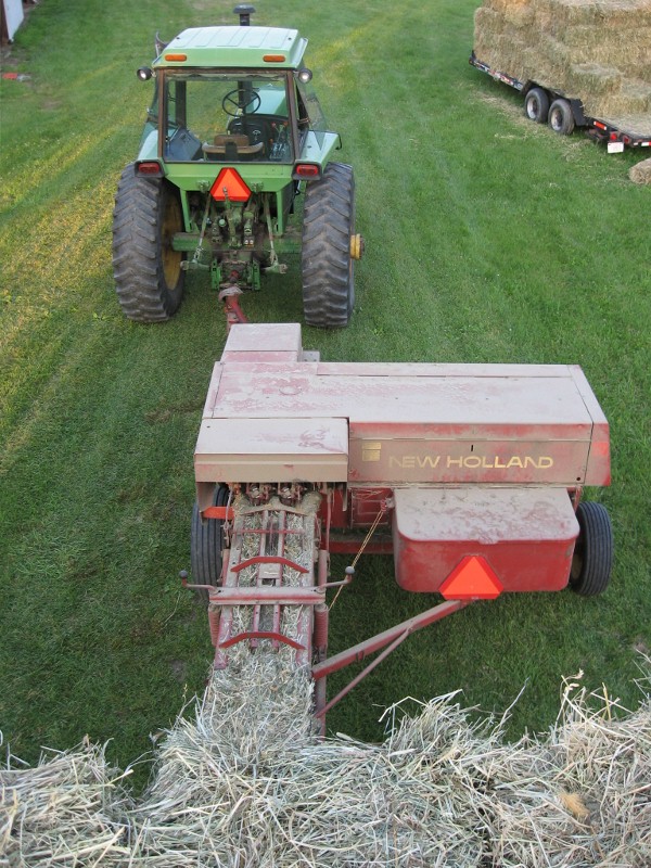

I pull a 5x4 baler with 64pto HP. The last three would be good for a 4x6 or 5x5 baler.

You mentioned hay,got a number on acres and the size you would like to run? I have 30ac.meadow,run a 5x4baler,8wheel rake and 8ft cutter,all new was around 36,its not the best of the best but I'm very happy with it. Just like the tractors can spend all kinds of money on it also.
