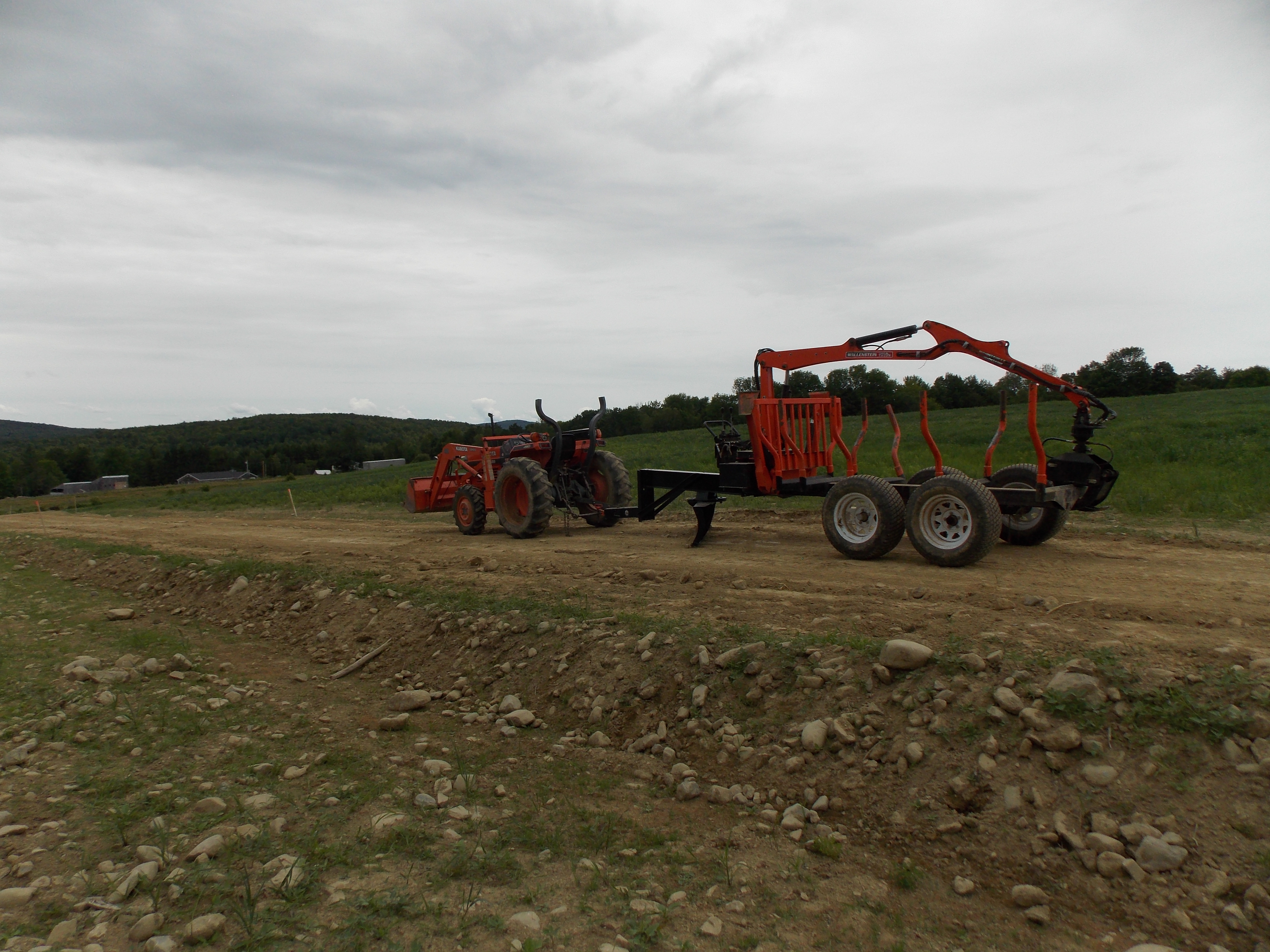

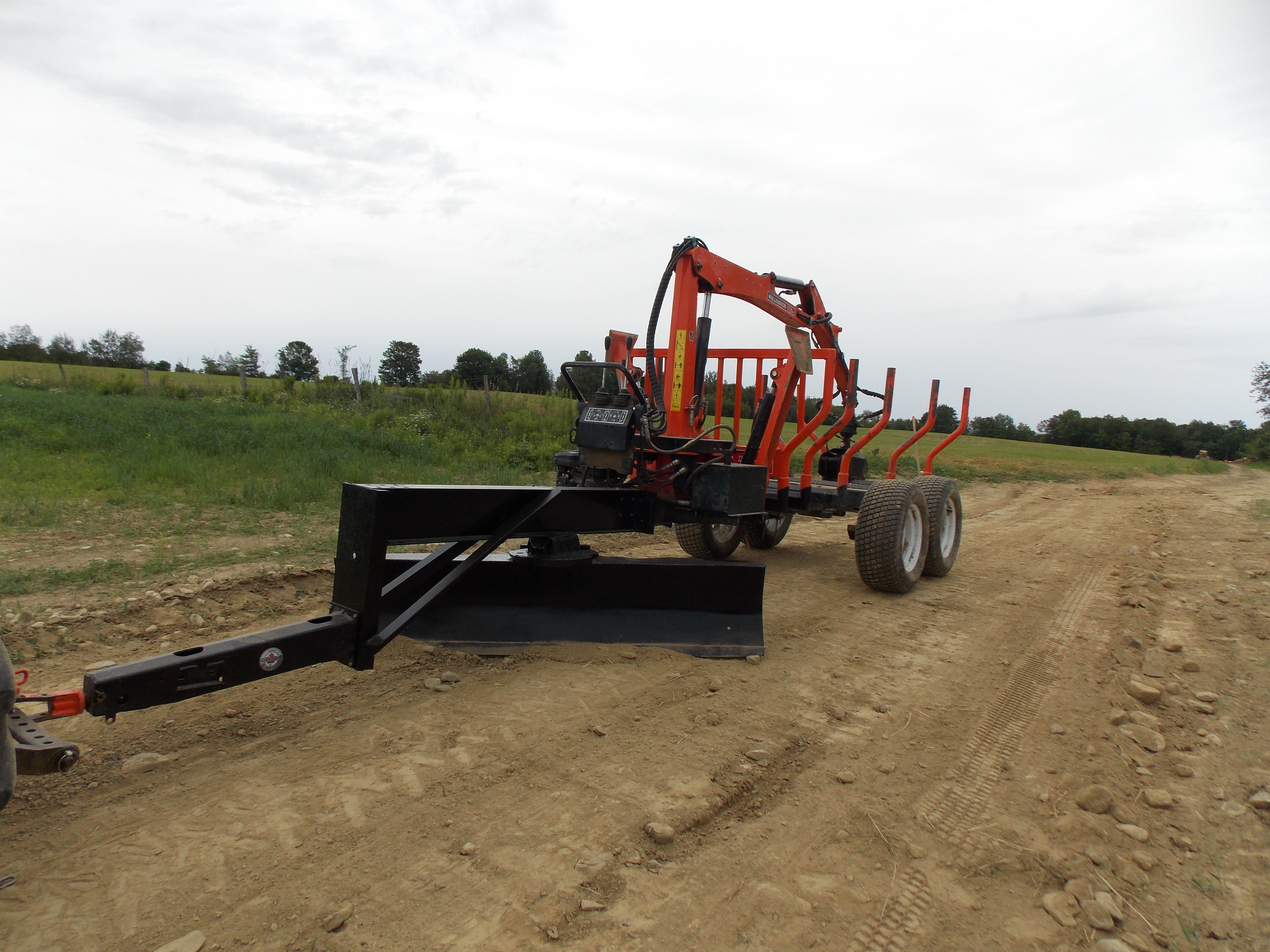

Not wanting to reinvent the wheel, nor fabricate more then I needed too, I used the walking beam suspension of my log trailer, build a grader blade that bolts to the front of the hitch and now have a really awesome grader. I say that because it really smooth's out my heavy haul roads and driveways, typically in only two passes.
No plans, but I can tell you more about it, or work your way through building your own.
