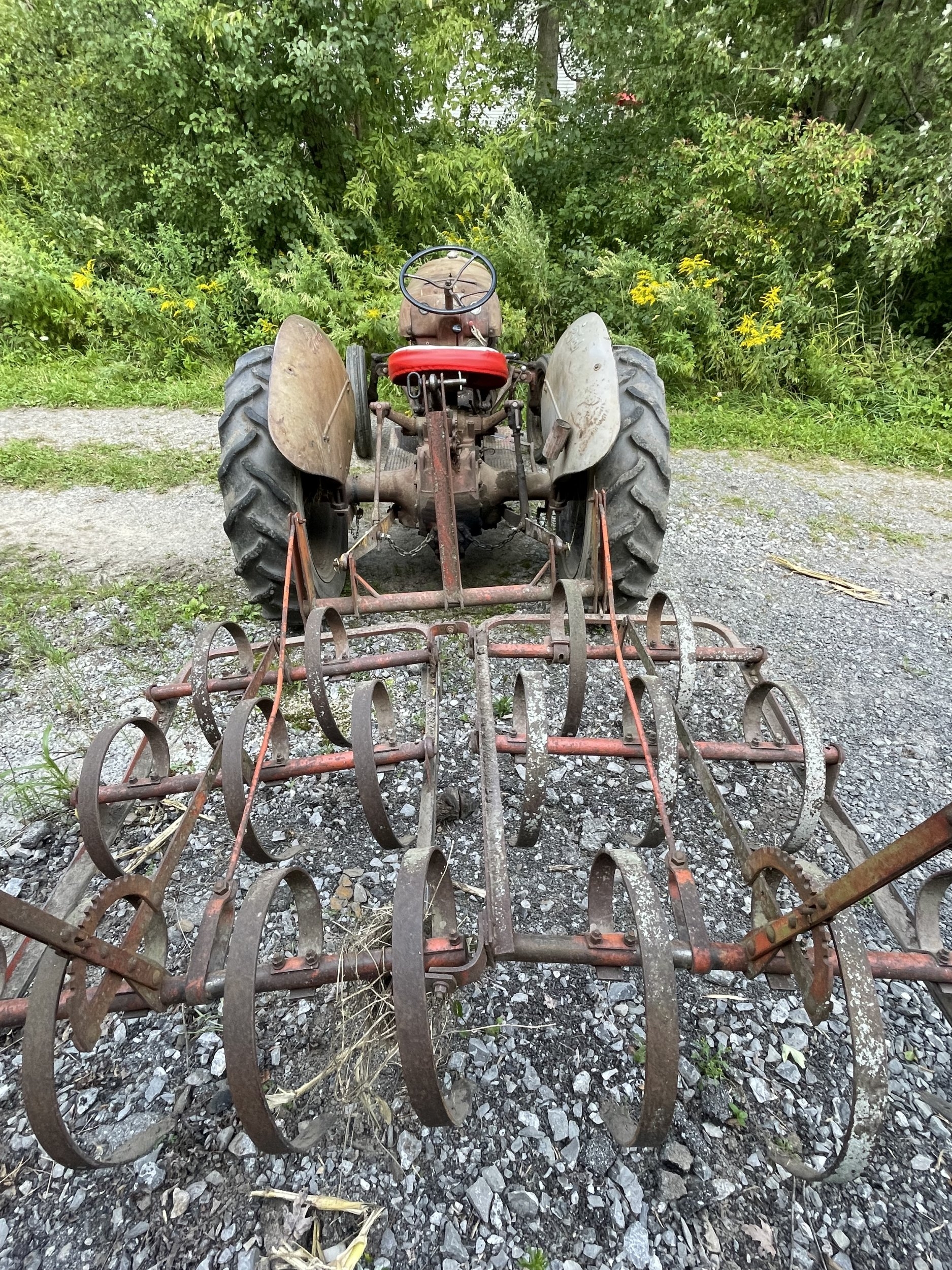

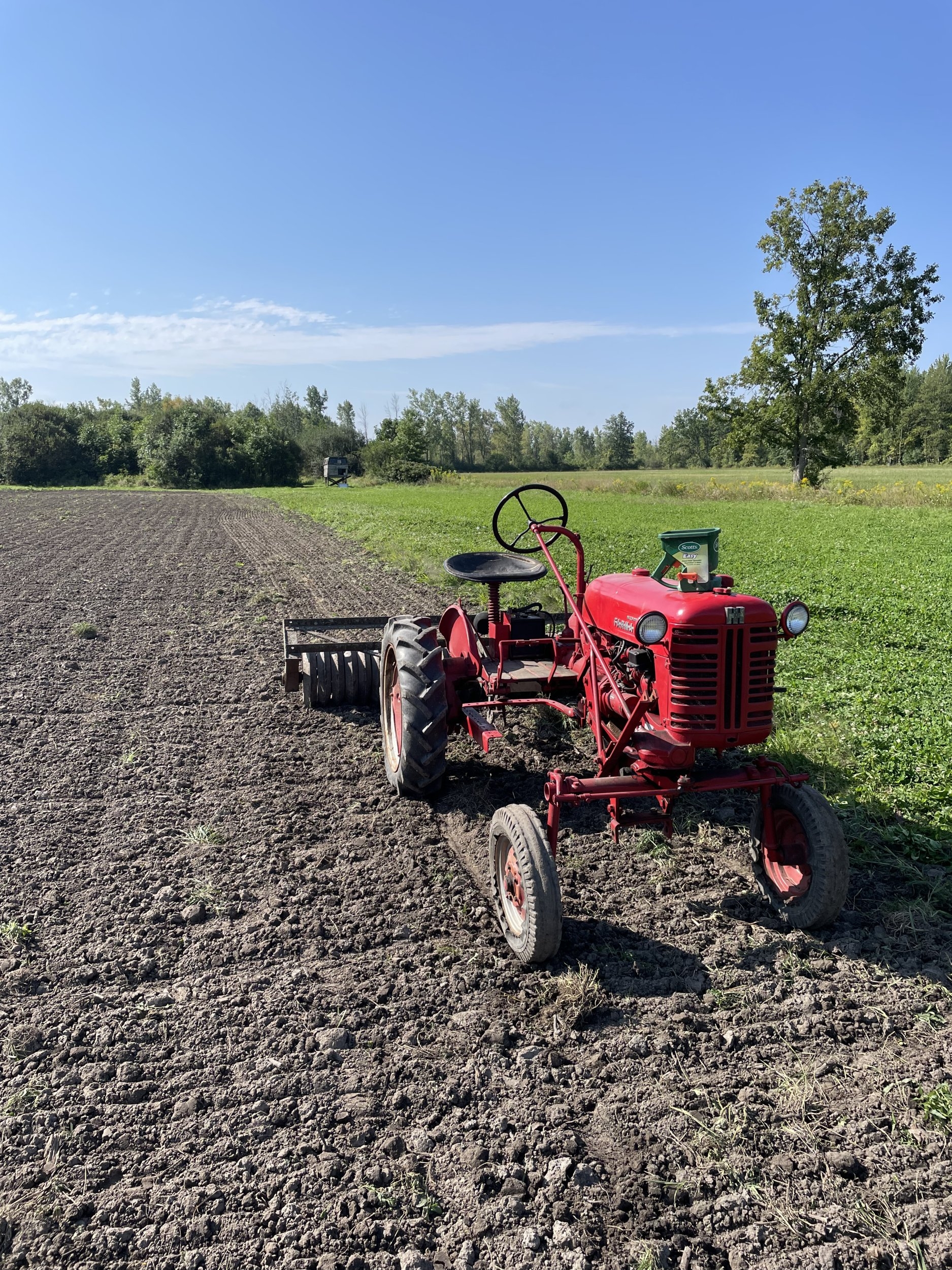

Having worked in factories all of my life, you couldn’t pay me to own a cabbed tractor, after I retire. I love my outside time, on my open station tractors.
The home-made canopy on the JD is a very nice feature for open field work in the summer or in the rain though:
You can see that I am not “color blind” because I run the American “big 3”.
