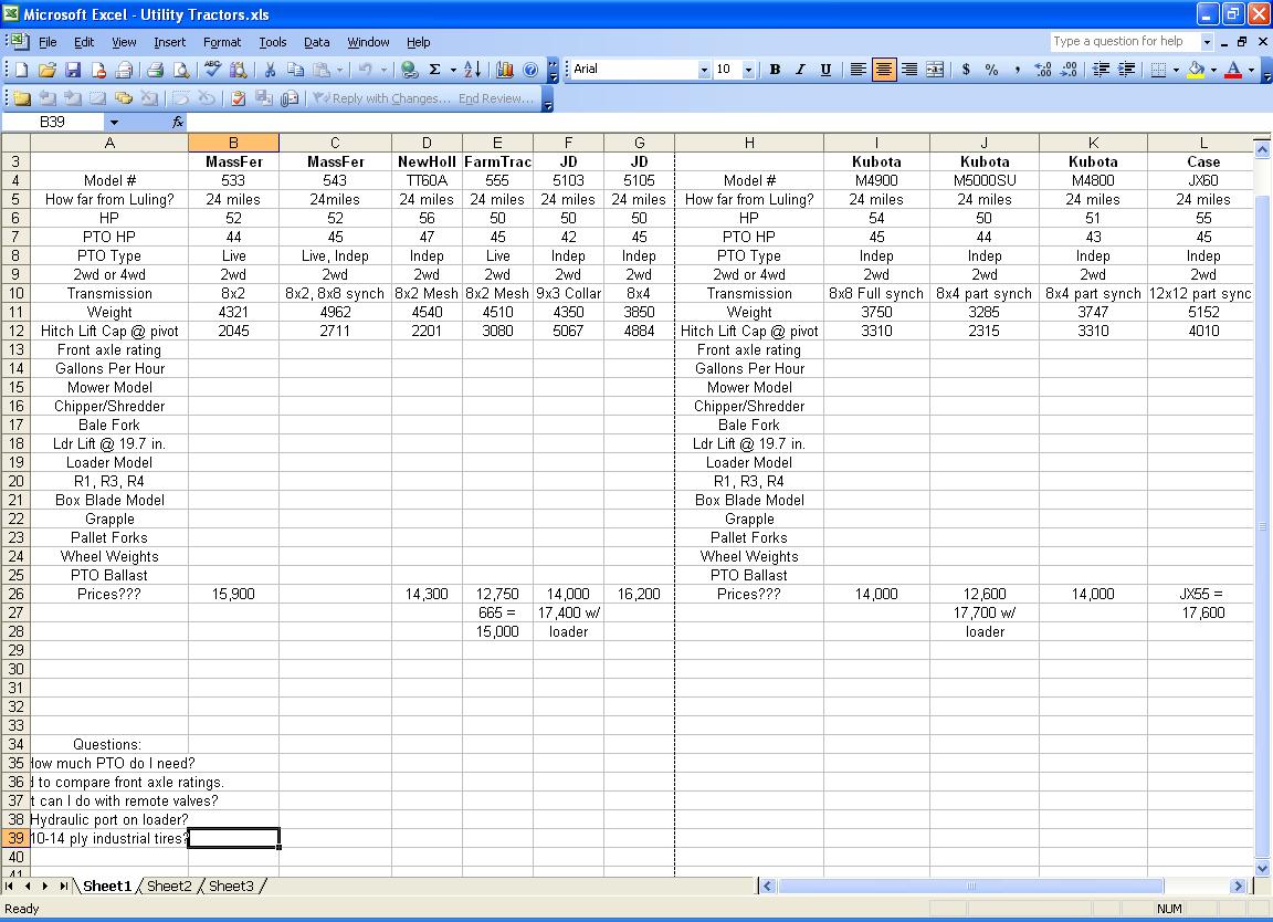

I am going to try to attach my checklist that I created on Excel.
I see now that I can't upload a .xls file. I will try image capture.
