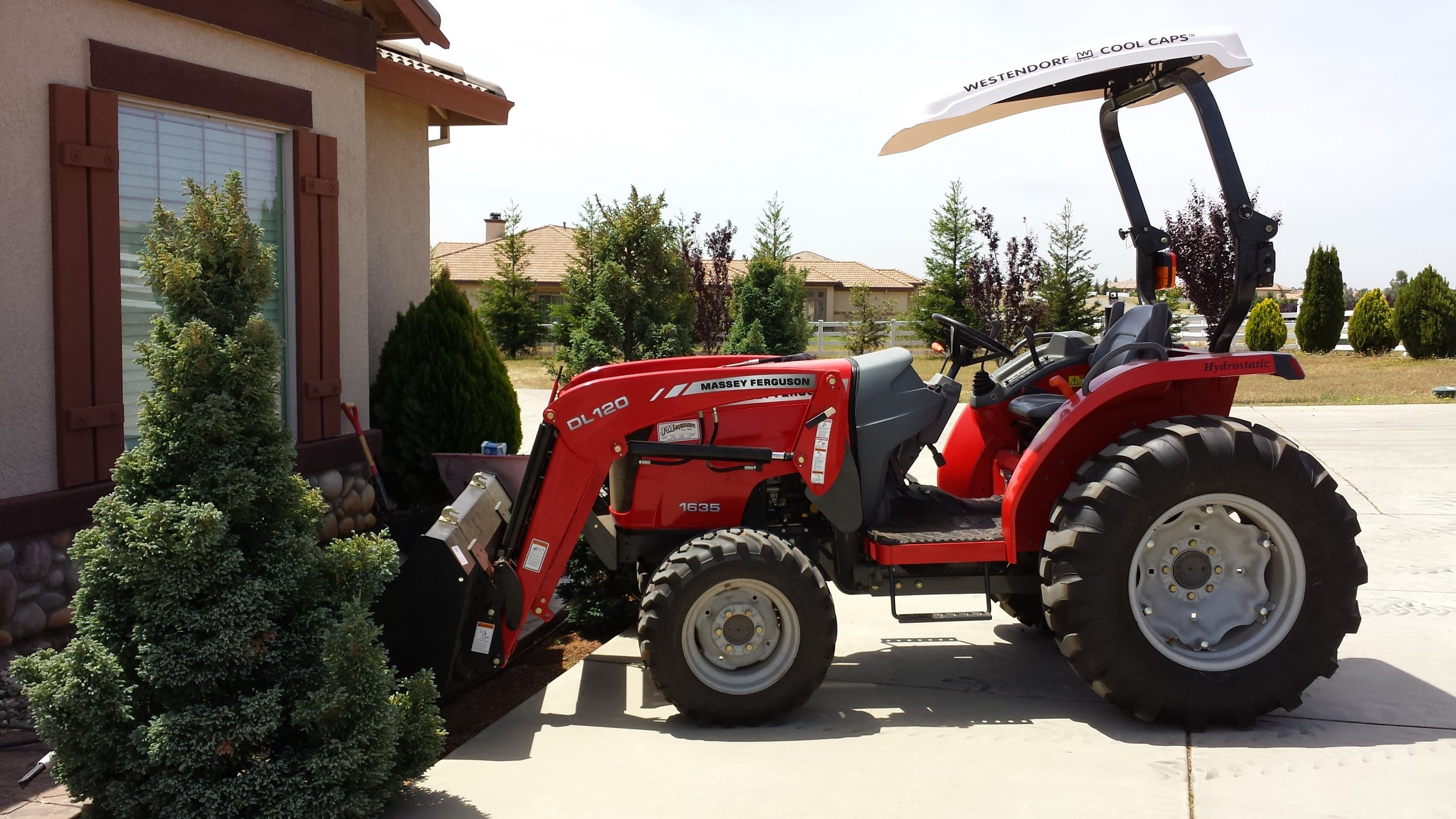

I put a Westendorf on my MF 1635 about 8 years ago and haven't had an isuue

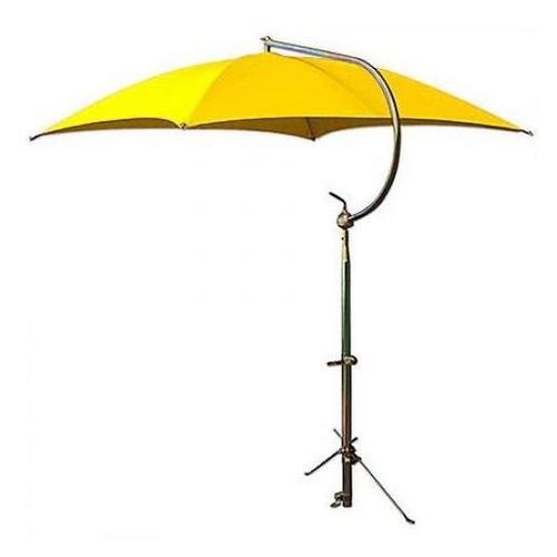

John Deere has been making good tractor umbrellas for about half a century now - I've got one. They are surprisingly well designed and durable. Reasonable price, too. AFAIK, only in JD yellow though....

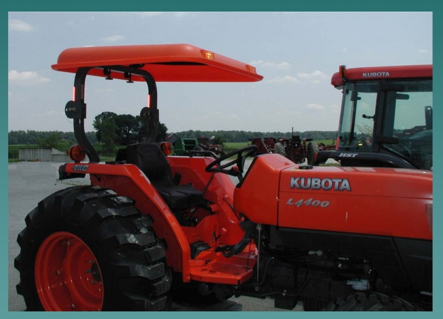

Check out the canopies from Eger Products made in Ohio. I noticed some time ago that Rural King was selling them. I bought two several years ago. One for a 30 HP Kubota and the other is on a 50 HP John Deere. They're really solid, heavy-duty, and have a nice gutter all the way around. (I drilled drain holes in the back corners of mine so the gutter doesn't have standing water in it.
Update -- I just looked and Rural King shows these as not available there anymore. Too bad. Looks like the company still makes them, but not sure about price and shipping. (I picked mine up at their facility near Cincinnati.) Here's a picture from the Eger site.

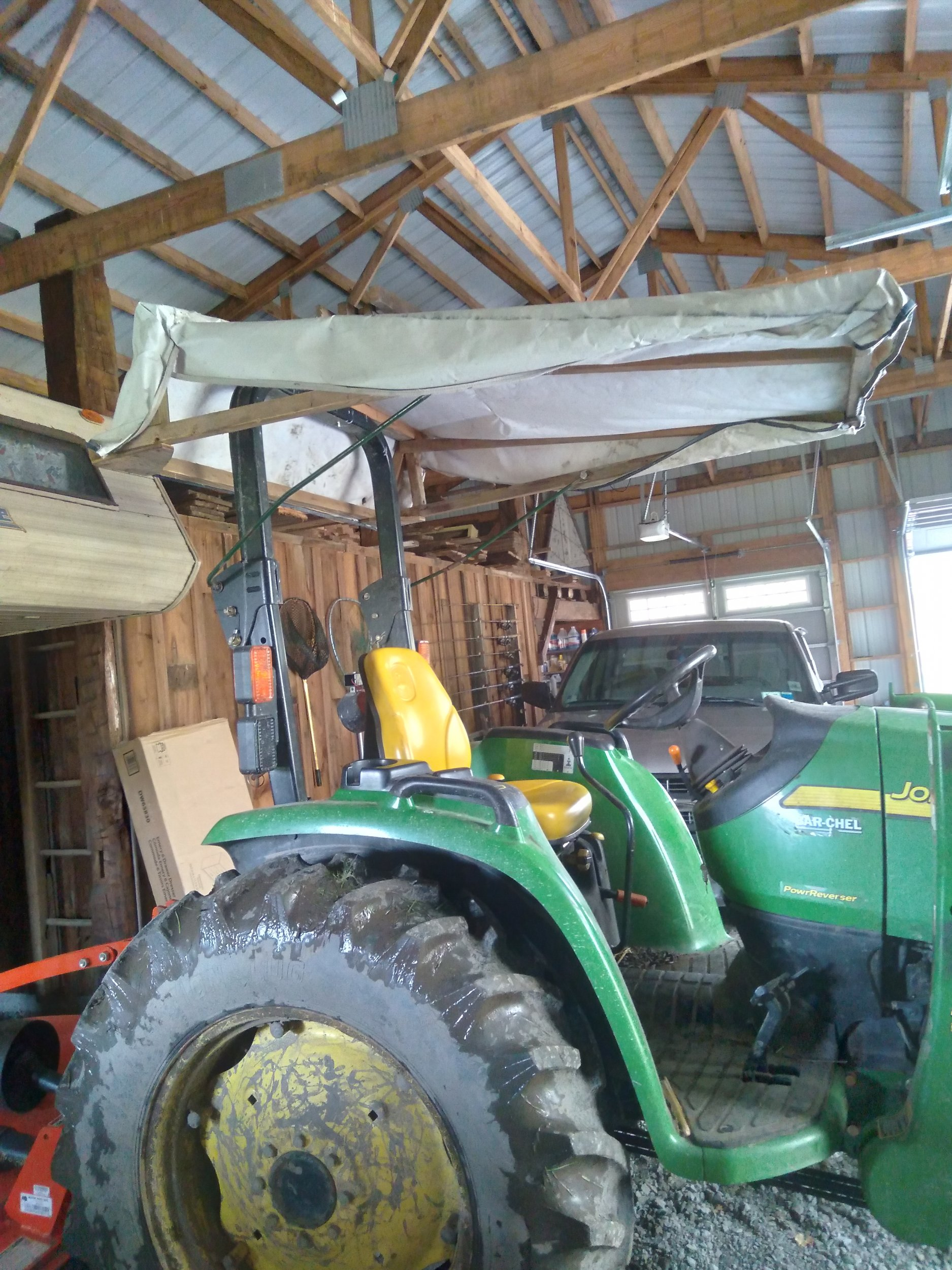

I made this one for my JD 4120 in 2005. It is canvas over a wood frame. It weighs about 40 pounds and can be installed or removed in about 2 minutes. It attaches with two 3/8" bolts drilled thru the top of the rops and two metal diagonal supports at the rops hinge.
I made it from stuff I had laying around, so the materials were free and it took about 2 hours to fabricate. The original canvas (old boat cover) lasted about 10 years. The white canvas on it now is from an old tent camper my brother in law scrapped.
I tapered it towards the front so that it doesn't snag branches, and gave it some depth so that it provides shade when the sun is at an angle. These features, and its light weight and low cost make it significantly better than any factory models I have seen or used.
