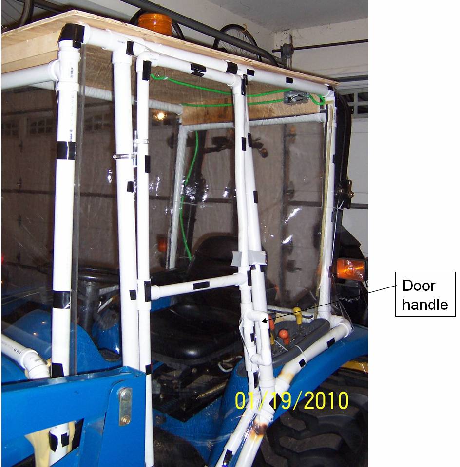

Very nicely done. I've seen others here used copper, but I like the pvc for several reasons. It looks reasonably strudy too, but I'm wondering if you could more firmly anchor it to the top of the ROPS, if it wouldn't be rock-solid. In-fact I was wondering if instead of tie-wrapping to the ROPs, did you consider attaching at least the plywood with something a litte more substantial? How about one of these ideas.
- Extend the plywood a bit closer to the ROPs and tie wrap it up tight though several holes place in the plywook immediately adjacent to the ROPS.
- Extend the plywood on top of the ROPS and drill and tap a couple of small (such as 1/4"-20) holes through the plywood and into the top of the ROPS.
- Drill and tap ROPS on top and extent some sort of metal plate or tabs onto the top of the ROPS
- Build some sort of metal clamp that would go around ROPS (similar to how the ROPS attaches to the axle) and bolt it to the plywood, again extended slightly closer to the ROPS.
Anyway, you did a really nice job. One thing I was wondering though was how did you attached the plastic to the pipes, is it one the inside of the pipes (appears to be) and did you try to use one continuous piece as much as possible other than at the door?

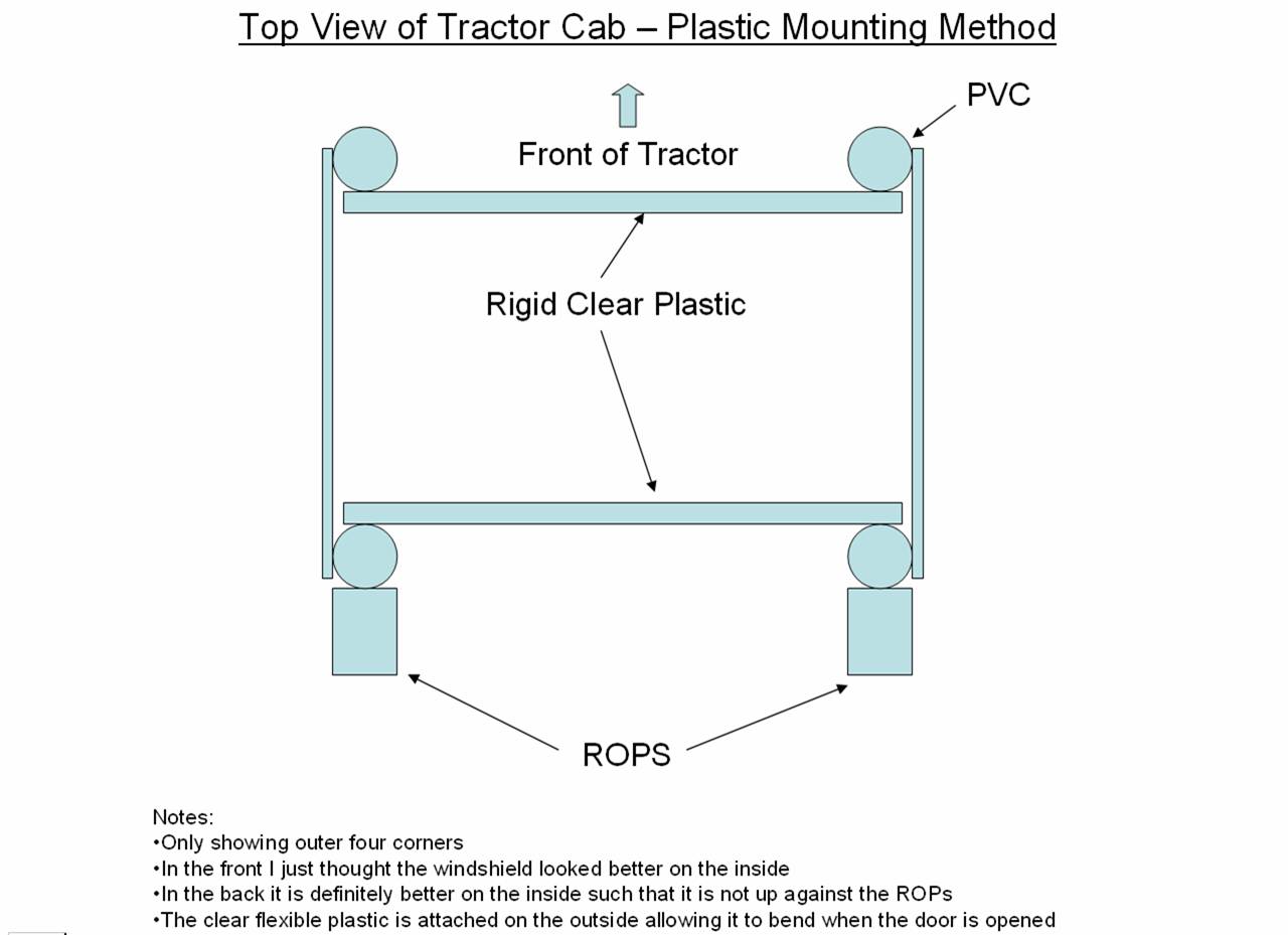

T-nut. That's it. Those will work great. Concerning the suggestions about rigidity - it seems to be very stable with the tie straps. The most vulnerable side is the side opposite of the door. Technically I should put one more piece of 1 1/2" going horizontal about half way down such that the clear sheeting will not act like a sail (although I have had no problems yet even with moderate winds).
The rigid 3/16" clear plastic is on the inside while the clear sheating is on the outside. Not sure why I went on the inside with the rigid plastic...I think it had to do with the fact that screws would be inside leaving a cleaner look. In any case I tried holding it up both ways and went for the inside. For the clear sheet - it seemed better from the outside as winds would compress it against the PVC vs. pushing it away...make sense??
Opinion - the PVC seems stronger than copper in this case...unless you went with really big stuff. I suppose one could fill up the PVC with something if you wanted to be more rigid - foam stuff or something. I filled a 4" pipe with concrete one time using a funnel. It made the basketball support pole solid...literally like a rock.
By the way - I would never drill the ROPS...even with a small bit. Alteration of a safety device would not be recommended due to potential legal technicalities in case of an accident.
So, is there any benefit to having the rigid plastic on the inside (vs not having the rigid plastic there)? I am thinking of making a cab for our B7510 similar to yours but with a Golf Cart roof as the top of the cab (I have one available). It would mainly be something to keep the wind off. If I can direct some of the air that comes past the radiator and engine into the cab to warm it up some that would be a bonus.

The rigid plastic is just easier to look through than the clear plastic sheeting...because it is stable and flat where the plastic sheeting may change shape from one area to the next. Either way - the sheeting will work if all you are trying to do is keep the wind off. Frankly, this project is so easy that if you have the money and time you might as well build it up in a similar manner.
So, what order do you have the plastic layers in?
Is it something like this:
Or does the flexible plastic not go over the windshield?

Take a look at this. No, the clear flexible stuff does not go over the windshied. See my attachment.

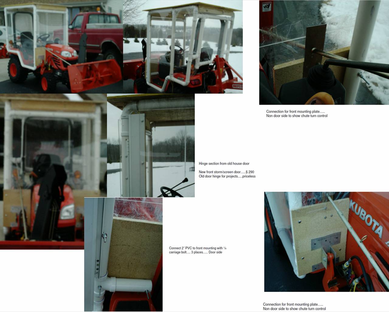

Check this out - now my friend down the street built one for his Kubota!!!

Well - 3 of my friends have now built one or are planning to. The Kubota one is nice and big inside - not cramped at all and is capable in terms of allowing all controls to easily be accessed. He is putting a beacon on too.
