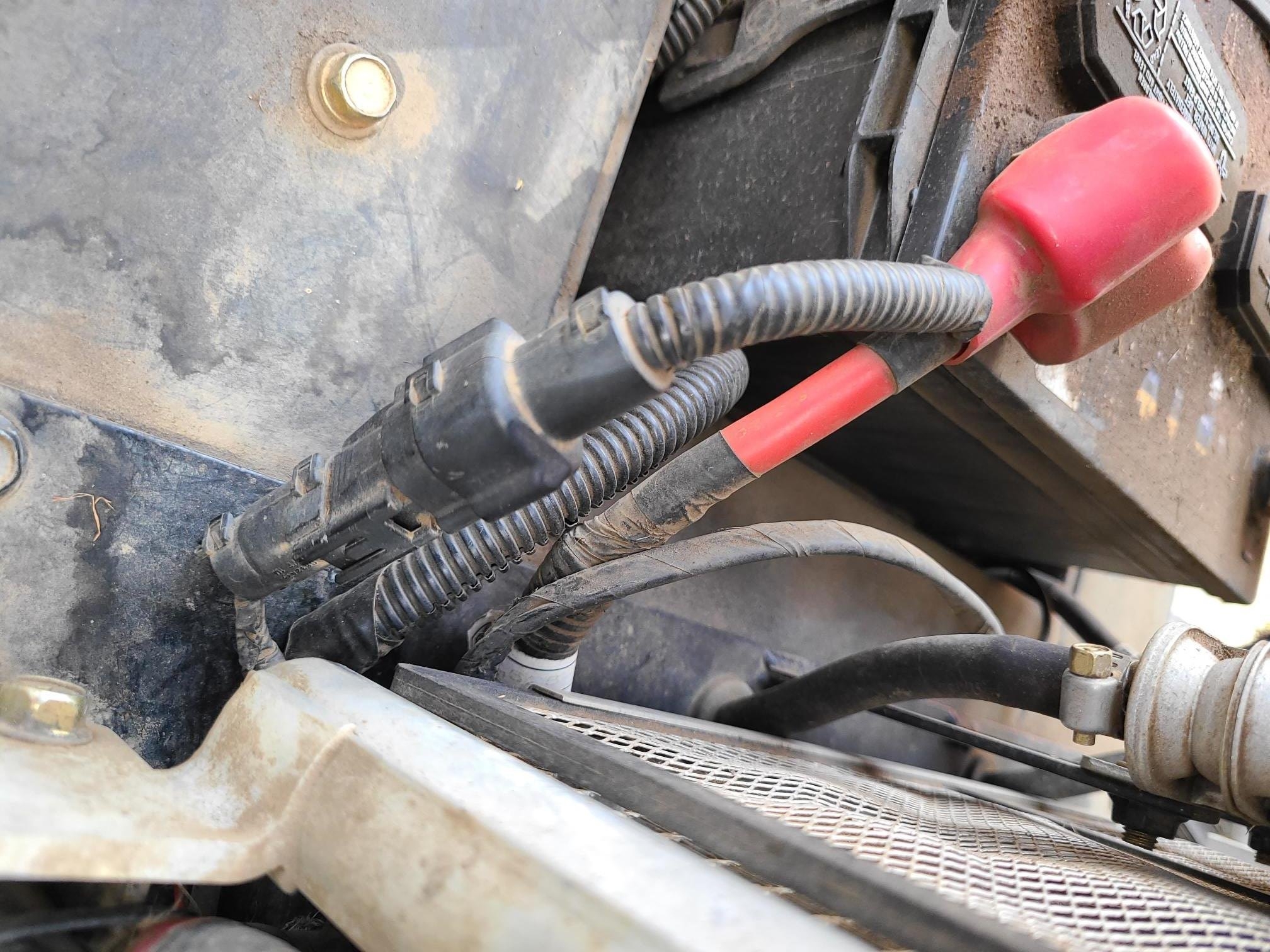

On my Kioti I've got this connector off of the positive side of the battery cable that I discovered is a bit flaky. For the first time ever I went to start the tractor after just having it running and it wouldn't crank, I had NO power to the dash. I found that flexing that connector* area resulted in getting a connection back. You might not be able to mess with wiring and turn the key to start but you should be able use your headlights (or such) to indicate if/when you've found the spot in the wiring that's flaky (headlights controlled through dash power, I'd think/expect).
* Picture of it here:
