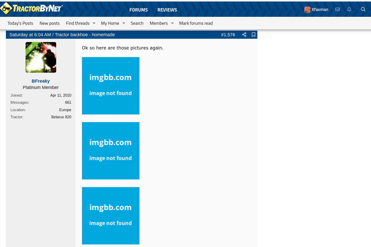

Yep, This is what I get now on pictures that were there Saturday:
The pictures are in Sundays post:
   / Tractor backhoe - homemade
#1,584
I'm not sure why that happened, those are all my pictures, there is no copyright...

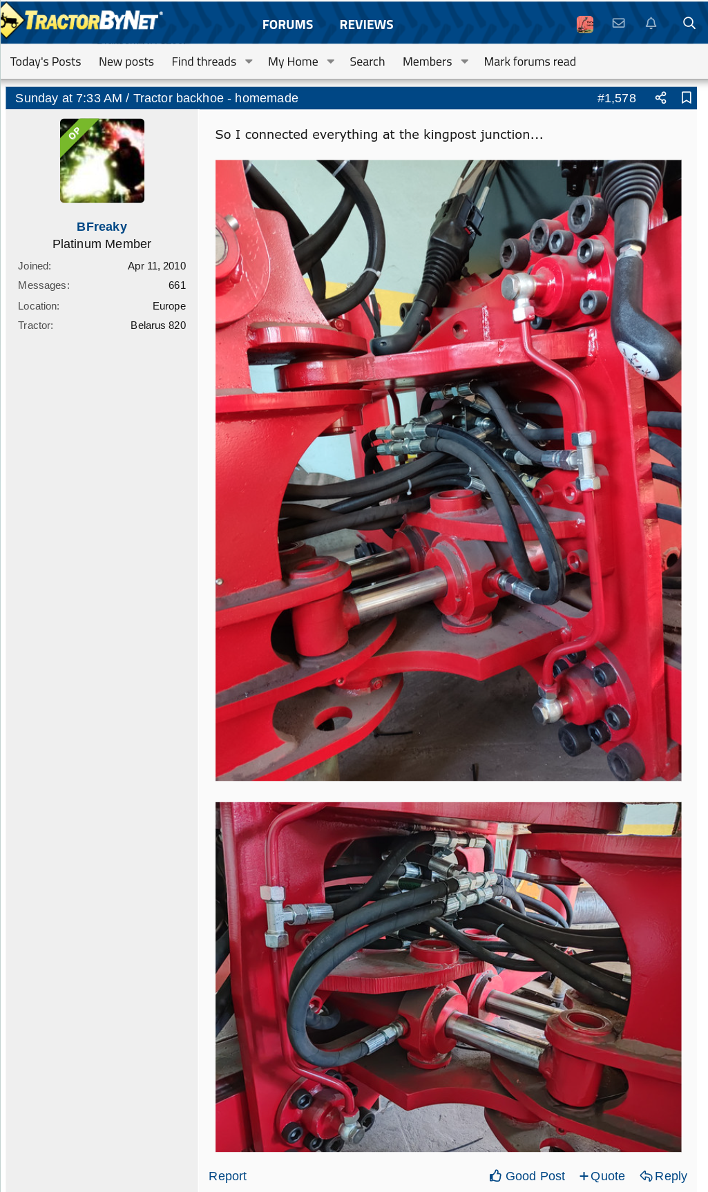

Anyway, I continued working so I made my seat turnable. Belarus has its batteries behind the drivers seat so I had to move them down under the cab. Here are the results. Now I can continue working on joystick mounts etc

Could not manage to lift the machine enough with a small forklift for coupling so I decided to fix the pump in place and use a shaft to turn it from a distance. Stabilizers did the work easily 😁
