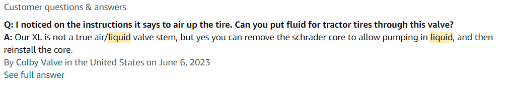

True, not a real liquid stem.
You can just remove the schrader valve, turn the tire to where the stem is at the 12' O clock position, and fill it. Slow but doable. No different than the rubber stems it came with, they just removed the schrader valve to fill.
