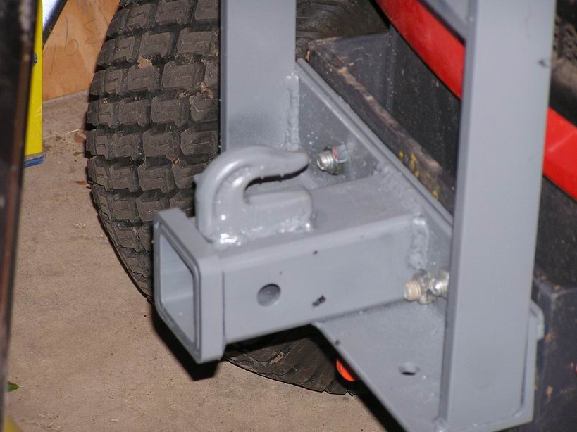

If you guys want to build a front blade, you might want to incorporate something I just did to my grill guard: I welded in a receiver hitch to carry a homemade weight box. If you did that, along with some other mounting hardware up higher for lifting, etc, you might have something that could handle the blade, and handle the stress of hitting a solid object without tearing up your tractor. See the pic of what I did.

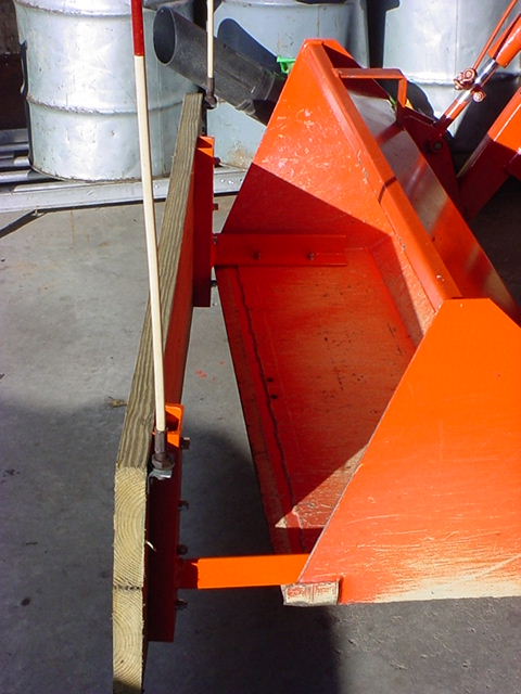

I use this setup for pushing LIGHT snow off of my concrete driveway. I wouldn't want to be ramming snow plow piles with it, but it works great for fresh snow. I "fixed" it to the angle I have to push my drive off. When the bottom 2X8 flakes out, I reverse it, then change it. Very fast and cheap.
