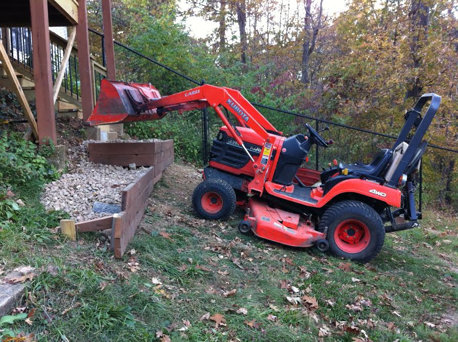

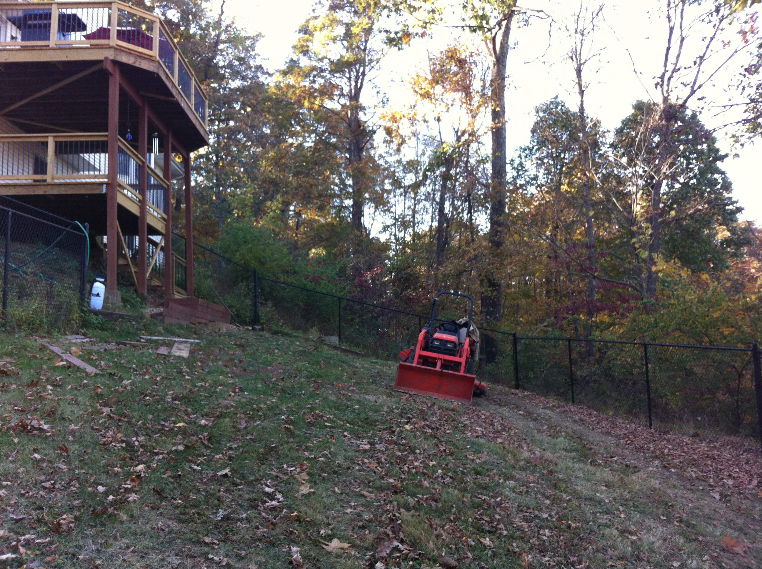

I'm still fairly new with this tractor (BX2200), but this was some good learning experience. Bringing up about 3 yards of gravel on this side hill was slow going. Dumping up the hill was easy, but traversing got the pucker factor up, both loaded and unloaded. I really need to get more counter weights on the back besides filled tires. Our 5 acres is all like this, so there is never any time to relax.

Agree you need some counter weight for most fel work. I would also be concerned with the bulkhead holding up in your picture. Looks like it needs more support imo.
   / Tractor and Slopes #38
Would wheel weights (50 lbs) do any good, or do I just need to hang my loaded carryall off the back?
I agree the picture of the wall looks suspect- but it's just the photo angle. However, I've got 4' driven piles with pre-stressed tiebacks hidden under the gravel- the end piece is only temporary. The facing is reclaimed cedar. It's quite solid.
Much better to use the carry all or other 3ph implement for two reasons, one it is easy to remove for mowing and second it reduces the load on the front axle.
Good to hear that there is more structure than is shown in the picture.
