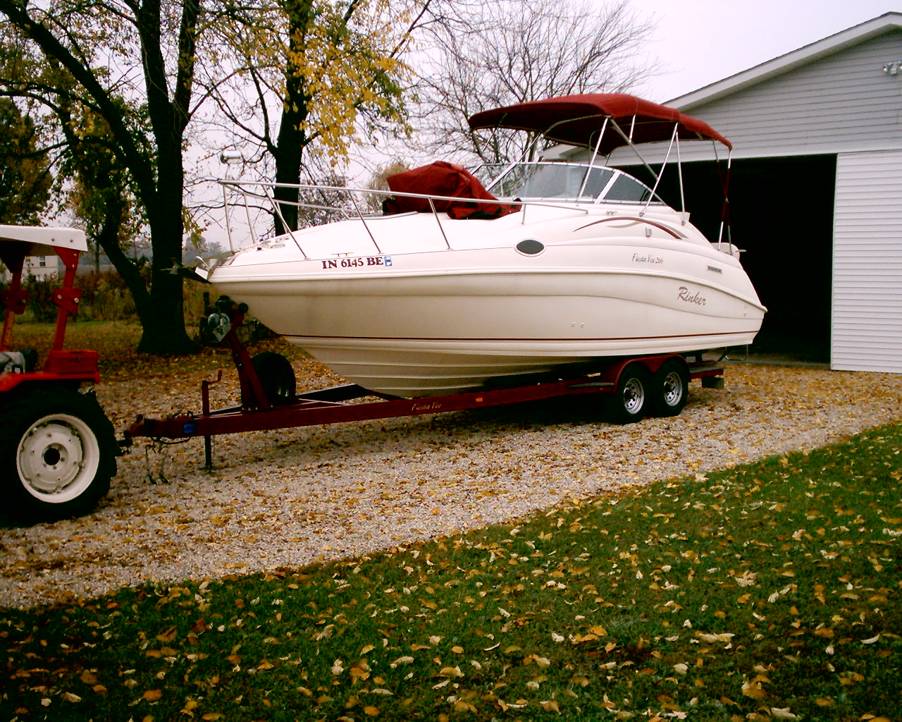

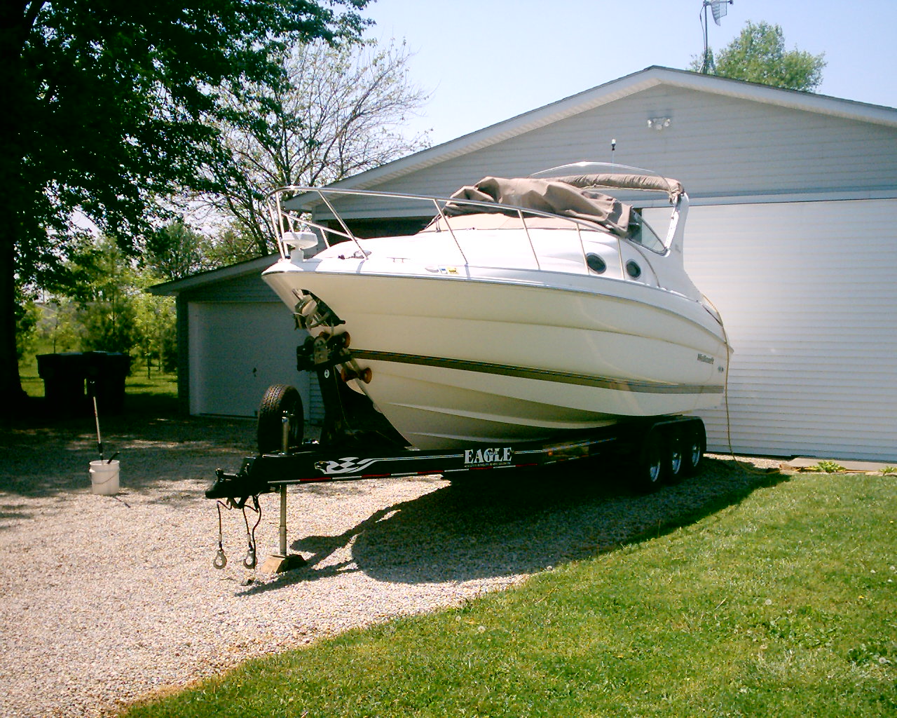

I would guess there would be 3,500# to 4,000# of tongue weight on the trailer but should be no issue for him and that rig. I pull my boat with my 28hp Jinma and it has 1,800# of tongue weight.
First pic is the tractor pulling a 10,000# boat with about 1,000# of tongue weight. I do not have one with the big boat on the back but my FEL will not lift the tongue while the 3 point has no issue. It weighs 15,600# and has 1,800# on the tongue.

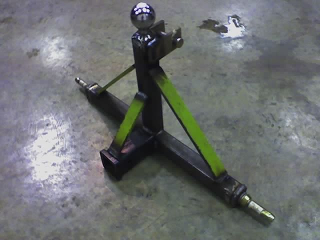

I made this one for my camper and flat bed. The camper is all it wants and I have never moved the flat bed with a load. I don't know how what kind of tractor you have but I think I would want a catagory III tractor before taking that much weight off road.
