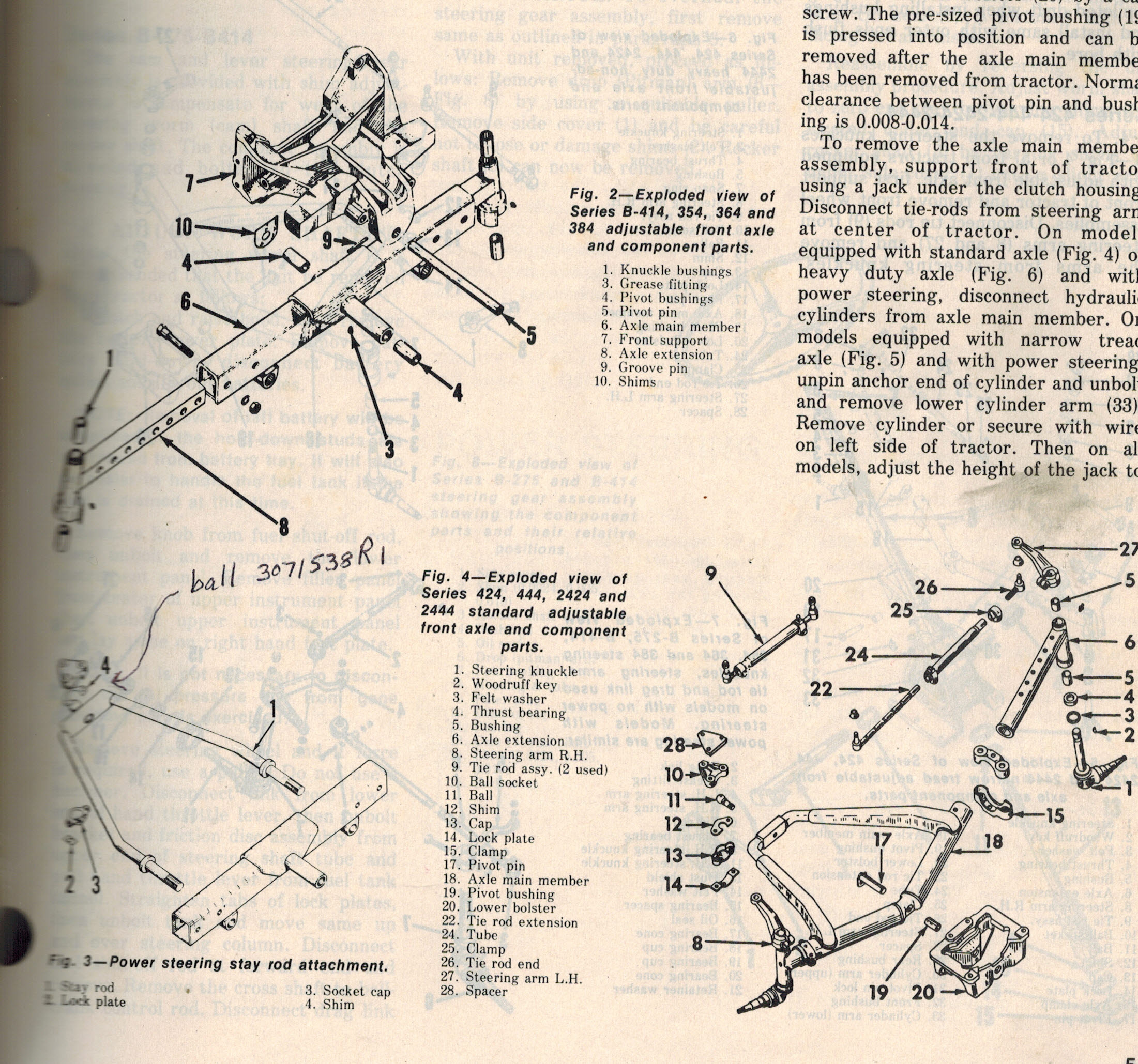

Don't forget a Canadian IH 444 is the same as an American IH 354.
   / Tractor 1970 international 444 #34
Actually I didn't realize that so thanks. Will go to tractor data and look up. I have been thinking was a 444.
   / Tractor 1970 international 444 #35
Coming along very well, now that you have it running and rolling would be worth changing all fluids and filters if not already done.
   / Tractor 1970 international 444 #36
I don't know what the people at IH could have been thinking when they assigned numbers to their different models. It can be very confusing. I used to think the parts guys at the nearest IH dealer were extremely incompetent because when I would ask for parts for my 444 they would usually give me incorrect items. I finally twigged that their parts books and computer parts software are American and that a Canadian IH 444 is the same as an American IH 354 and NOT the same as an American IH 444! Here is a copy of a page of an I&T service manual. My Canadian 444 has the front axle shown in Fig. 2 while Joe TX's American 444 has the one shown in Fig.4.
   / Tractor 1970 international 444 #37
Thanks. That is very helpful. Will check on mine later today..
