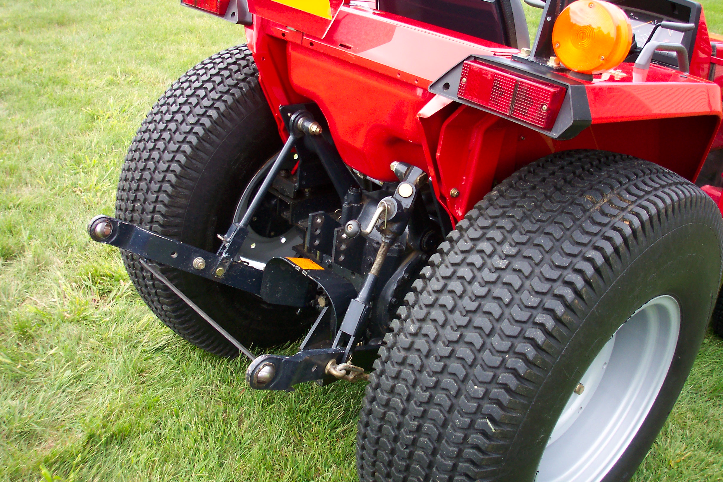

/ Traction with Turf Tires #4
I have run turf tires for the last 17 years on tractors from 30 to 54 hp. All tractors were 4wd. I have plowed, dug, mowed, box bladed, dragged, lots of loader work, etc,..... I've used in deep snow and mud. Some rear tires were loaded, some were not. Would R1 or R4 tires have given me more traction? Absolutely!!! Was I able to do what I wanted and needed to do with turf tires? Yes. IMHO, with turf tires you need to be more careful and may require more planning to do something. I have a couple of large asphalt driveways and 5 acres of finished lawn. I've demo'ed R4 tires on tractors a couple of times and they are more destructive than the turf tires. However, turf tires not used carefully will also tear stuff up. The first picture is of my current tractor with baby bush hog behind it. The these turf tires are excellent for snow plowing! The 2nd picture is of loaded turf tires that I had on a Massey 1240. They worked pretty good, also.
