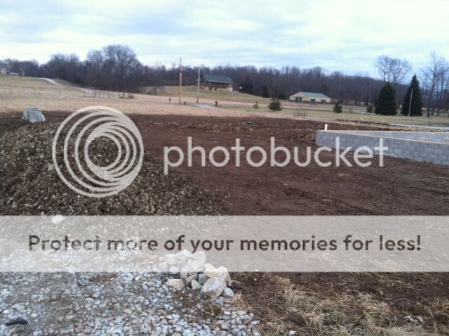

Waiting is not an option... The house will ship when the house ships, and the piles of gravel are where the house will need to go. It HAS to be spread within the next week. I think I am going to give the backhoe a try tomorrow.
This stuff is always going to be to thick for a FEL, or backbox. Its crushed gravel with the fines and the larger base gravel all mixed together and wet. It has the consistency of very heavy clay... It being wet actually helps it break apart easier than it did when the last pile I spread was dry. The bobcat then had no problem with it.
The gravel is also going onto virgin ground so it shouldn't sink in to much. I know ill get some major ruts when the heavy equipment gets here, but that's going to happen no matter what.

If the pile is hard,use the backhoe to loosen it up.
Then use the loader to shove the gravel around.
Don't get down in the mud, stay up on the gravel while you shove it around with the loader.

This was broken up by a backhoe yesterday and loaded and dumped yesterday... I cannot possibly make it any looser than it is. The ability to shove it around with the loader is minimal when I can only get traction on existing compacted base.
/ Traction issues #24
Sounds like to save your anxiety it's worth hiring a tracked skid steer. Don't expect too awful much, as that froze/thawed goop will be under it. #2 for staying away from the block foundation.
Cant tell if that's a frost wall or cellar. If cellar, I trust you have porous material around the wall, and dampproofing on it? If not I would dig around your wall and seal it right, then get some stone or gravel for backfill. If its a damp site you'll kick yourself forever otherwise. 40 year contractor advice. I know, last thing you want to hear.

Its not a damp site normal conditions. When I had the gravel delivered I thought I had 3-5 weeks to get it spread. I got an email that said the house was finished and they would be delivering it (modular so two 15x68 halves) possibly next week. The piles of gravel are blocking access to where they need to place the two halves to allow the crane to set up right where the gravel is going to be spread.
That is the foundation for the house, its on a crawspace. Not sure what you guys mean by stay away from it.... the gravel will be going right up to it.

No... in order to pull it off the top I would have to be in the wet area...
Its not of anymore concern. Apparently they are bringing the house Monday. That leaves me tomorrow, and sunday to get it done and it HAS to be cleared for the houses to have a place to go. So I am biting the bullet and paying someone 200 dollars to come and spread it tomorrow morning. I also ordered an extra 24 tons of gravel to make sure it was thick enough. Since he will have the track loader I might have him dress up the front of the drive a bit as well because I know the wheels of the house are going to go over the freshly laid gravel and I want to build it up a bit. I have him for 2.5 hours regardless.
