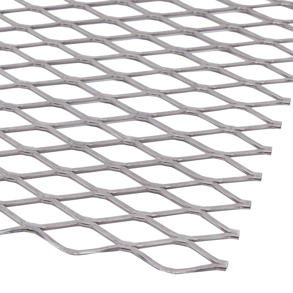

I have had the Trac Vac 580 now for nearly 20 years.
Mods include:
- Replacing the top flimsy screens with "expanded metal mesh grid" from HD,
- Then the acorns and sticks poked holes in the vac drum I lined it with UHMW 1/16" x4" x48" inserted inside the drum then secured in with scews/lock nuts.
- Dumping/back door and reattach issue: The "dumping action" bent the back door bottom angle iron not allowing the door to be reinstalled easily So I straightened the bottom L steel angle then attached a 2x4 PT under the bottom frame to take the abuse of dumping heavy loads - no more fighting reattaching the back door!
- Discharge Chute to Trailer Connection: The metal clasp connection eventually breaks - I riveted a clasp on the pipe and hook on the trailer pipe that flips up for easy connection/reconnection.

Hey Carl_NH,
The expanded metal like this,
