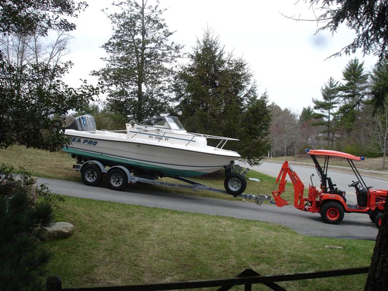

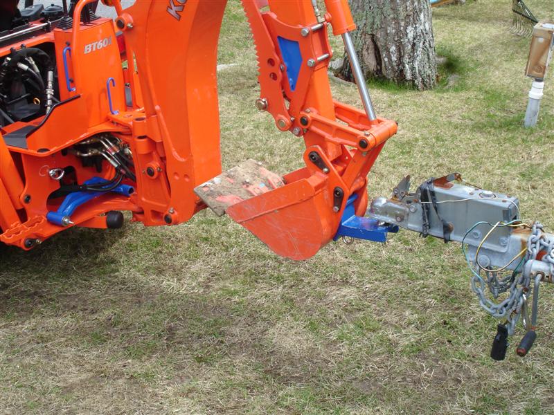

TG: Can be done, but on some backhoes (such as mine) a heavy lateral push on the boom can swing it left or right - hydraulic stops get over ridden by the force. Also a heavy rearward pull on the dipper stick can override it also - you can imagine how I figured both out. Solution was to limit the movement of both with chains - benefit is the chains take the stress and not your hydraulics + no "surprise overrides"

achinbac, like your name. Thanks for the info, how did you attach your hitch, it looks like a slick setup, I assume it comes off for digging?
