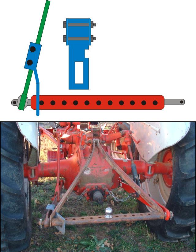

I will be connecting a ball to my drawbar for towing a small trailer with my 8N. I realize the drawbar will tilt slightly without something to stop it from rotating. However it seems that the rotation would be limited as once the ball is connected to the trailer, the connection would limit the movement.
Is it possible to use this setup without a special device to prevent rotation of the drawbar? Anyone had experience with this?

Hi John. It would be best if you stabilized the drawbar. Having the pulling and downforce on the hitching mechanism would be looking for problems.
/ Towing with a Ball and Drawbar #3
John, I'm quite confident that the stress of doing it that way will damage the trailer hitch coupler. You can buy a drawbar lock for that purpose from several places.
/ Towing with a Ball and Drawbar #4
Bird, here's the drawbar stay and some details of the mounting that show how it should be attached with the lift arm stays also attached. The slot in the drawbar stay fits around the lift arm stay (see attachment). /forums/images/graemlins/cool.gif

You are asking for trouble in 2 ways.
1, the drawbar can rotate enough to rip a ball out of a cheap/older hitch.
2, the 3pt arms can float up when you try to stop making some weird geometry.
You can get drawbar stays to keep your 11 hole drawbar down, and drawbar locks are easy to make to keep the drawbar from rotating. I've made 2 from scrap metal and a few minutes of welding.
If you have the under fiffy drawbar bracket, you can use the generic TSC drawbar with yor 11 hole drawbar, with a few bits of hardware for support.
To give you an idea of just how cheap/easy it is to make a 'junkyard-scratch built drawbar lock, her eis a pic of one I buzzed together using a piece of rebar, and two scraps of steel I-Beam, and a 'D' bolt, and a regular nut and bolt.. Took 5 minutes to make.. The one ibeam section 'd' bolts around the lift arm, and the other ibeam section has a bolt welded to it that goes thru the 11 hole drawbar, then gets a washer and nut. Takes 1 minutes to install. This one pulled my 16' trailer on a hay ride last year. This year I made a nicer one out of some 1/4 flat stock. and washers/ears/tabs.

You are exactly right, Sherpa. The reason for the stays is to lock the arms into position so they will not move. Many of us have towed an old trailer with a split tongue which fits over & under the drawbar. That's how trailers were made before trailer balls became popular. With those trailers, you didn't have to worry about the drawbar rotating, but if you started too quickly or got a load too far back on the trailer, the tongue would just raise the lift arms since the lift cylinder is single-acting. To prevent this unstable situation, the lift-arm stays were invented.
If you look at my photo again, you will see that the stays are slightly bent. That happens when someone forgets they are attached and raises the 3PH. /forums/images/graemlins/blush.gif You have to use your "noodles" when the stays are attached. On the other hand, they hold the lift arms so they won't flop around. They are also two-piece assemblies, making them adjustable in length. This allows the drawbar to be set at different heights for different trailer applications. I suspect the old Ford tractors have pulled lots of drawbar towed implements with varied height requirements.
If you forget and raise the lift, most likely the pressure relief valve will open and save the lift arms from looking like doglegs. That was the case in the old Fords where the 3PH maximum lift was 2000#. I wouldn't recommend the stays on a newer tractor unless they were "beefed up" quite a bit. /forums/images/graemlins/smile.gif
