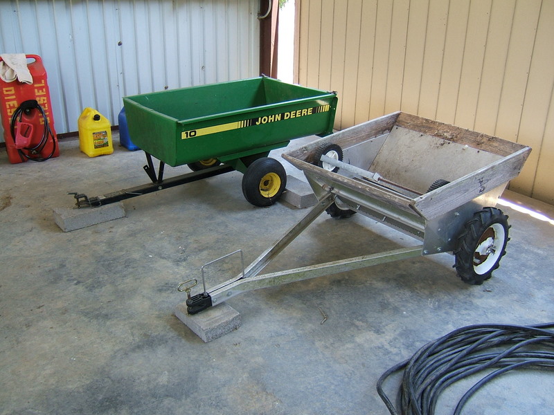

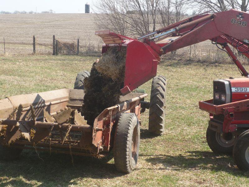

Since the OP didn't specify what kind of manure spreader it might be, your blanket statement may be off the mark. I have a manure spreader that would definitely not be highway towable. It's designed to be pulled behind a tractor. It has no lights, no plate, no safety chains and there is nothing about it that would make me assume it is street worthy. There may be spreaders that are designed to be towed, but mine ain't one.
I would trailer it.
/ Towing manure spreader #12
I would trailer it.
Off the mark, huh? :confused:
Unless it was designed to be pulled by horses what other than a tractor would it be used with? That certainly doesn't mean it can't be towed by a truck on the road. A log chain is all you need for a safety chain, plates LOL, lights are easy if that is a concern.
The OP specifies a single axle and not very big so I do have a pretty good idea of what he is talking about.
Please post a picture of your spreader that isn't highway towable.
Here is a picture of one I helped my FIL bring home from an auction ~50 miles away.

My manure spreader is a little bitty baby compared to yours. And I think you can see it wasn't designed to be towed on a hwy. We have no idea if the OP was talking about something my size, your size, or other.
/ Towing manure spreader #14
What do you pull that with. A pedal tractor?
If I bought one of those at an auction I wouldn't tow it or trailer it. I would just put it the trunk.
I guess I was giving the OP a little credit by assuming he wasn't asking about pulling a "spreader" like yours behind a pickup at 60 mph.
I talked to a guy about one of those that he had advertised on Craiglist the other day. I knew it was small, but when he said we didn't need a tractor to set it up in a p/u bed that he and I could lift it easily I knew it was even smaller than I thought and too small for me.
#17
LOL! Duffster - a spreader about the size in your picture is what I am looking for - anywhere from 130 to 200 bushels. I feel better now. Sounds like I am good to go if I find one around ~50 miles or so. I'll take the back roads.
