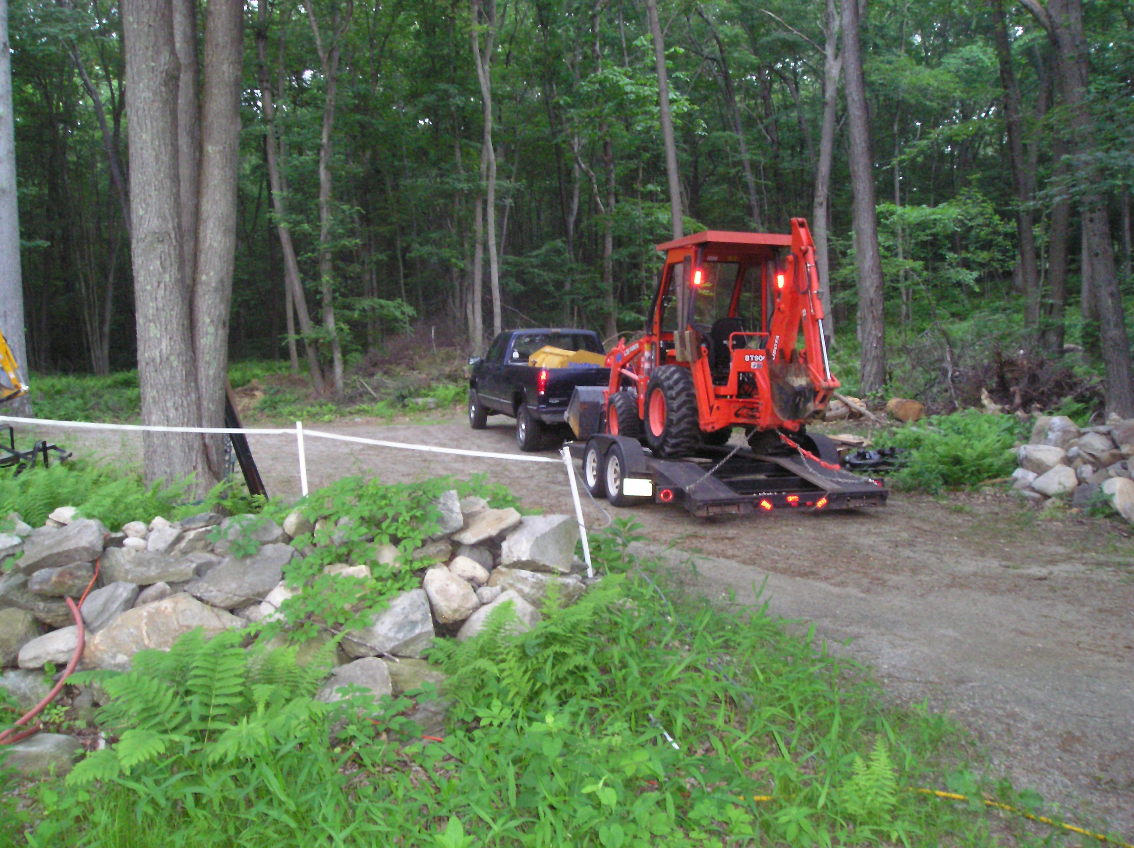

I towed mine from MD to CT with my K2500 GMC on a 16 foot 7k trailer. If I had another choice it would be with a 20 foot 10k trailer..but what I own is what I used.....as a added note.. the loader bucket wieghs about 250 lbs and the backhoe bucket less than a hundred..
My L35 is fitted with a curtis cab and has SSQA FEL and QA backhoe bucket, so it weighs a few hundred pounds more than a stock unit. The trailer didn't complain.

Nice L-35. Here was mine. Tough little bugger.
