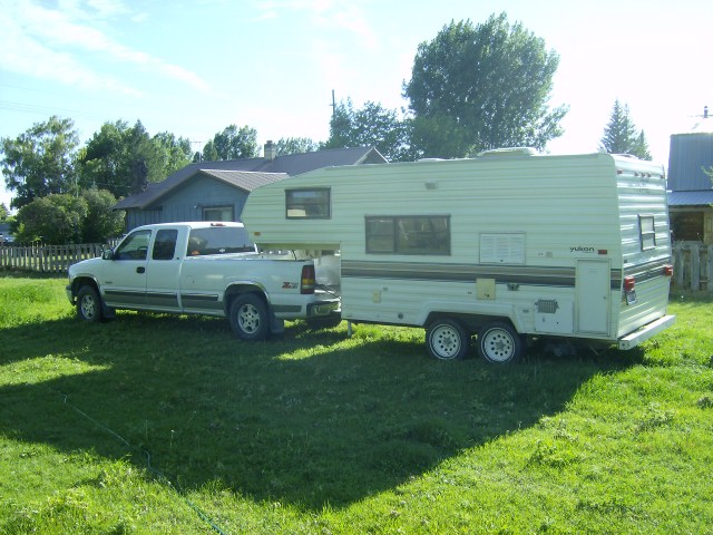

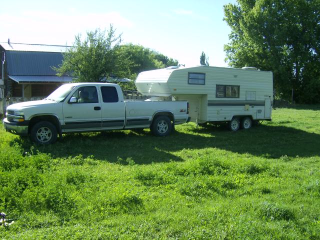

details? 2700lb and fifth wheel dont go together unless your talking about PIN weight...
Seriously. It's a tiny little 17 ft. fifth wheel trailer. It's a 1989 Fleetwood Yukon. We got it for a song, and it's in pretty good shape. The 2700 pounds is dry weight the day I brought it home based on the scale at work. It's a double axle. It fits my family of 5 beautifully, and the truck hardly knows it's back there.
I'm going camping this weekend with the family. I'll see if I can get some pictures to post.

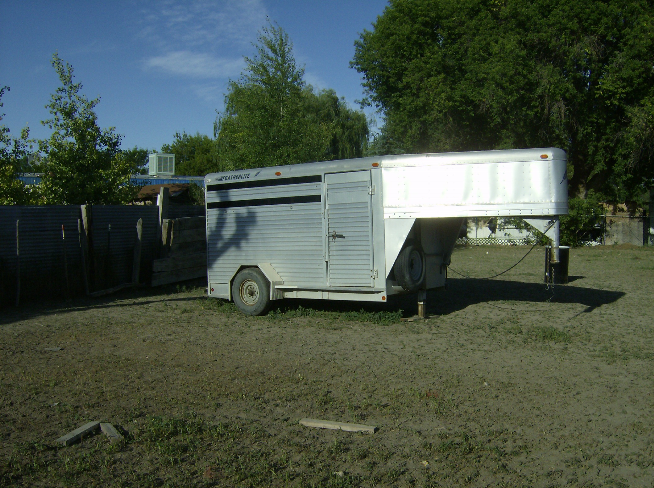

You should see my horse trailer. It's a single axle gooseneck featherlite two horse trailer.

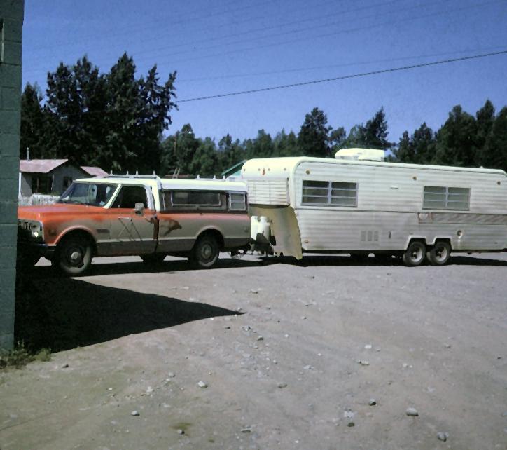

The trailer in the picture, 1972 Holiday Vacationer, was called a 24RB (24' rear bath), but it was actually about 25' 3" in overall length. I don't remember exactly, but I think dry weight was about 4,400 pounds, although it was leaded pretty heavy since we lived in it for 3 months. That's a 1971 3/4 ton Chevy with a 350 cu. in. engine and the picture was at a car wash in Anchorage when we arrive there in July 1972 (about a thousand miles of dirt and gravel roads:laughing:).

I moved my trailer over to the driveway tonight so my wife can clean it and pack tomorrow. I took pictures since I had it hooked up anyway. I'm also throwing in a picture of my little horse trailer. I should clarify that the horse trailer actually belongs to my neighboor, but it's on permanent loan to me.
