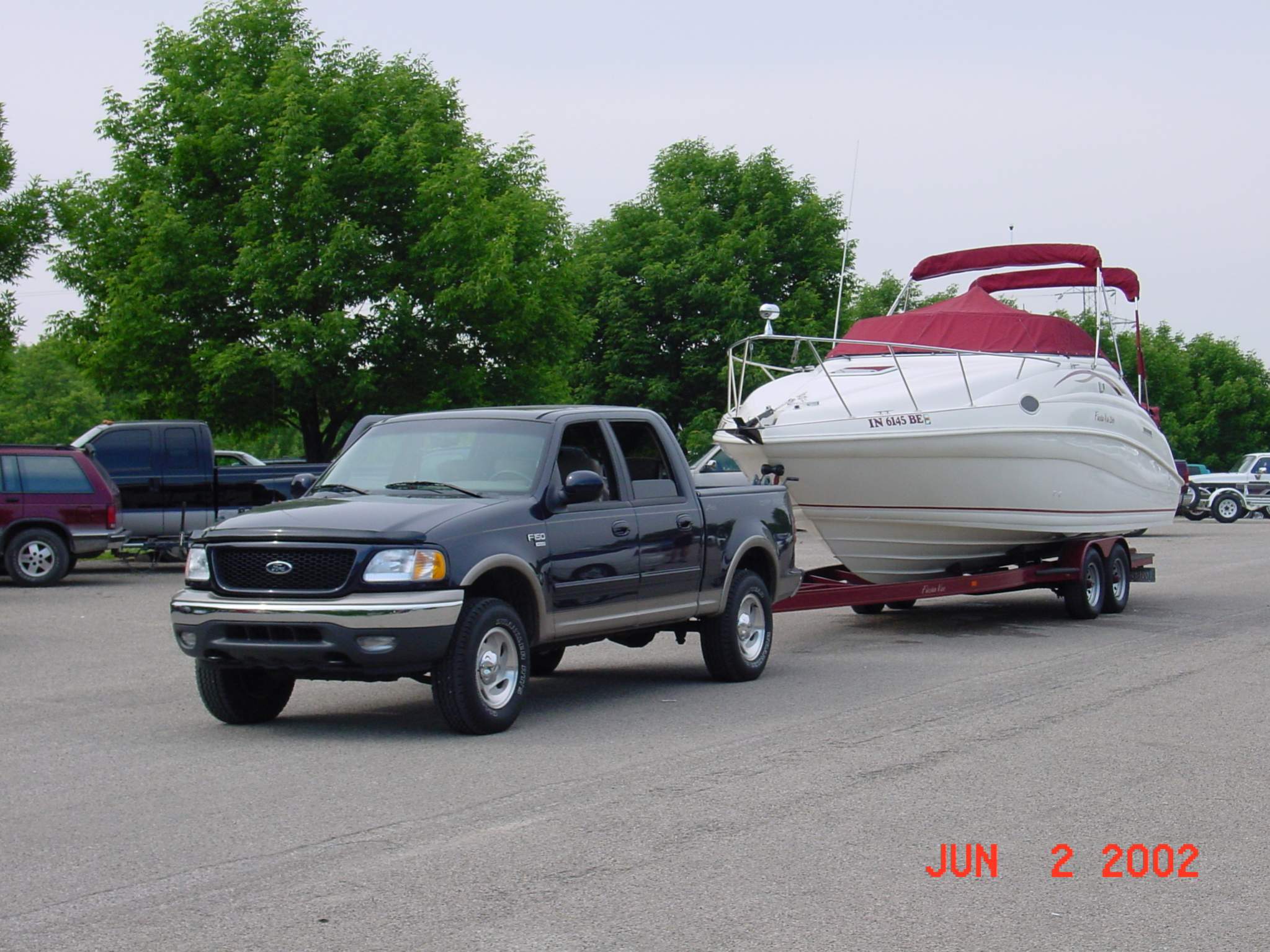

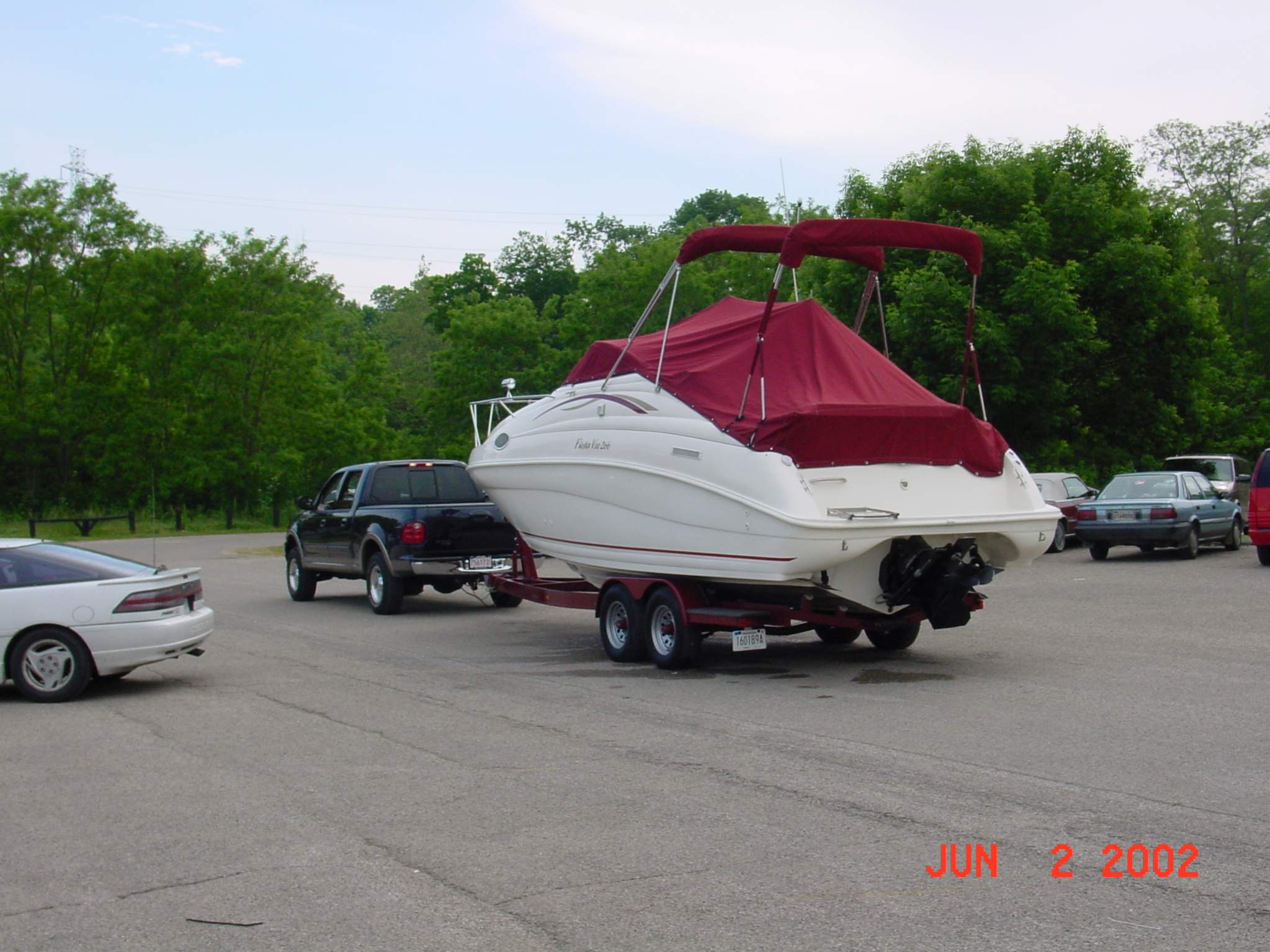

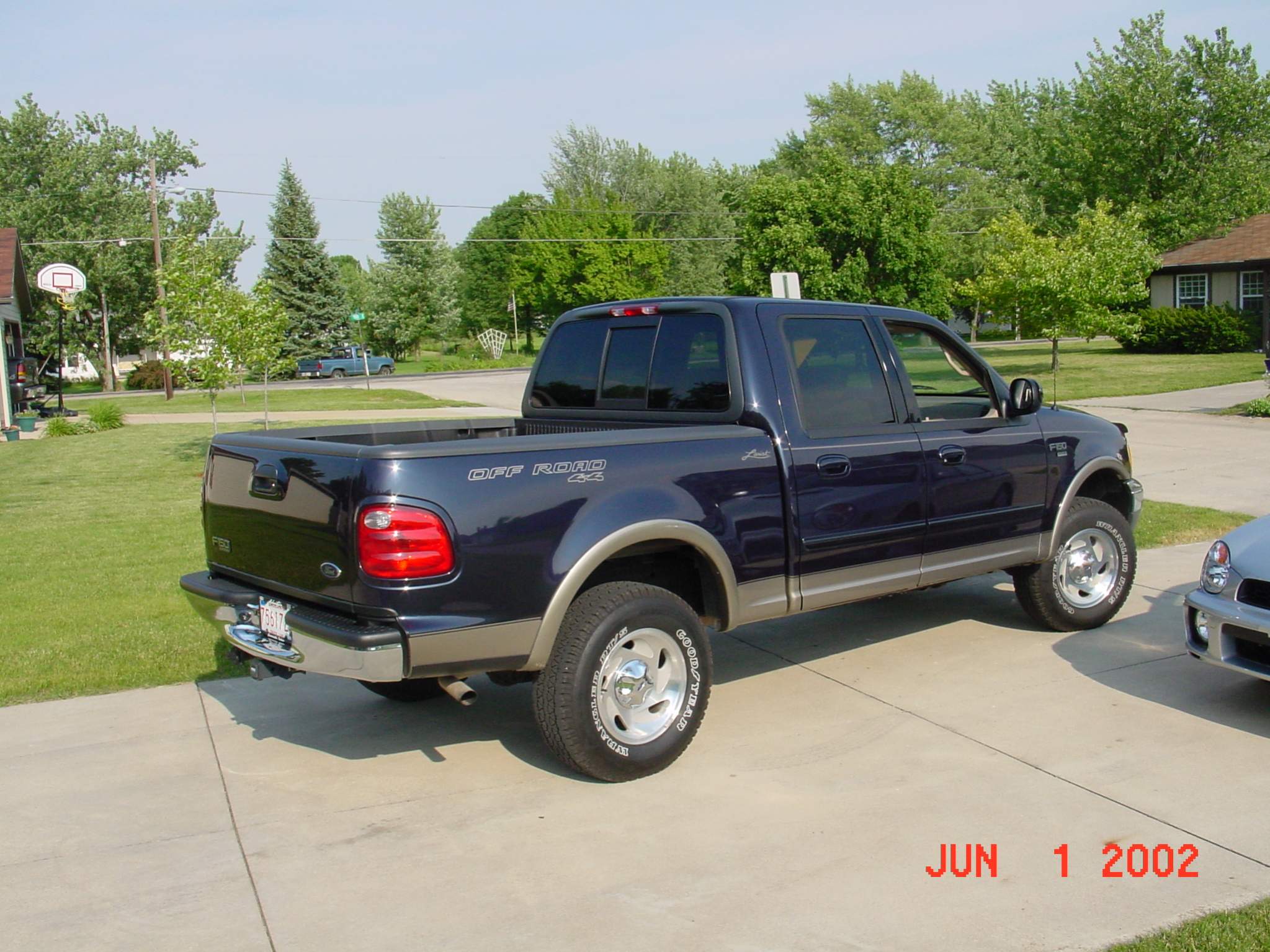

Really good advise here. I would not go as low as 4.56 Maybe 4.10???? If you are going to spend money get a WD hitch. DO NOT get a GN at this point. They weigh another 1000# or more than a similar sized bumper pull. With the WD hitch you can get more tongue weight, take it slow, and make sure everything is up to snuff. I personally do not like GN trailers. I can back a bumper pull much better and every time it seemed I needed the bed of my truck.
I pulled 10,000# for 2 years with a F-150. While it was no joy it did the job except on time in August on a 103 deg day in Tennessee Smokies. I had to use 4 Wheel Low to get up a 2 mile grade. It would simply not move in 2 wheel drive or 4 high. I had to get the gearing in my favor.
