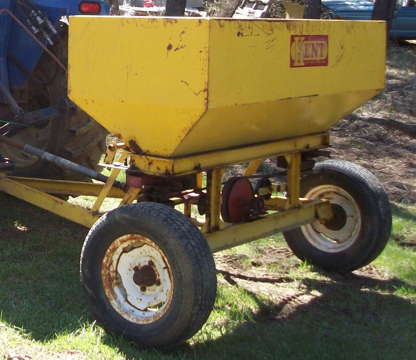

We resurrected this old Co-Op pto drive spreader built by King , I had never used one of these pto operated ones before but now that I have a little experience with this one I would recommend finding a used one.
It also easily holds about 800 lbs. of lime, worked well to spread that. The pelletized fertilizer gets thrown to far, had to put the tractor in a high gear and idle it to shorten the distance it throws the pellets. And it worked really nice for spreading seed right down to two hand fulls left... fertilizer 012.JPG might find something similar for way less than some new plastic job. my:2cents:
