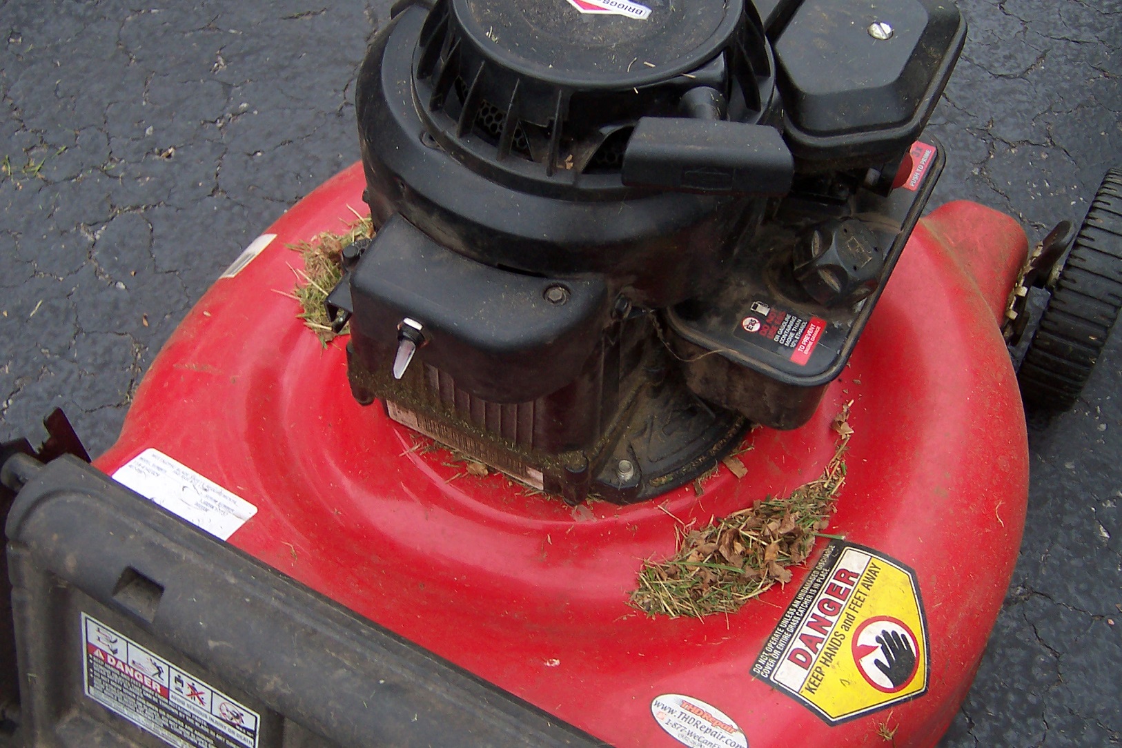

Step two was to get rid of the mower handle. Don't want to tow the mower behind my tractor with a big handle sticking up. Of course the problem with that is that the handle includes a holder for the recoil starter handle and also the lever that pulls the flywheel brake and grounds/ungrounds the coil allowing the motor to start and shut down. The recoil starter was easy. I marked the rope near the motor housing, pulled it out a couple of feet, slid the puller handle down past the mark, tied a new knot at the mark, cut off the extra rope, and pulled the rope/knot back into the handle. I figured I could live without the brake, so I drilled out the pivot that held that on and removed it. Most of the force on the lever was pulling against that brake spring. Attached to that spring arm was also the electrical connection that grounded the coil to shut the engine off. I drilled a hole in the plactic cover and installed a simple toggle switch instead. I test stated the motor and was able to shut it down using my new switch. Handle removed. Step 2 done.

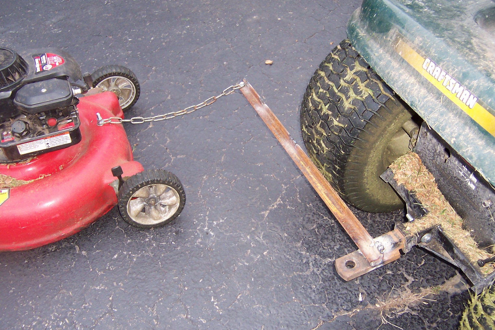

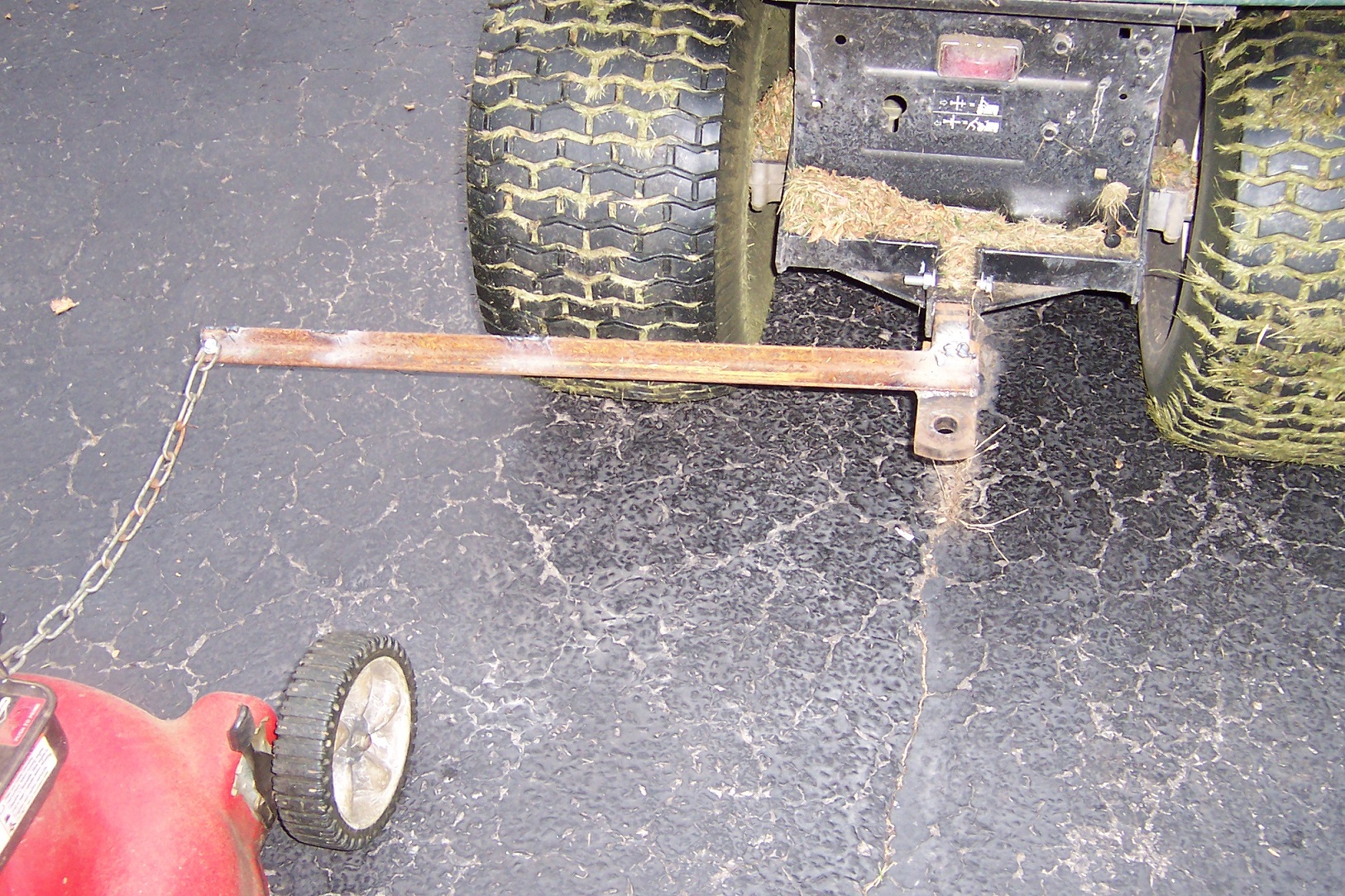

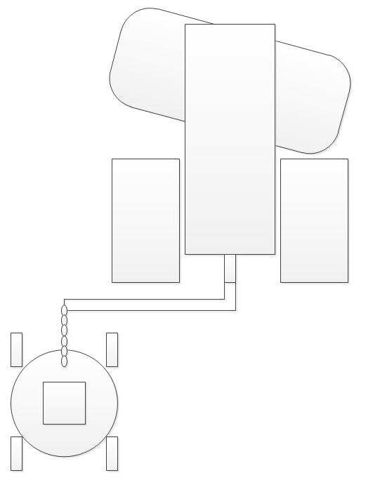

Since I had already installed a 1 1/4" receiver hitch on my tractor for another purpose, I decided to use a regular receiver ball mount to build the linkage from the tractor to the push mower. The lawn tractor already has a 42" deck, so I needed to offset the mower. My design is a simple offset bar with a small length of chain connecting the mower.
After building this, I did a test drive. Works fine on straight runs, but when the tractor turns, the 4 wheels on the push mower make it want to continue straight. The chain is attached to the offset hitch slightly above the level where it is connected to the deck, so it actually pulls up slightly and the front wheels slide to get it back on track, but it does seem to have a mind of it's own.
I have some actual pictures that I will share, but I'd like some help designing a linkage that would keep the tow mower in better control. I do want to use this along the road where there is a moderate slope. I think that gravity would have more control over the tow mower than I want...

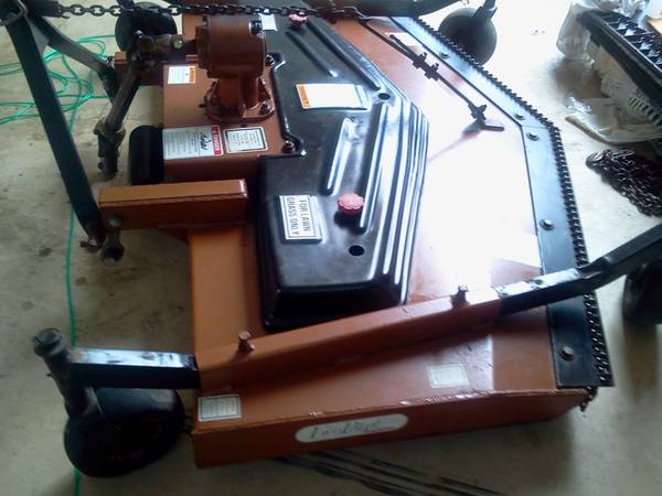

Put four swivel casters on it and add a frame across the top to support them like they do with a 3 point finish mower. 00303_5QGucA9VSXf_600x450.jpg Just a thought.

If you are going to "tow" it like a trailer(with a pivot at the back of the tractor) then the front wheels need to be swivel castors and the rear need to non-swiveling.
This will make the mower track in a straight direction when going straight. If all 4 swivel then the mower will go all over the place.
If its going to be solidly mounted at the back of the tractor, like a 3pt implement, then all 4 wheels needs to swivel to prevent the wheels from skidding.
I have a 60" swisher tow behind mower setup just like in your pic. Google "swisher mower" and you will see lots of pics/vidoes of theses mower that you can use as an example.

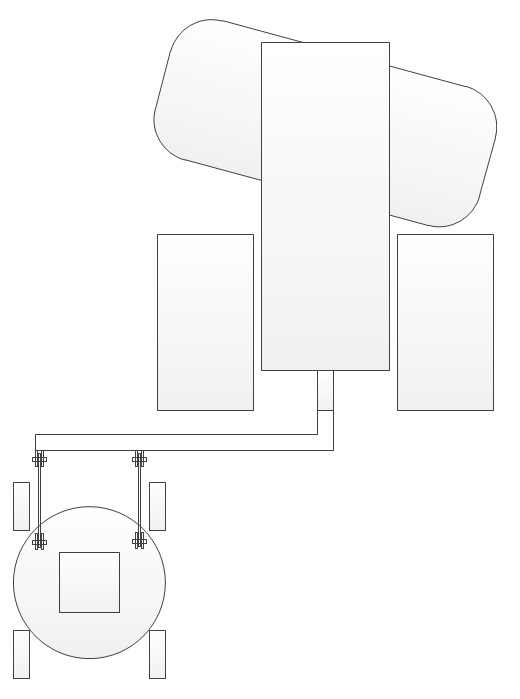

Not sure I want to change up the wheels. I did find a front caster wheel kit that bolts on in place of the stock wheels, but that's $60. There is the option to buy some casters and weld up a frame for them.
The mower is pretty light and I'm ok with the front wheels skidding around turns. Just want to keep it under control behind the tractor. I currently have a water skier back there.
I'm thinking about replacing the chain with two rigid arms. Like the chain, they would be mounted to the tractor above the mounting point on the mower deck, so pulling forward would also have a slight upward pull. Any resistance from the ground while turning, would result in a lift and pull force. That would help the front wheels get around. The rear ones continue to drag along. No problem there.
More thoughts?

/ Tow Behind Mower #6
Use a single arm ridgidly mounted to the mower, piviot mounted to the arm on the tractor. Ditch the front wheels on the mower.

I have one of the Swishers also - you already weld, it shouldn't be too tricky to dupe the front casters. Check out the pix here
Swisher Finish Cut Tow-Behind Mower with Electric Start — 540cc Briggs & Stratton Engine, 66in. Deck, Model# FC2066BS | Trail Mowers| Northern Tool + Equipment
Bit of square or rectangular tube, couple pieces of nesting pipe, some flat bar (welded, unless you have a plasma and a fairly heavy bending setup) - drill a couple holes, done... Steve

As promised, here are some pics of the actual setup. I was planning to weld the chain to the cross bar and weld up a quick bracket on the mower deck, but ran out of wire so I had to bolt things up for now.
The small plastic cover on the back is where the flywheel brake and cut-off switch were. Pulled them both and added my own toggle to shut off the motor.
