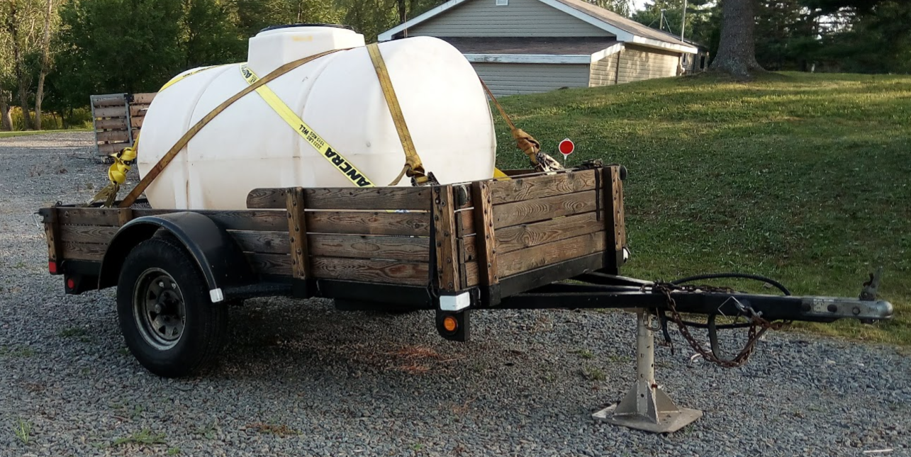

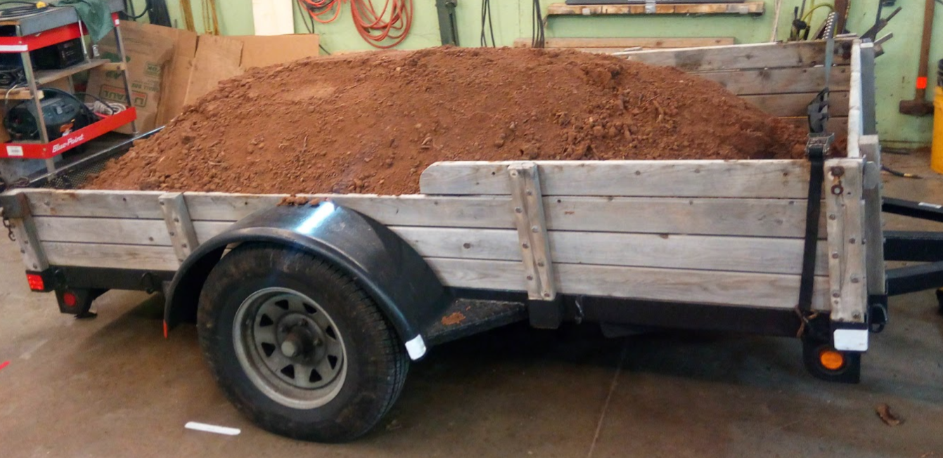

I've got a trailer I haul a 1100L water tank on for my daughter for the past 5 years or so, 3500LB torquflex axles, trailer weighs all that when loaded and I've had it overloaded with soil a couple times (the pic of the soil is with the lighter axles under, over a yd of damp topsoil) .

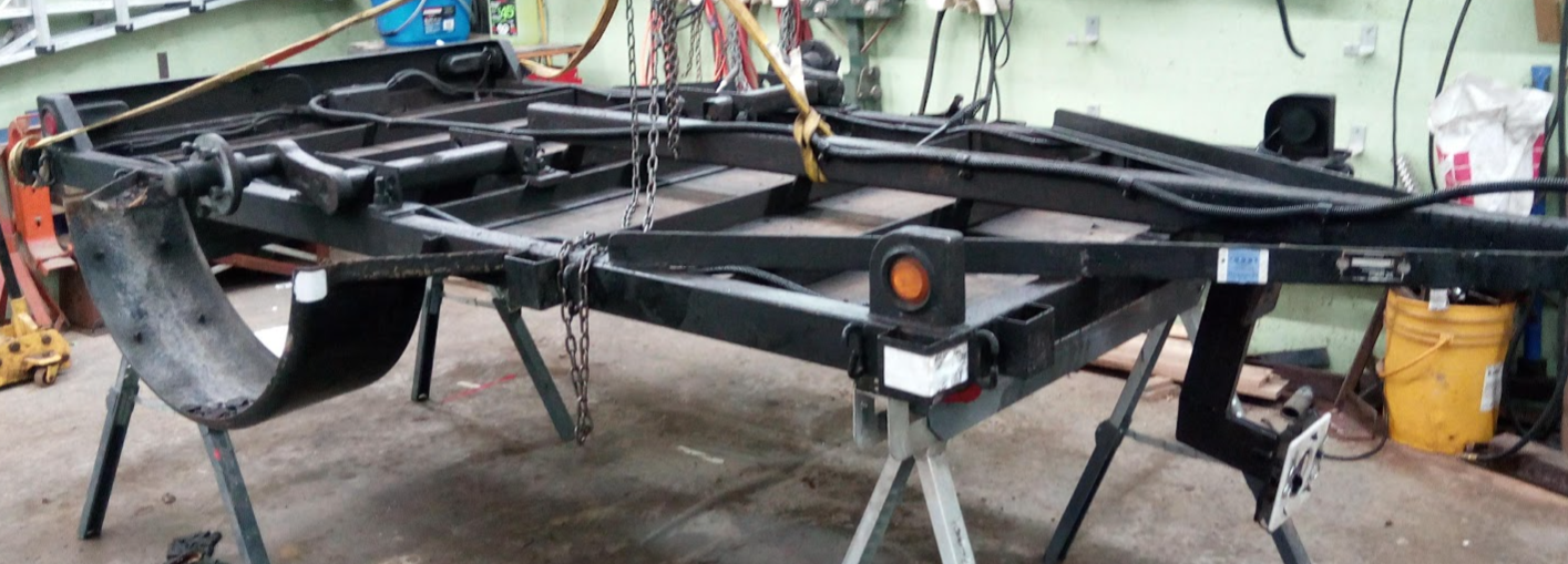

Initially had 2500LB torqueflex axles under it and worked great but I was getting a bit antsy re the overload so I changed them to the 3500LB. It's all on pavement but around here the roads are the $hits being full of potholes and wallows. Pic is when I was changing the suspension.
Never had a lick of problems with the originals or the heavier ones. They never took on a permanent sag or any sign of problem. The lighter ones I had on for 8 or so years and the heavier ones for the past 4 or so.
As for bounce, I built an identical trailer for the SIN using a 2500LB leaf spring axle. Empty it's like a rabbit jumping all over the place, loaded not as bad but still bouncy. Mine, it'll bounce a couple times empty or full and stop. I'd never build a trailer again using leaf springs.
