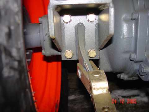

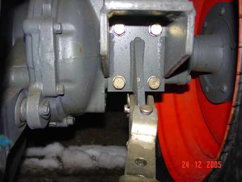

All I can find in my JD4300 (my2000) about these three holes for the top link is this:
- For light and medium draft loads: install center link in lower hole (B) of mounting bracket.
- For medium and heavy draft loads: install center link in middle hole (C) of mounting bracket.
- For very heavy draft loads: install center link in upper hole (D) of mounting braket.
Which I have never understood.. first, what exactly is a "draft load"? Second, what happened to hole (A)? /forums/images/graemlins/smile.gif I have three.. labeled B through D. /forums/images/graemlins/confused.gif
I leave mine in the middle position, figuring I won't be off by too much if I err in the wrong direction! /forums/images/graemlins/smile.gif
Why not just always leave it in the position for heavy loads? I don't see much difference in terms of lift height.. although I haven't measured it.
I would like to know the answer to this one also. The tractor place could provide no insight.
Addendum: I just called the JD dealer.. and he says he just always leaves his in the middle hole and has never had a problem. I said, but, why not always leave it in the hole for the strongest position. He said he had no idea.. the manuals tell you what to do but not why. Hey, they're honest. /forums/images/graemlins/grin.gif
Addendum 2: The tractor dealer told me that a "draft load" simply means pulling, as opposed to raising.
