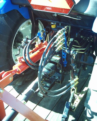

   / toplink cylinder #26
3RRL - here's the only photo I have of the T&T setup from Little Tractor. Sorry but I don't know anythign about their supplier. I do know that I had to have them put RO's in both as they cycled way too fast w/o them.
   / toplink cylinder #27
The tilt cylinder looks exactly like the one I got from Integrated Engineering. It looks like they have some of the now defunct IE's leftover inventory.
   / toplink cylinder #28
Thanks for posting the photo.
It looks to me the DPOCV are similar in size to the ones used by CCM. I wonder if they are from the same manufacturer? I sent them an email asking if they had any for sale. Hope to hear back from them and I'll let you know.

   / toplink cylinder #32
You're right Mad, the cylinder does look like one from IE.
Jim McCuan, of Integrated Engineering, lived very close to Little Tractor and James Little. He also bought a tractor from them. It's not suprising to me that it seems to have a powder coat finish. Jim had access to that at Midwest. Here's a picture of the demo's on a Kioti at Louisville in 2004. They look the same except for different color and an different end on the tilt cylinder, which just unscrewed.
