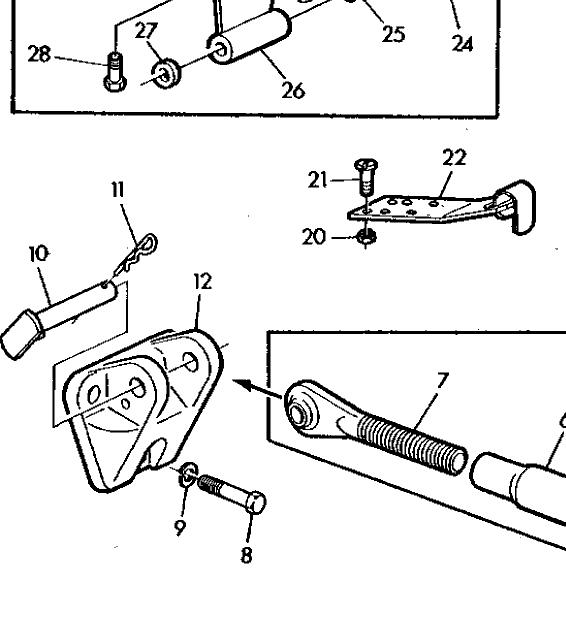

Is this the bracket? Seems if it is, there are some mating surfaces that are getting in the way to cause it to break. Or, what implement is being used? Maybe a subsoiler?

using a tree spade 44 " BaumaLight with a 3 point adapter. The first bracket broke I believe when I went over a bump too fast and the tree spade may have drug on the ground, that is my theory anyway. Changed that bracket out with a spare one that I had here (which is a whole other story about non standard JD toplinks). But I reused the bolts that were out of the broken one.
The second one, a bolt broke off and the TL bracket self destructed very shortly thereafter. So we are thinking the bolt may have been stressed during the first incident. At least that is my thoughts right now. But I can't help but wonder if one of the bolts were not tight enough and caused the TL bracket to flex (which cast does not do well).
The bracket shown in the pic is the one I have (had).

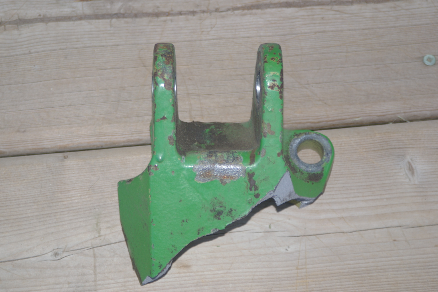

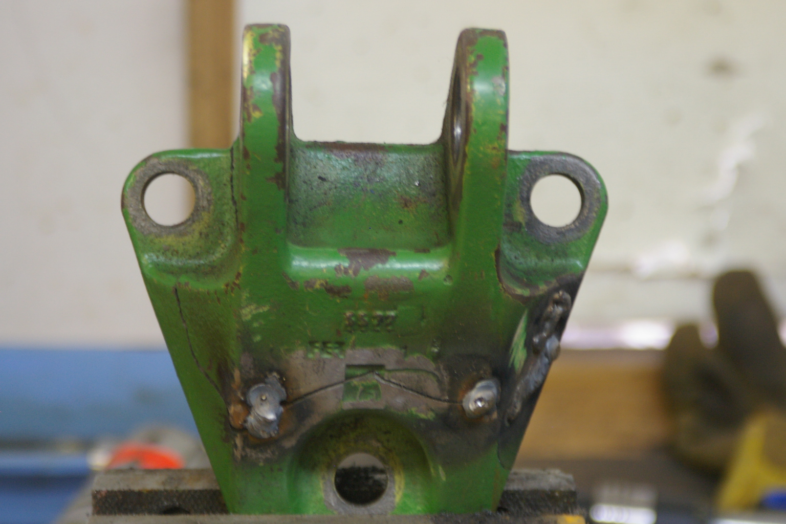

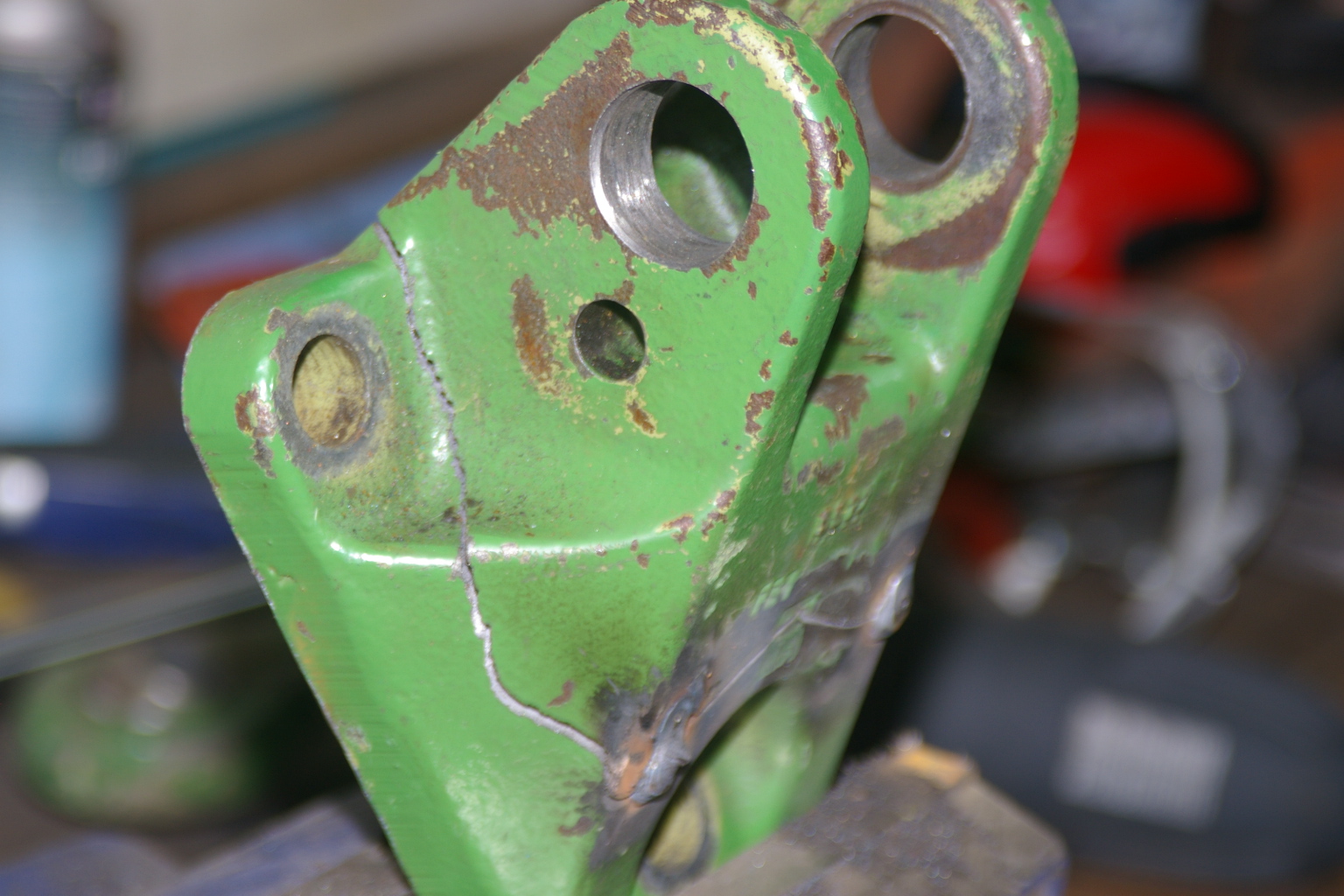

here are some pics. The first 3 are of the bracket that I drilled out to 1". Ignor the welding, I was just playing to see what happens when you try to weld cast.

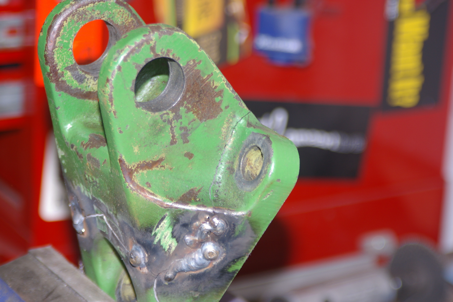

The forth pic is from my original bracket that I also broke after the new one broke. Not to sure where the rest of the parts are for that one right now (may be in the bush somewhere). As I recall there may have been a touch of rage going on after the 2nd one broke.
Neither of the brackets broke where the pins go. The first one just blew out. The second one looks like a bolt broke and the bracket busted up after that. I had reused the bolts from the first one and suspect that they may have been weekended or had hairline cracks.
Any idea's whats going on here?

My idea is you are using an attachment that needs a category II tractor ahead of it.

Goodness. I have broke one of those on a holland in my 35 plus years.. I was mad at first (it was my miss use). But then when I figured a 60 dollars bracket was way better than a torn out upper casting, I am happy. I hope mine tears out before it does more damage. Like someone said the weak link. I would prefer to call it a shear pin.
