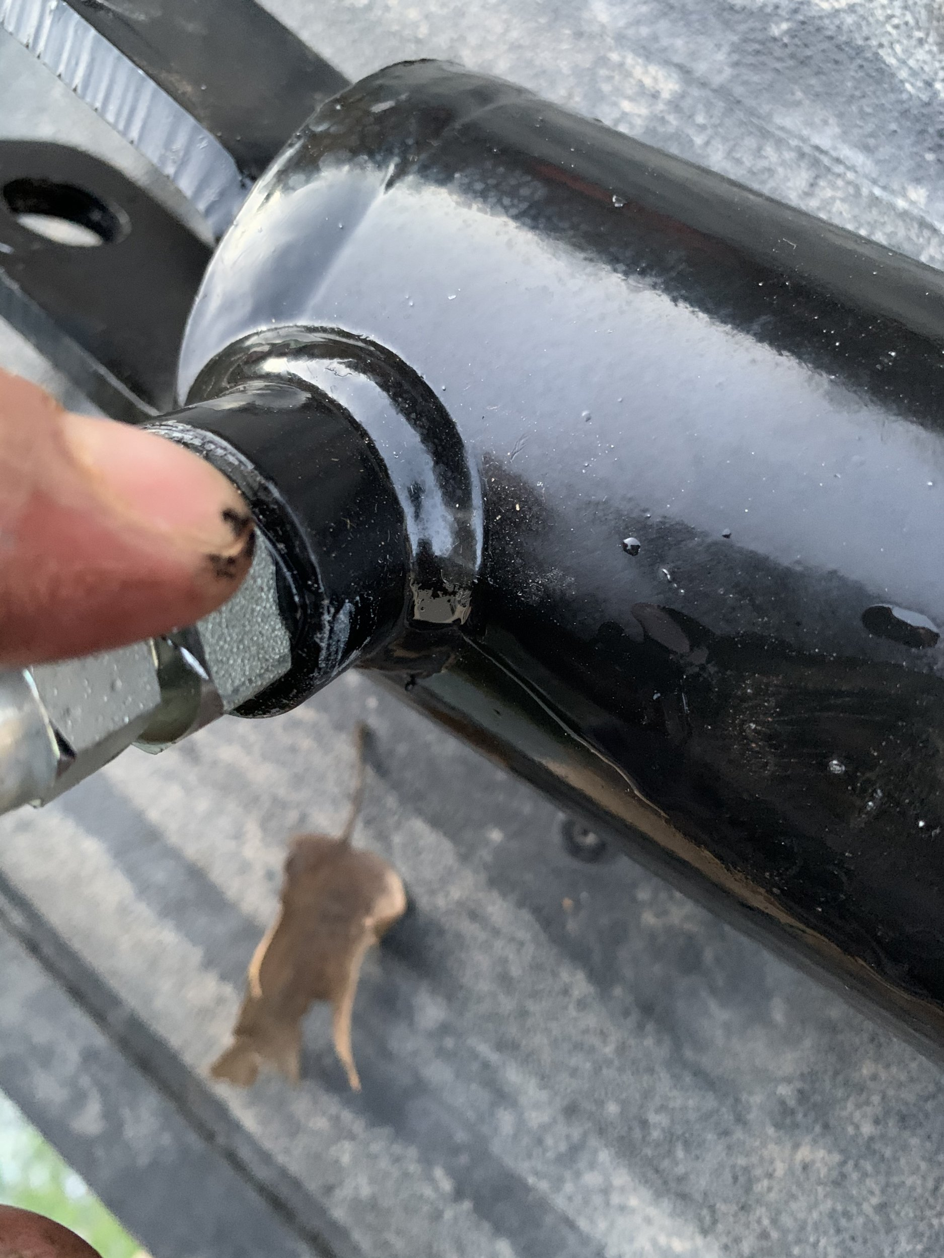

Hey guys,
I just picked up a hydraulic tnt from my kioti dealer. A few issues, but my main concern is side link travel. Is it normal for the hydraulic piston, when fully collapsed to be about 4” longer than the shortest possible length of the manual side link?
The other issues I’ve had:
—Where the side link connects to the lift arm(not the lower passive arm, but the shorter upper arm) the ‘fork’ was too spread out to get a pin in the factory stud. I fixed that with some all-thread and an impact. The factory distance is 1-1/4”.
—One of the hydraulic fittings had a pinched o ring and was bleeding quite a bit. I have just about every size of o ring on hand plus Teflon tape, so that was a simple fix.
—The supplied top link cylinder “universal joint” is too wide by just a smidge to fit into the factory mount. I can fix that as well, but I want to contact the dealer in the morning before I remove material for it to fit.
AGAIN... my main question is: for those of you who have installed hydraulic top and tilts, is it typical for the side link to be longer fully collapsed than the factory side link? Is the fix to used the adjustable side link on the other side? In other words, when fully collapsed, the hydraulic side link is longer than the fixed link, so it’ll never be flat or be capable of tilting in the opposite direction where the adjustable side can go higher than the fixed side...
If this is the case, it’ll pose issues for me for obvious reasons ie fine grading with my box blade. Not to mention, it won’t be able to lift my Woodmaxx chipper high enough to navigate rough terrain in the back wood lot.
Thanks, Jeremy

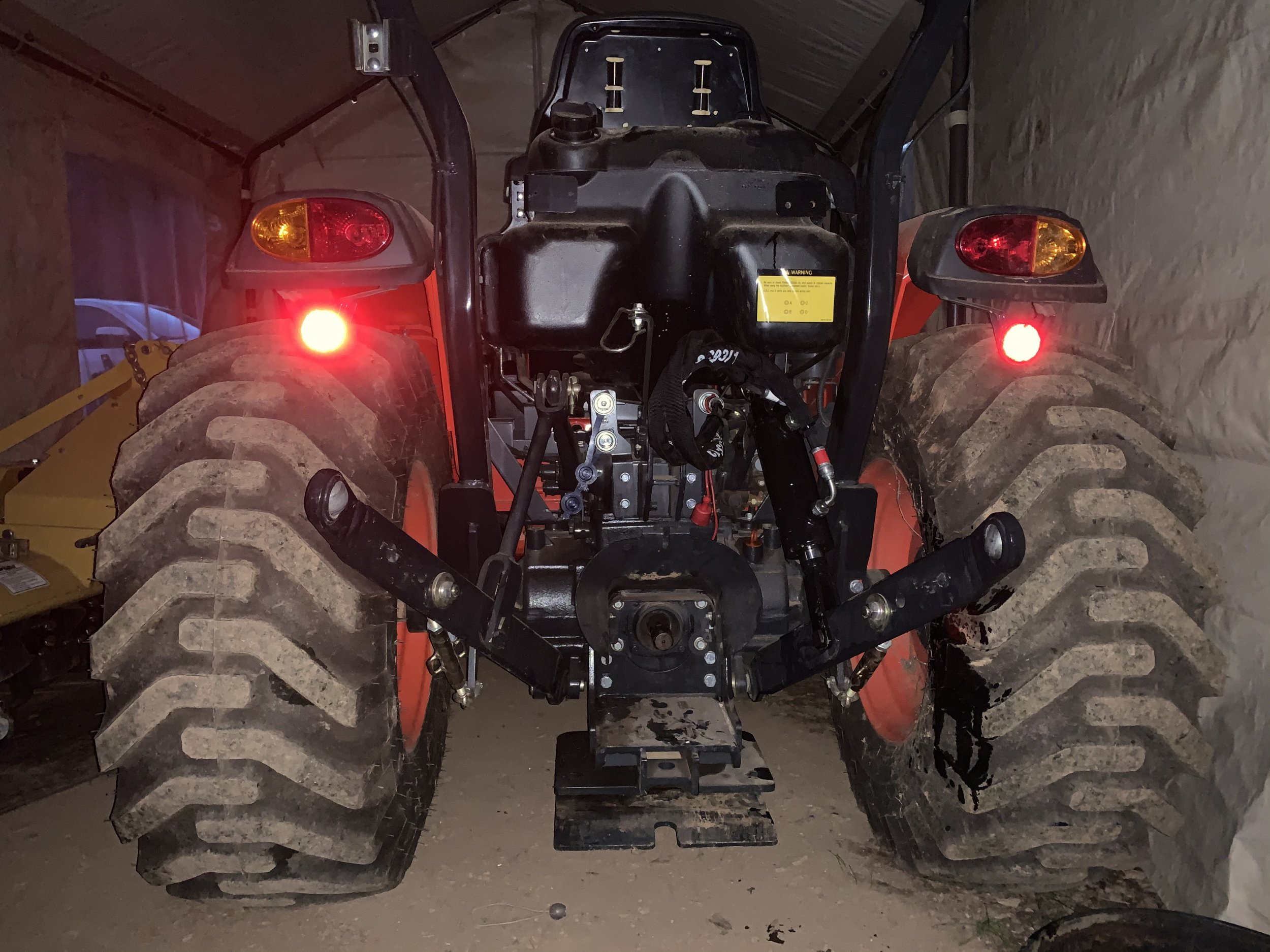

Sorry for the dark shots, I’ll try to get better ones in the morning.

My thought - you do not have the correct hydraulic cylinder on the side link. That plus your other problems says the dealer simply gave you the wrong hydraulic cylinder. Everything should fit - no need to modify ANYTHING.
Take the unit back and get the correct one.
/ Top n Tilt questions #4
I agree. If it came from your dealer, I'd be taking it back. They should know what fits and what doesn't. Sounds like they just threw something together.
When I was putting together my T-n-T, I tried to size the tilt cylinder about 4" shorter than the other side and have enough travel to extend 4" longer. So an 8" cylinder with necessary "filler" would be my goal. As it turn's out, I'm having to make my own tilt cylinder. I couldn't find one off the shelf. (At the price I wanted to pay.) :cool:
/ Top n Tilt questions #5
Agree about the dealer issue. Otherwise, try replacing the fixed length side link with the adjustable length link you must have taken off for the cylinder. It's handy for range of motion even if your dealer fixes this issue.

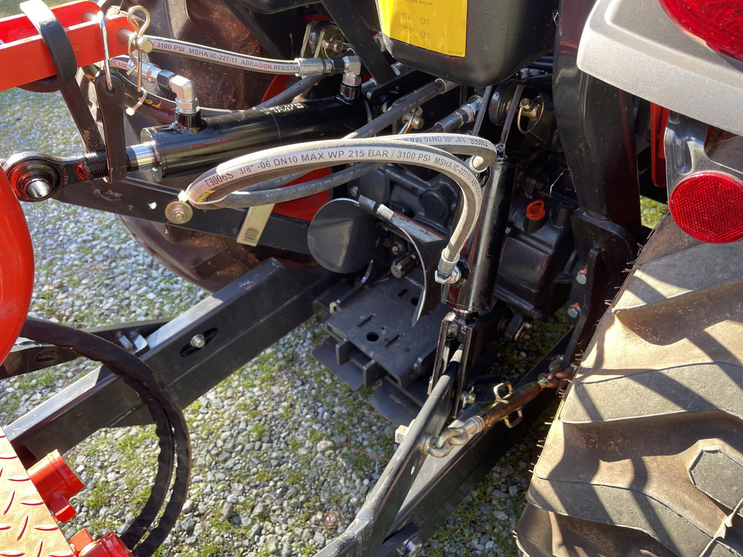

Just to close this out, because I just now installed another tnt. I went to a different kioti dealer to have one built. Picture of said assembly while adjusting hose angles. I have a .pdf that I created for the dealer with all pertinent measurements if anyone out there with a CK wants it.
/ Top n Tilt questions #13
As recommended by others on TBN, instead of a hydraulic link on one side and the OEM fixed length link on the opposite side, I replaced the OEM fixed length with the OEM adjustable link for extra tilt when it's occasionally necessary. Can't see which was used in the picture but it kinda looks like the fixed link.
#14
It’s the adjustable. That was also recommended by the kioti dealer mechanic.

To build the side link to be able to adjust an equal amount to the left & right sides like the OEM adjustable link and maintain the OEM lift heights, you need a 3" stroke cylinder.
/ Top n Tilt questions #17
With the (3") stroke extended to the mid point...the LOA should be the same as the solid side link...IMO...!
/ Top n Tilt questions #18
Exactly. CK10 series links are very short. There is not a lot of adjustment even with the manual adjustable link.
