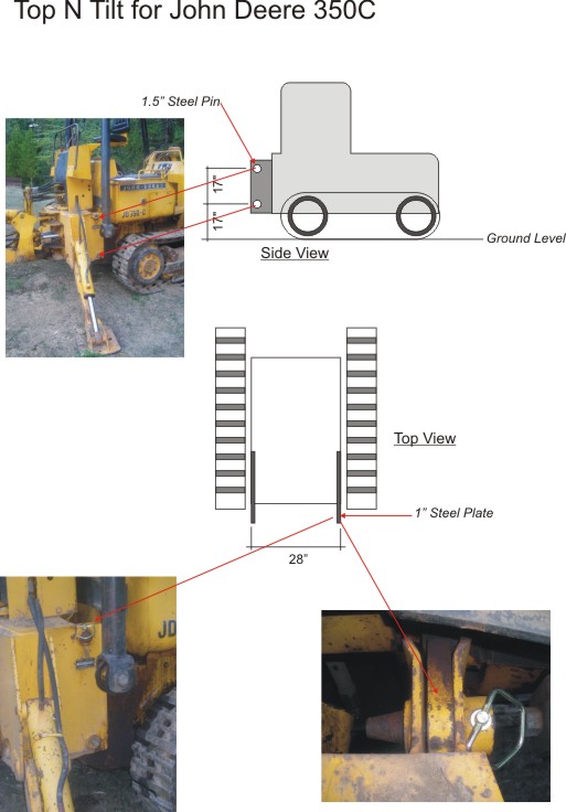

Hi all,
I wish to put a industrial Gannon box with hydraulic rippers on my John Deere 350C dozer.
I would like to do so with minimal pain, and not reinvent the wheel so to speak, There are many post for the tractors but I have not seen any for the dozer's. The 350 is set up with hydraulic lines with quick connects at the rear for the backhoe shown in the attached files. Any advice and or recommendations would be appreciated, thanks Scott
  • 350C TnT1.pdf

You can plumb a new joystick valve to operate your TnT cylinders just like the tractor guys do...you will have to verify whether your system is OC (open center) or CC (closed center), the max PSI and GPM specs also need to be know to properly match the new valve.

I would probably make a upside down U shaped frame that goes onto the 4 points that the backhoe hooks onto.
I would have the pins that go into the lower holes on the bracket also hold on the ends of the two lower links
At the top of the U shaped frame, I would weld one of these on each side Weld on Ball Ends.
Then I would put a hydraulic ram on each side going from the welded end to the lower links (to lift the implement and run the tilt part).
I would put a relief valve and a possibly a check valve (after the relief valve) on each of the cylinders so that you don't break anything.
Finally, I would install a ram with swivels on each end at the top of the U frame.
This would be controlled with either a 3 spool valve or a 1 spool valve and a 2 spool valve. one spool for each side and the last spool for the top and all hoses going to the hoses would be 3/8 or less.

My backhoe is the 9550 model as I think you are aware and has the same 1" lines as yours. I also have the 4 in 1 bucket with no spare plumbing . You are right about option 2 being tight for space. Probably pursue option 1 but use 1 spool for the left lift arm, 1 spool for the right lift arm, 1 spool for the top link, and a 4th spool for the hydraulic rippers built into the Gannon box. Visibility on mine isn't to bad and I need to work on slopes.
Akwelder- they did make a fortory 3pt to fit the "quick attach" on the 350 but are very rare and do not have the hydraulic top or tilt. The ripper will fit directly into my machine using the "quick attach"
Kennyd- I believe normally open, with 2 hose, 1 pressure and 1 return
this picture that Farmerford linked

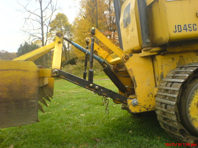

is identical to my "quick attach" The 3pt has hydraulic lift and manual top link , what I think I want to do is to put a cylinder at each arm (1 left and 1 right) anchoring the top of these cylinders at the top hole of the "quick attach" and have 1 cylinder for the top link? that way I will have lift and tilt? least thats the theory but have no need to learn the hard way so any wisdom you fellows could share is greatly appreciated, thanks again Scott

Your plan sounds good to me with one question. As I understand it the lift arm cylinders will provide both lift for the box blade (when both cylinders are activated) and tilt (when only one cylinder is activated). Does that mean you must manually rebalance the cylinders each time you lift or lower the blade? Unless the two cylinders travel at exactly the same speed, won't some tilt get added or subtracted each time you raise or lower the blade?
But if you instead built a rockshaft (like the picture) and had one cylinder move the rockshaft for raise and lower, and a second cylinder as a connecting link between the rockshaft and one lower arm, you would adjust the relative positions of the lower arms (tilt) with that second cylinder and then the tilt would not be disturbed each time you raised and lowered the blade.

Hi Frank, finished it last fall, what a learning experience, no more know about hydraulics, John Deere plumbing, and fabricating than I intended. I will post some pictures soon. It is a great addition to the dozer allowing the finish grading I needed to do. I picked up a back blade and am looking for a rake. Also wish to use a hydraulic auger off the backhoe. We are swamped at work so will not be able to post untill next weedend at the earliest, Scott
