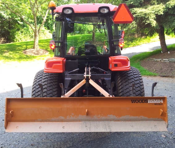

[snip]Considering the Cat 2 capability, I consider the fender clearance a design error on Kioti's part which, after-the-fact also explained to me why every competitor mounts their rear fenders more forward than Kioti for increased three-point clearance. The picture below shows the clearance issue: the Quick Hitch is wider than the fenders and since the fenders stick way out in back, repeated beatings will chip away the rear fender extensions.
Yes, good advice. Your photo really shows the problem. If Kioti still has not improved the fender clearance on the newer NX5510 and NX6010 models, they should turn to it, IMO. There are a lot of CUT owners using that style of QH on their tractors, like me. So if their CUT's 3pt set up is both Cat 1 & 2, they logically would choose a Cat 2 QH. In the case of Kioti NX5510 and NX6010 owners, my guess is there are more than a few cracked rear fenders out there. :eek:
Even with my Cat 1 3pt set up on the NX4510, there is only a small amount of clearance when the hitch is raised and the toplink fully retracted. This pic shows it. BTW, in the photo, the depth of field produces a distorted sense of dimension. The 84" box blade looks wider than the rear tread width. In fact, the big Titan turfs are 83", sidewall to sidewall. But the width of the QH top frame and levers accurately appear as barely clearing the rear fenders, which they do.

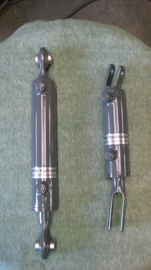

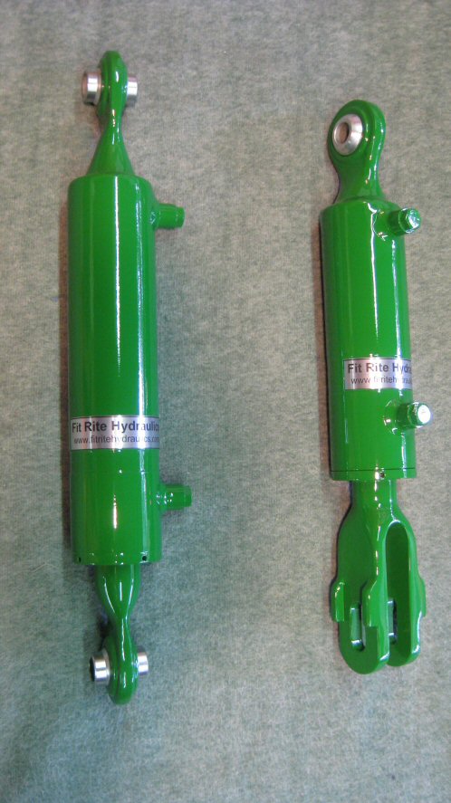

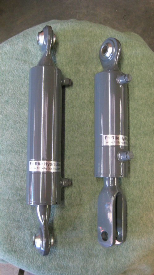

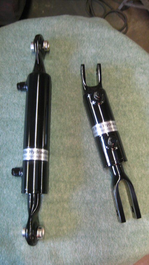

Fit & finish. My units are not off the shelf units. Every unit is built by me to fit YOUR tractor, no matter if you have an 18 HP sub compact or a 660 HP AG tractor.
I do my best to provide the optimum working length possible for each and every tractor be it a top or side link. Yes off the shelf units work, sometimes the same as mine. But the majority of the time, the working lengths that are available with off the shelf products just work and do not provide the ideal amount of adjustment in both the retracted and extended directions.
Pictures are examples of various top & tilt sets built with 2", 2 1/2" & 3" dia cylinders for Kubota, Kioti, John Deere, New Holland. ;)
