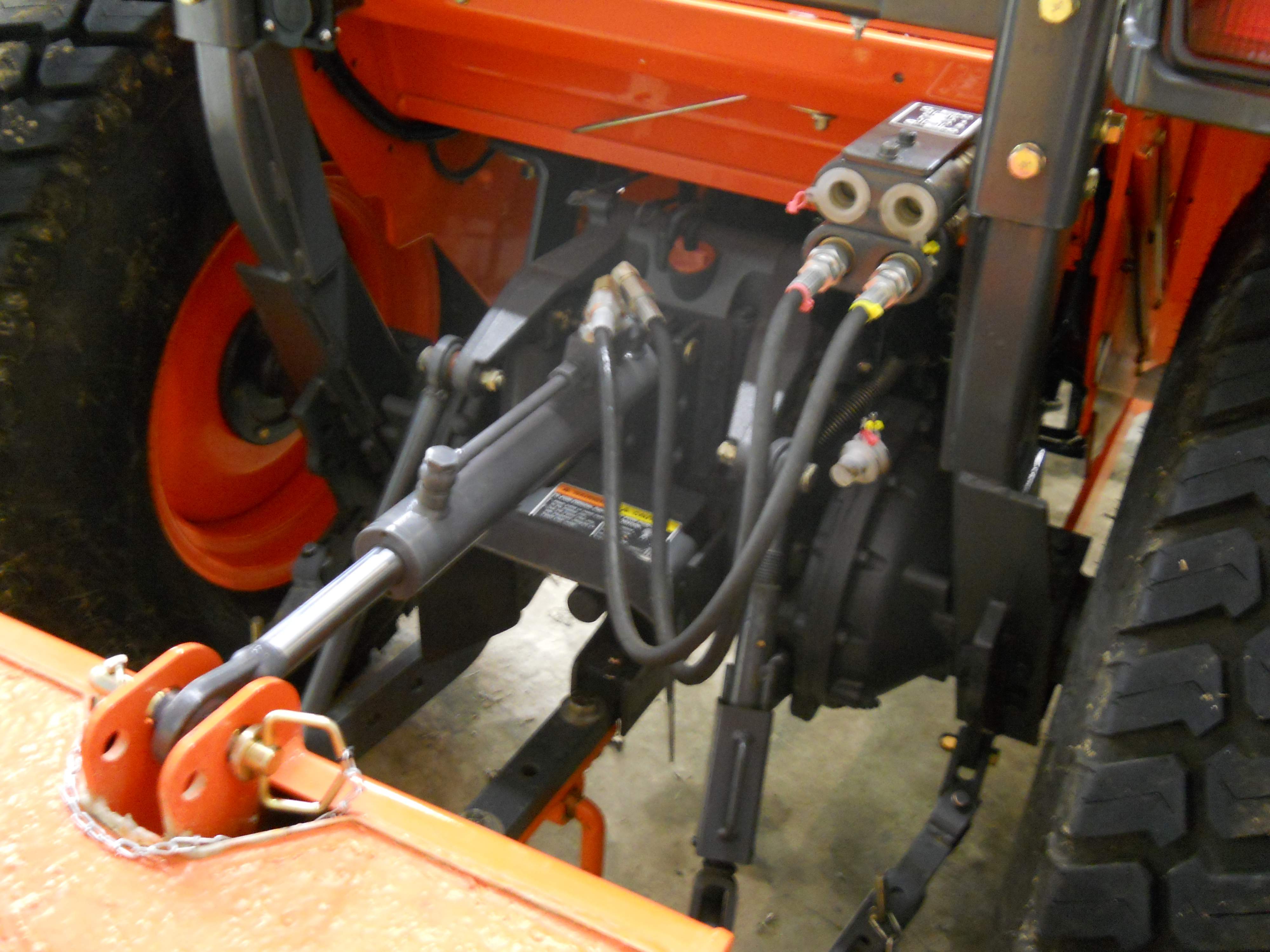

I suggest this top link. Easy to adjust, even on the move. Makes hooking up implements a breeze. Never had a problem with it rusting up on me. Philip.

I have one and it's pretty good but I don't think it has the full range of motion that the original top link has.
I find it harder to hook up implements since I cannot reach the control and guide it and adjust it at the same time. With my tractor, I have to walk around to get to the control. Hook up is a PITA.
And, of course, it requires an available hydraulic connection and is a LOT more expensive than even the Kubota replacement.

My oem top ling was 21"-34", and my hydraulic top link is 21"-32", so no big deal here. I can reach my remote controls while hooking up implements, so it is even easier for me compared to the threaded link. I do like the option of being able to retract and extend as the job requires on the move. Cost, yes, it does cost, but I think it is worth the money. Philip.
