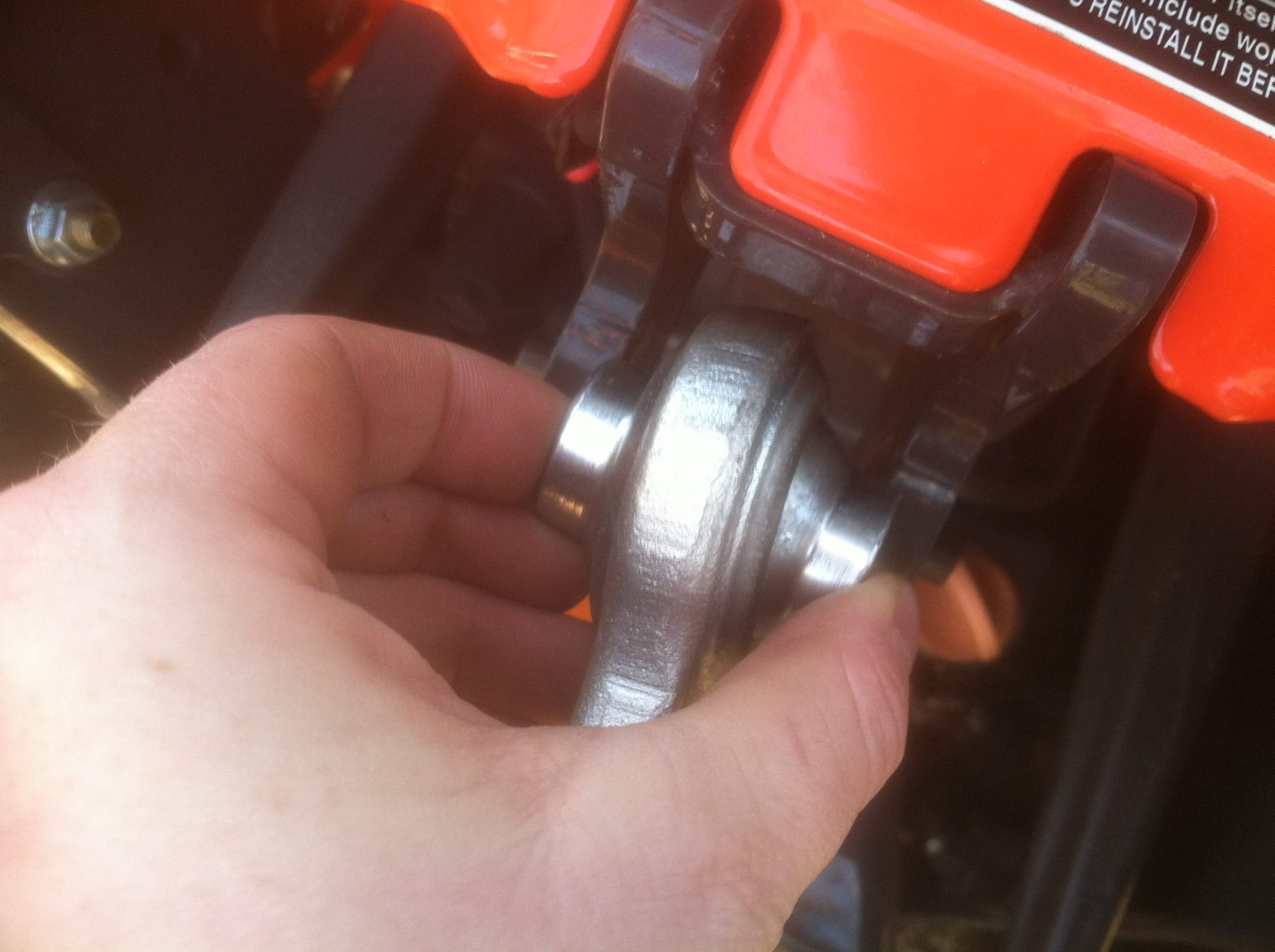

Got my Tisco JSA1009 today. Fits like a glove, seems heavy duty 蔓very happy for.. $24.00
/ Top Link replacement #28
SN,
When not using the top link take it off or hang it on the hook. If you leave it down, it will unscrew, and you will only have the top half.:mad: I am on my 2nd Tisco JSA1009 because of this.:smiley_aafz:
#29
You know I did notice that it will unscrew easy. Very timely advice!
