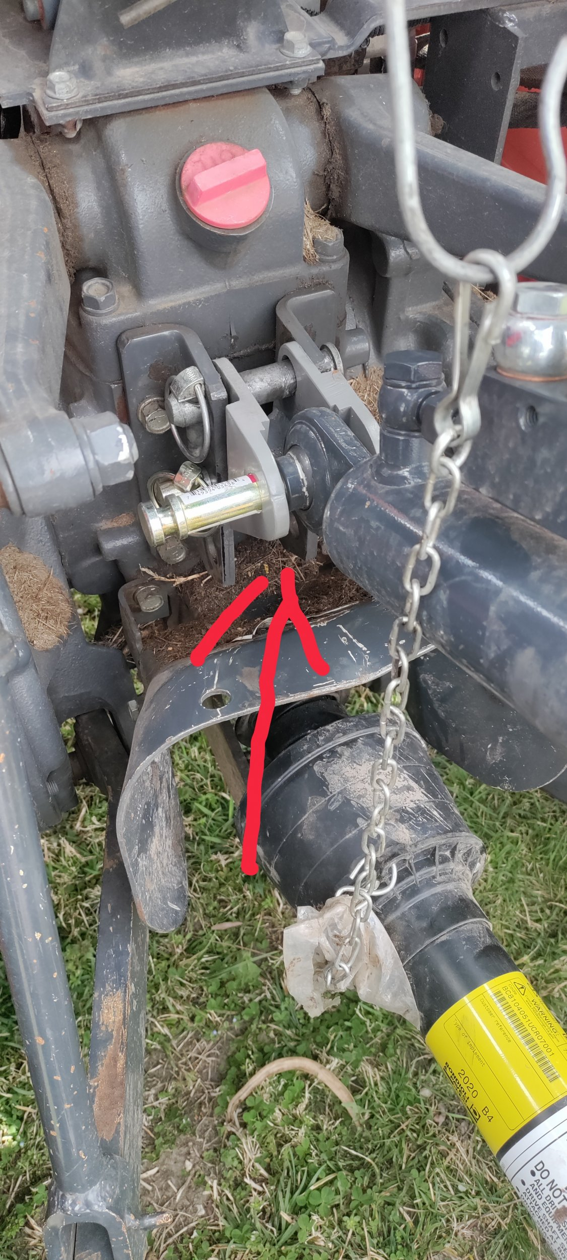

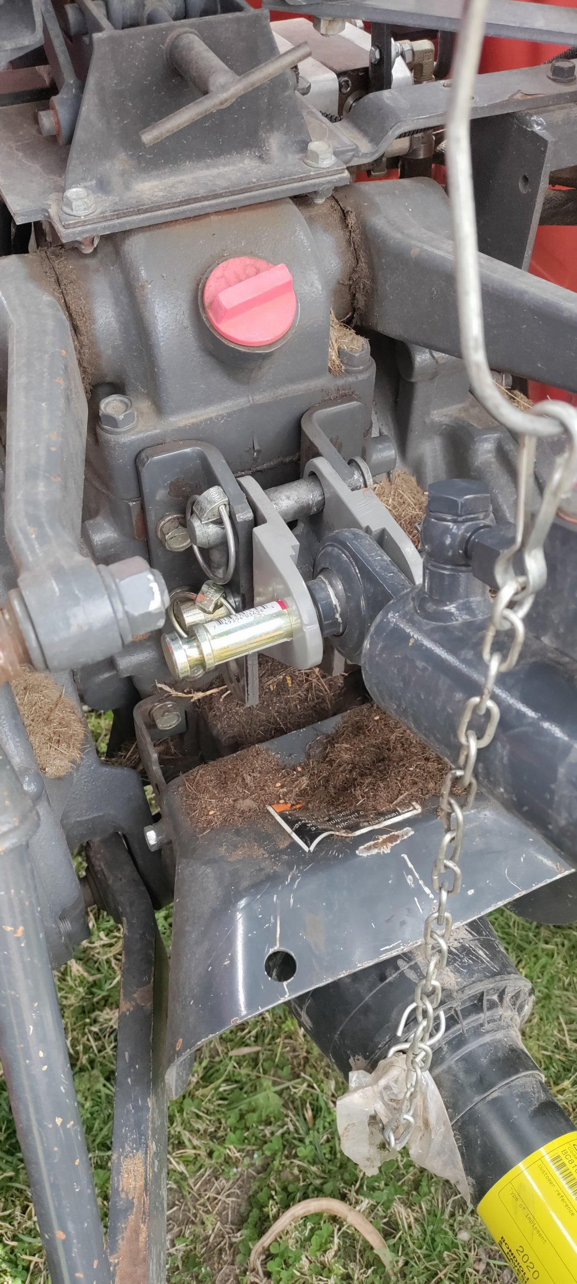

I had the issue with my hydraulic top link being to short. Lucky I'm a maintenance technician and have access to a shop with milling equipment. This is what I came up with.

That takes care of the overall length being too short. Does not change the range of motion in/out of the hyd top link. I assume you have as much range as you need ?
   / Top link extension on the tractor. #64
Far as I can tell the range of travel is okay. The worst one was a rake I modified for the last tractor.
Anyway the fix today is pin-on so it can be removed if needed. And I can move it up or down and flip it over for different heights.
