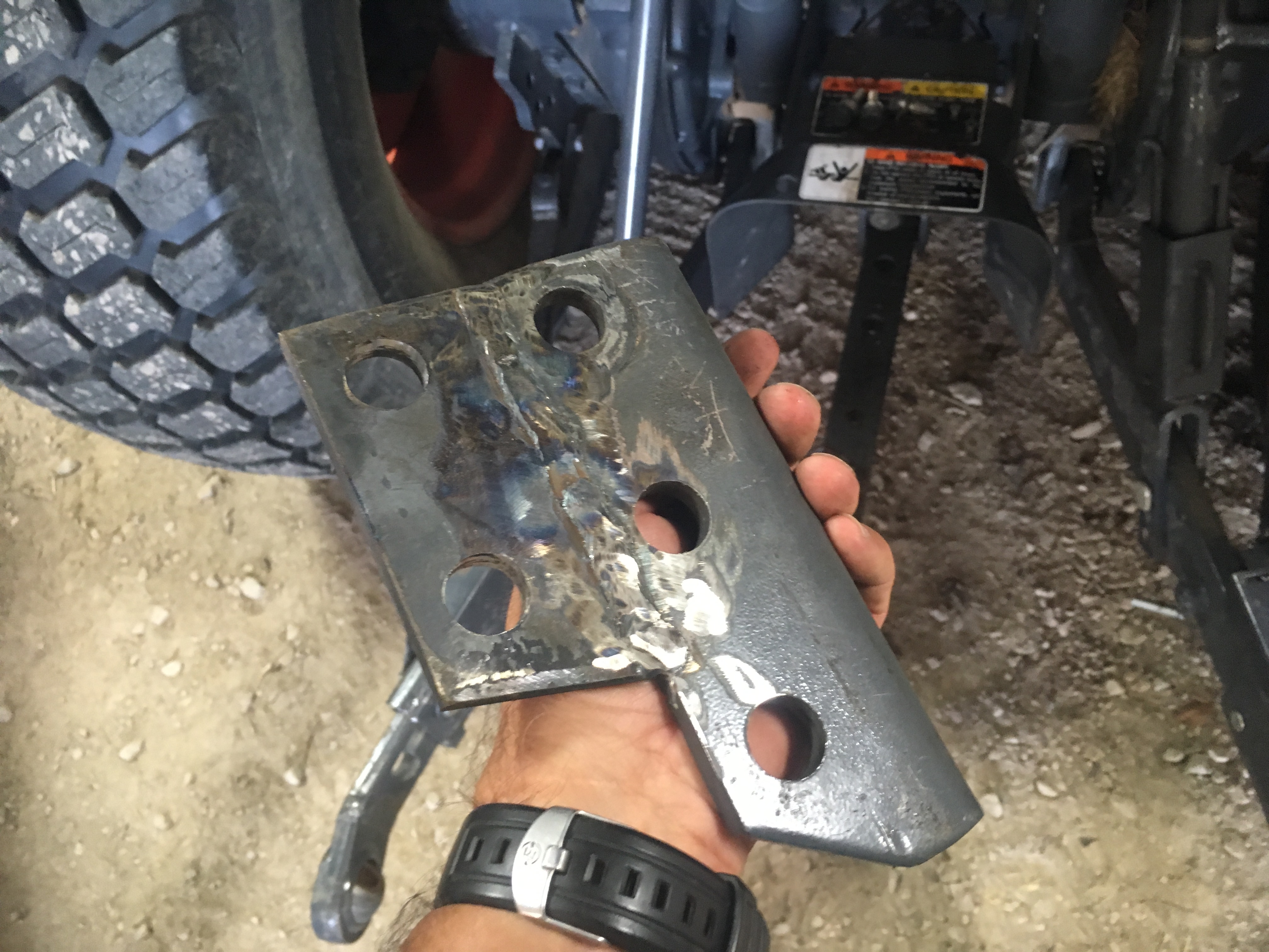

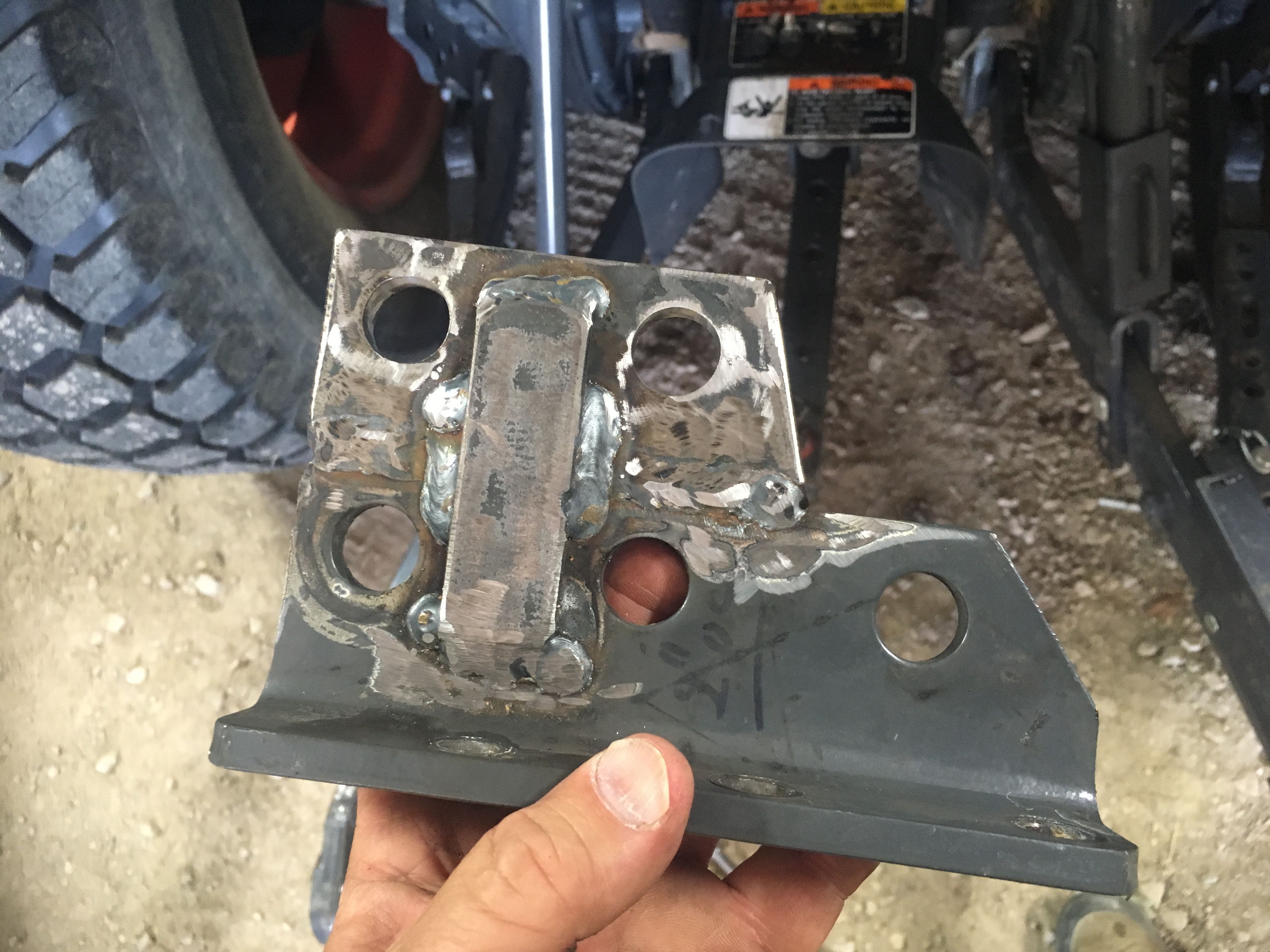

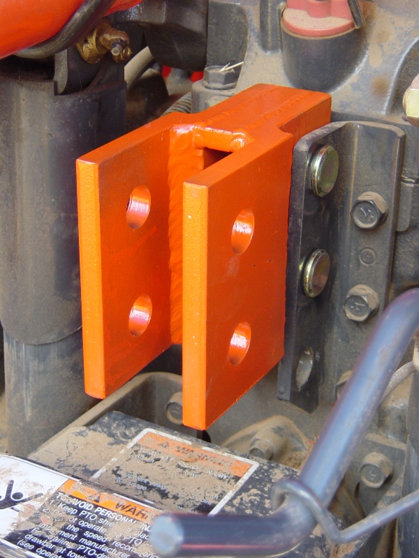

On both my L5740 and my L6060, I have had problems with my top link being too short. I have a hydraulic top link, and it is the same length as the top link that came with the tractor when fully extended.
Today, I took the brackets off of the tractor where the top link connects to the tractor and had a welder add some extensions. This seems to have solved the problem. I put one implement on and it seems to work much better now. The back side of the implement can now rest on the ground as it should.
Does anyone else have trouble with the top link being too short? I never had this issue on my New Holland. Maybe my bottom links are longer???
View attachment 554857View attachment 554858

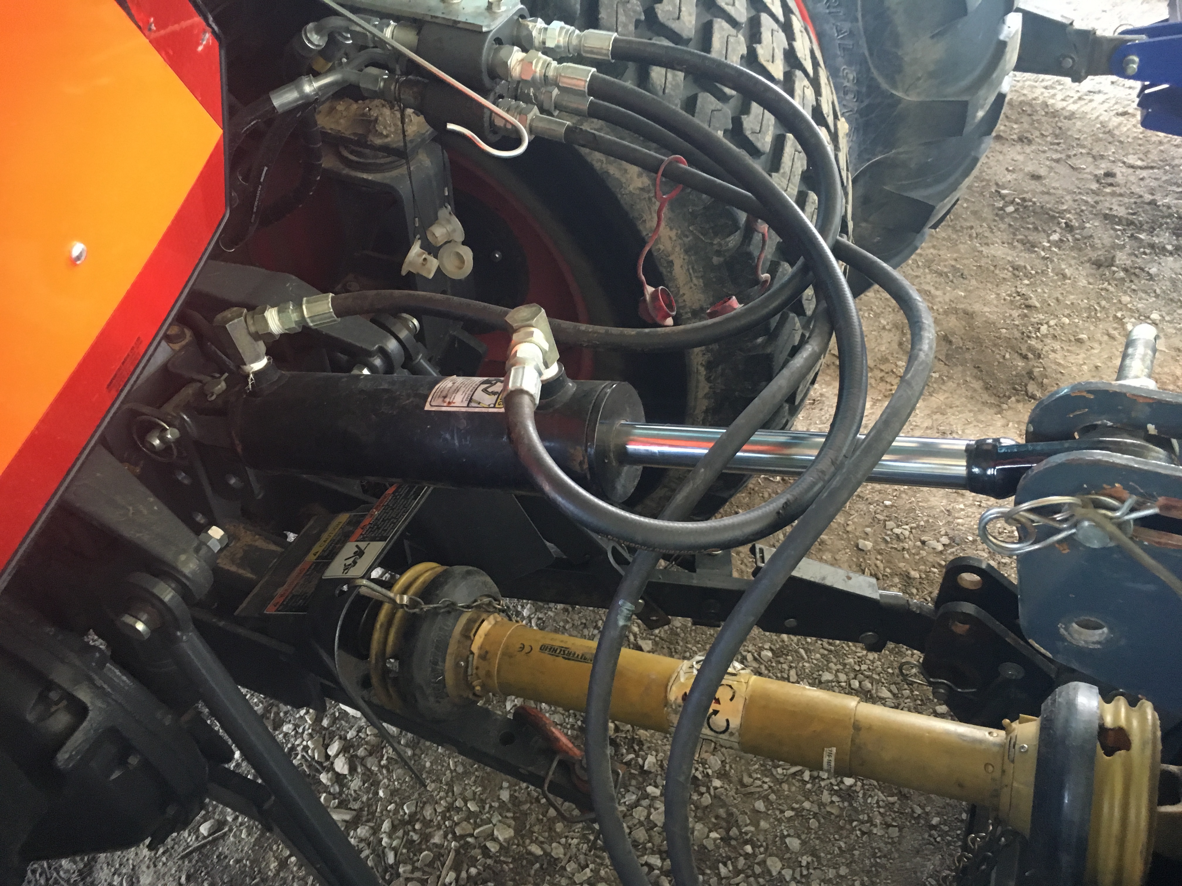

View attachment 554859View attachment 554860View attachment 554861View attachment 554862
It looks like you have a top link with an 8" stroke. There are many different stroke top links available as well as overall working lengths. It is not a one size fits all type of thing.
For your models of tractor I typically supply a 12" stroke unit having a working length of 23 1/4"- 35 1/4". This seems to work well for the cat 1-2 L series tractors as well as the MX series machines.

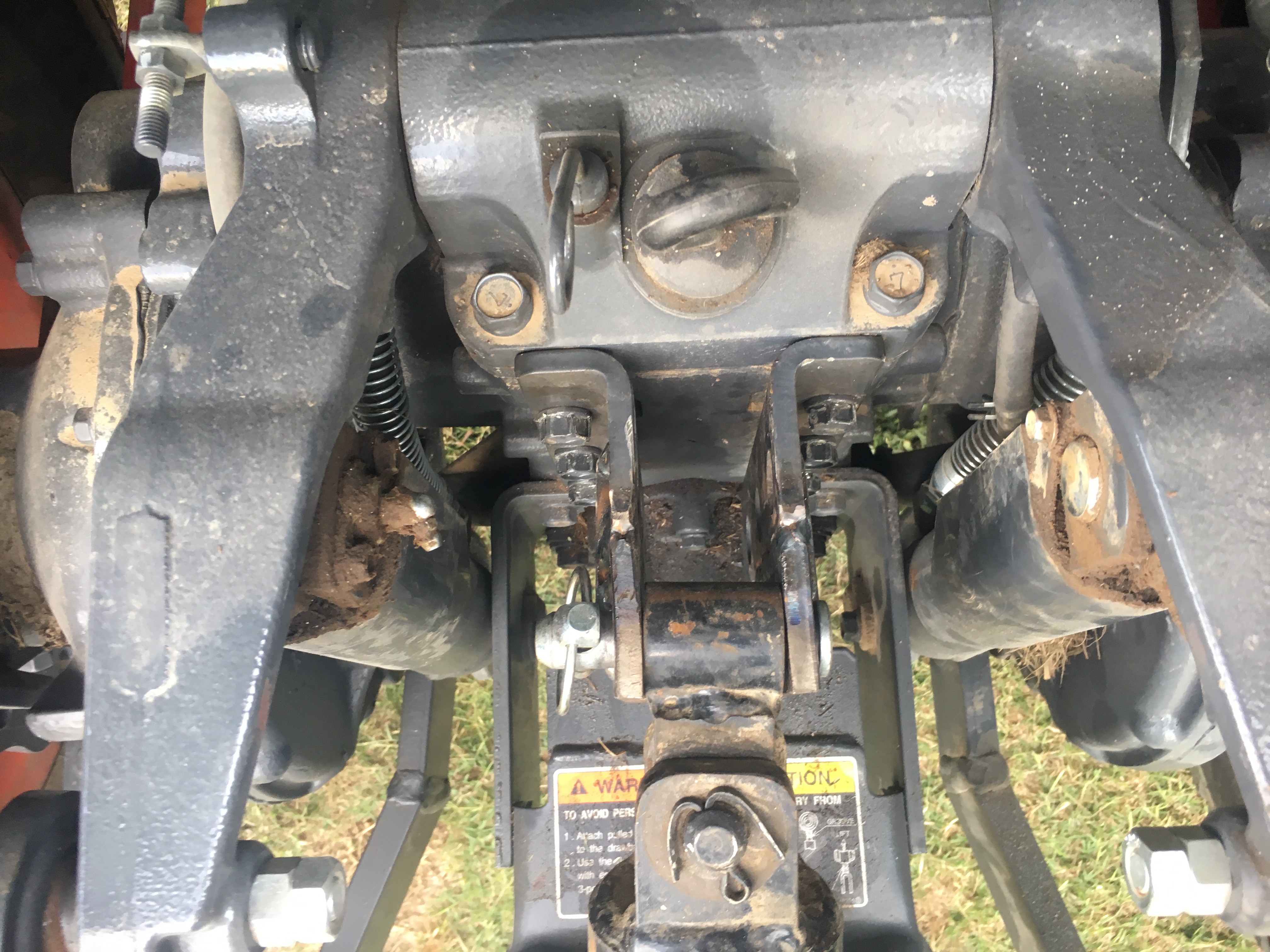

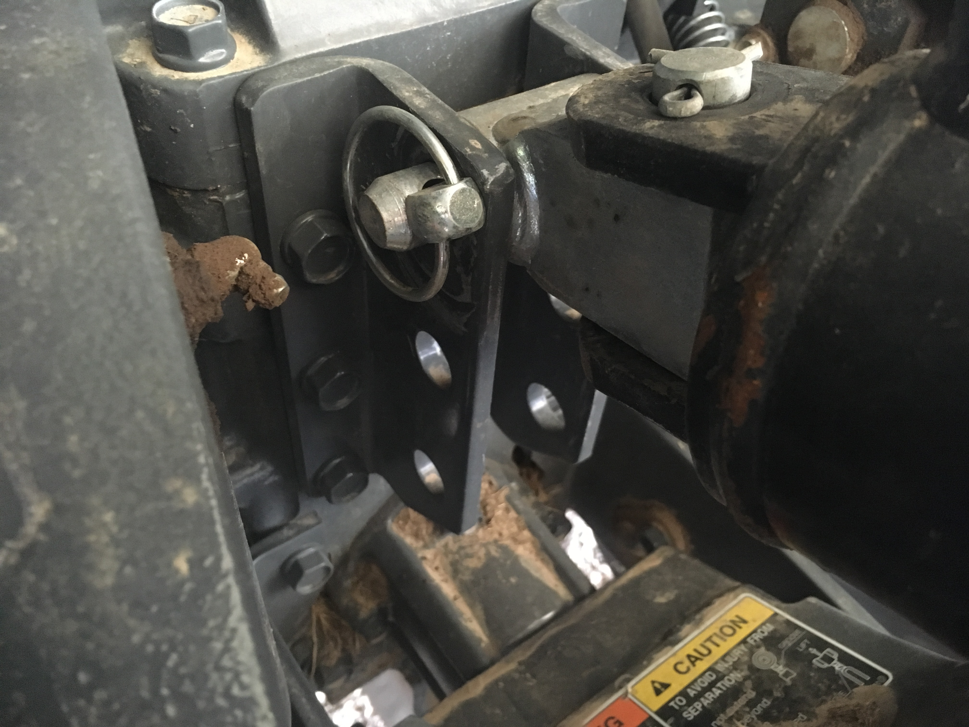

/ Top link extension on the tractor. #11
This is the one I plan to copy: extender 002.JPG
It was mentioned that he chose not to have the 3rd hole as he thought it might interfere with his PTO cover.
I suspect that, were one to need the lower hole, this could simply be moved down, leaving the top hole uncovered.
I hope this works as well as I expect.

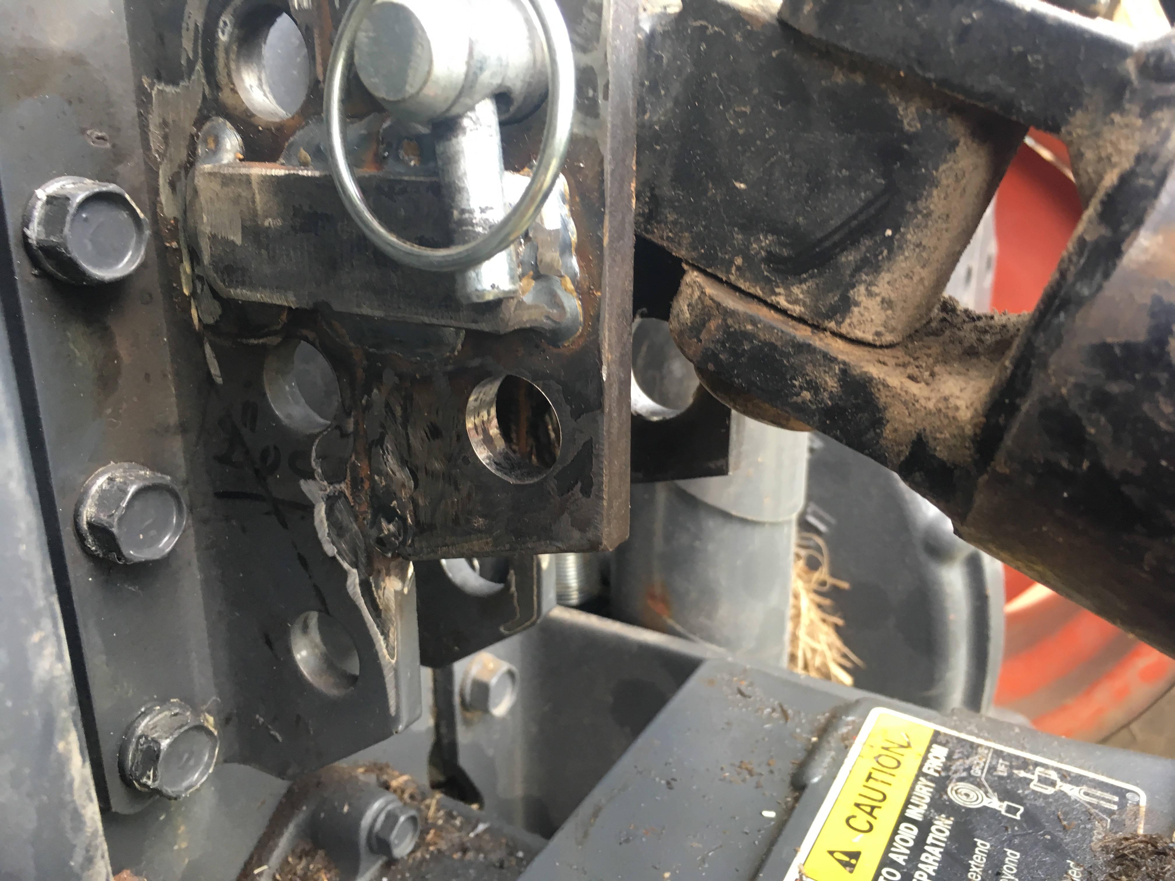

/ Top link extension on the tractor. #12
Spray some paint on the new welds or they will quickly start rusting.
/ Top link extension on the tractor. #13
This is the one I plan to copy: View attachment 554898
The advantage in using this method is you can remove it if you need a shorter top link.
If it were me, I'd cut the bottom corners off the bracket to give more clearance for the PTO cover. I'd also paint it Kubota gray instead of orange. :)
